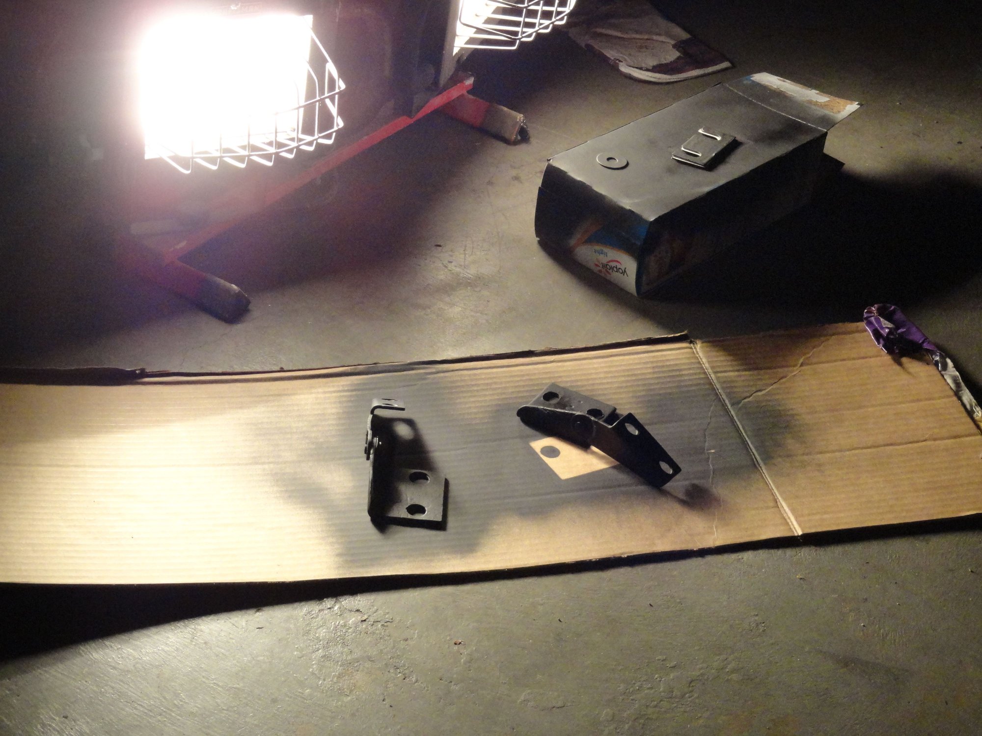

If you look at the picture with the hood hinges painted, look at the box with parts that look like an "m" or a "3" and those are the shims. The shims go under the hinge when installed. I painted mine to blend in more.
