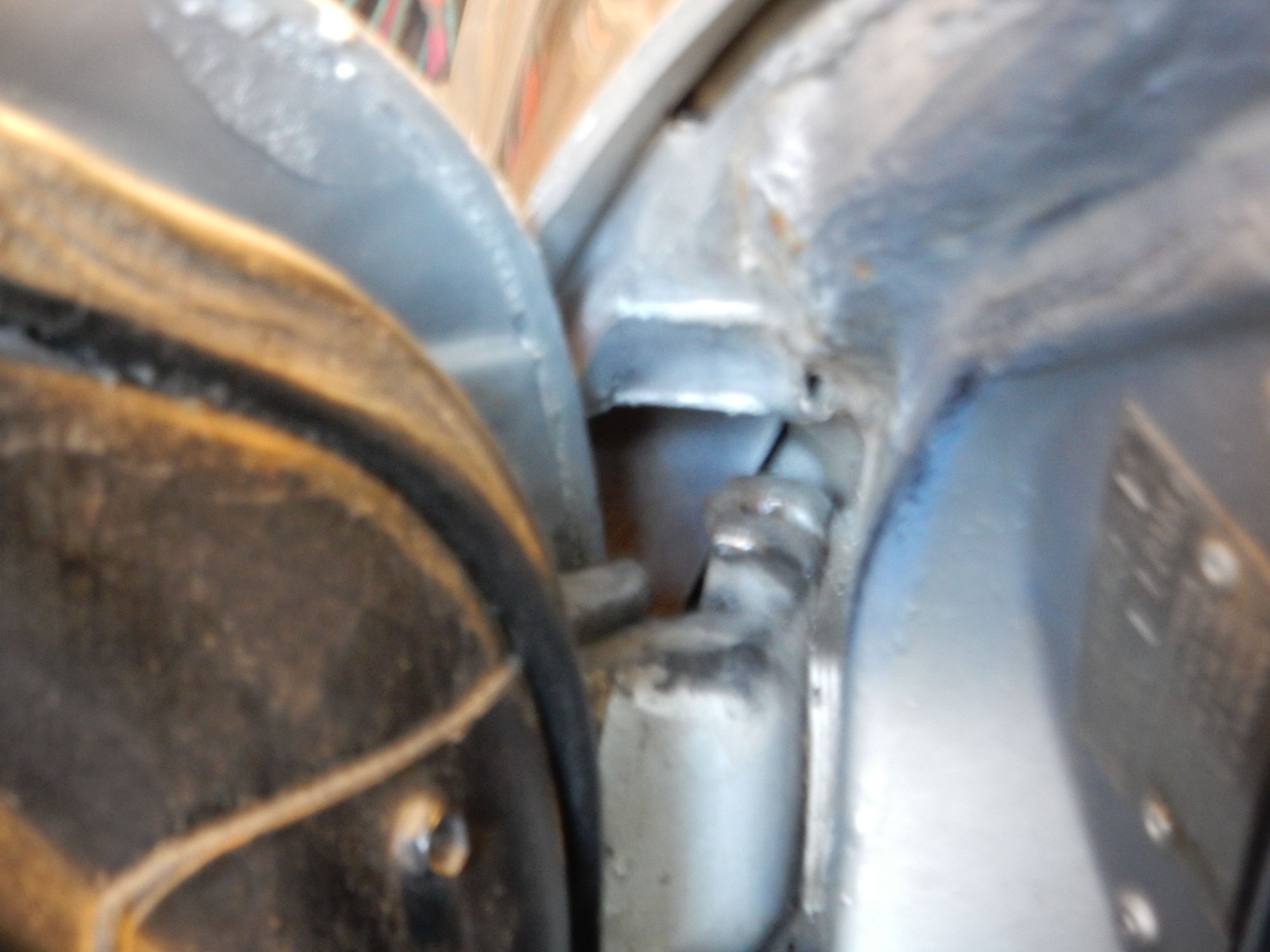

I managed to fiddle with it (a lot) and got the rest of the spring out. I took a pic after it came out of course, and it's blurry. Somewhere I suppose there is a kid that can get it in 5 seconds
If you know what you are looking at, the area above the hole for the spring is what was blocking it's removal until I found one angle that gave me ~2mm of room using extra long needle nose pliers to manipulate it. I guess that's a ton of clearance by vette standards

I don't think that piece of metal that was in your way is on my '74 or '76 and it doesn't look like it's there in the first video that was posted. I don't know if they added it by '79 or maybe Bubba did some work on your car.
I was thinking the same thing, but my son had the vette last night, so I couldn't verify (mine's a 79 also)....

Just checked mine - it's the same as Tonak's photo, and the spring IS almost touching the area right above the spring. I'm guessing that when I put it in, it didn't drop straight down, but instead was angled, and then straightened after it was inserted into the hole, and then slid into the upper notch in the hinge. Anyway, I remember spending at least an hour watching videos on how to insert the spring, but it only took about 5 minutes to actually install it....
