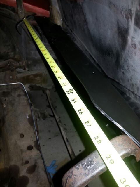

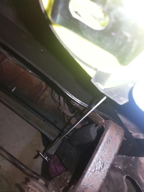

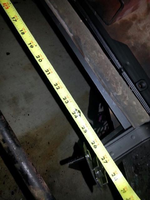

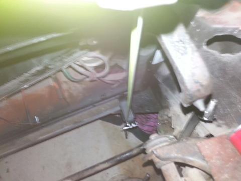

Here are some pics that i took. I'm kind of at a loss right now with all these half *** parts I'm getting. I got the radiator support from Davies. The only vendor that has actually sent me good stuff is Eckler's. If you're in Austin and have metal work skills I would appreciate your help.

I think the top right bolt on bracket is wrong. I think you have this
http://www.parts123.com/corvettecent...50g&ukey=13894
and you should have this
http://www.parts123.com/corvettecent...50g&ukey=13893

I bought a radiator from y'all put it in one time fit like a glove. Plus purchased correct bracket as stated once again correct fix!!! Thanks Tom you've earned a solid supporter.
-Dan
