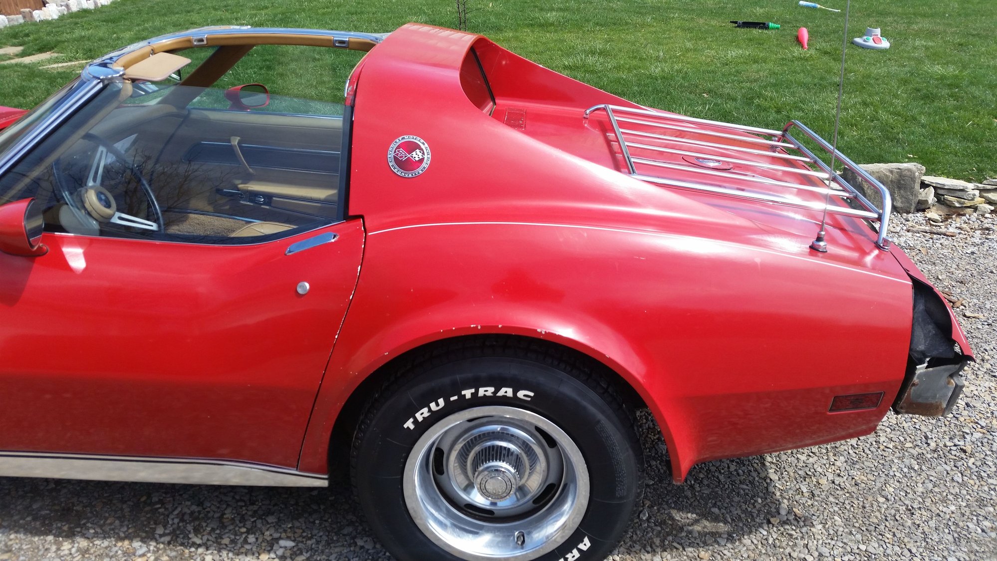

Sounds like you've got a good plan there. A solid cruiser is easy to build compared to some other end-uses.
Just a little additional info for you, if you care:
The luggage rack is an aftermarket piece. The GM rack looks and mounts differently. It could be period-correct though: I think I've seen a few other cars here on the forum with that kind of rack.
The emblems on the sail-panels, behind the door, were never there from the factory AND are not correct for the year: they look like nose emblems for the 73-74 cars. In my opinion, they look tacky. Your opinion may vary though, and it's your car, so who cares what I think?

This is the kind of info I love! Thank you so much.

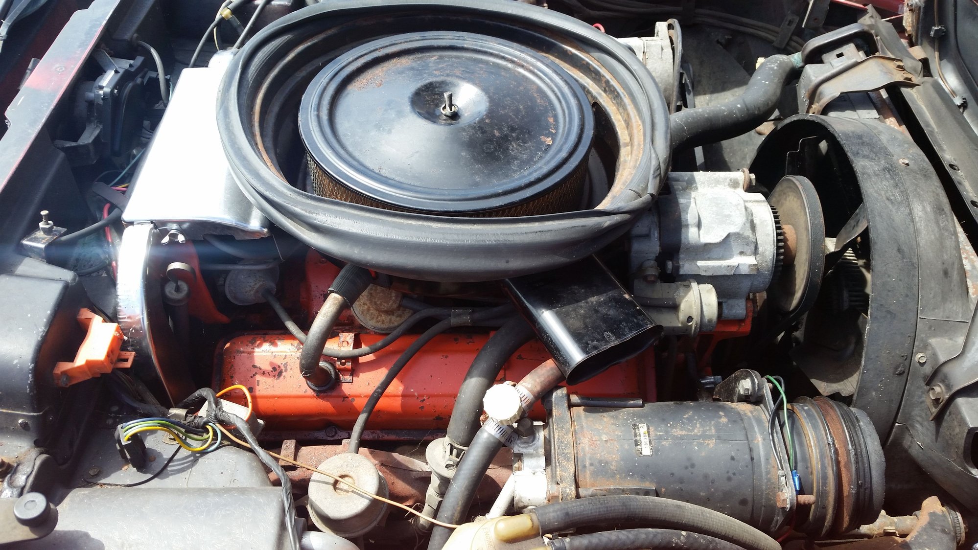

Now that you posted pictures of the engine compartment, I have to comment that it has lot's of correct original equipment. These days it is hard to find a 40 year old car that Bubba hasn't totally screwed up the mechanicals. With a little clean up it will be like new.

Car appears to have original engine. Makes it even better. Keep it that way. Again MHO.. You should buy the NCRS juging guide for the car. Even if you dont wish to restore it this is a great guide to diirect you how things should be or at least were. I think you will find it fun to research all the "numbers", date codes , part numbers etc. I did anyway with my '78 and it was well, sort of like a treasure hunt. If everthing is in fact original you may want to keep it that way. I would.

The car looks quite original in many ways, at least to me. Still has its smog pump even.

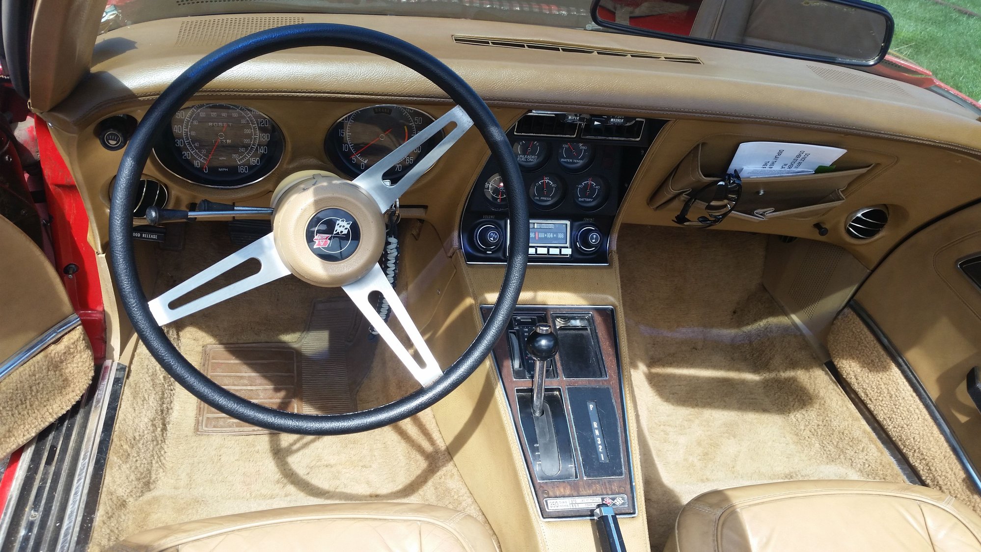

Ok, please don't laugh at my question. Driver side dash, two ***** I have no clue what they do on the lower part of the dash near my knee. Also how do I switch between brights and dims. I'm still trying to figure out what works and what is broken lol.

Great to see you driving it!! One of the ***** is a vacuum override for the headlights,(mine only has one, not sure of the other) the hi-low beam switch is old school style and is in the upper left hand corner of the floor board on. It is activated with your left foot ( not the steering column) This is some old guy knowledge stuff.

The other **** is the odometer reset.

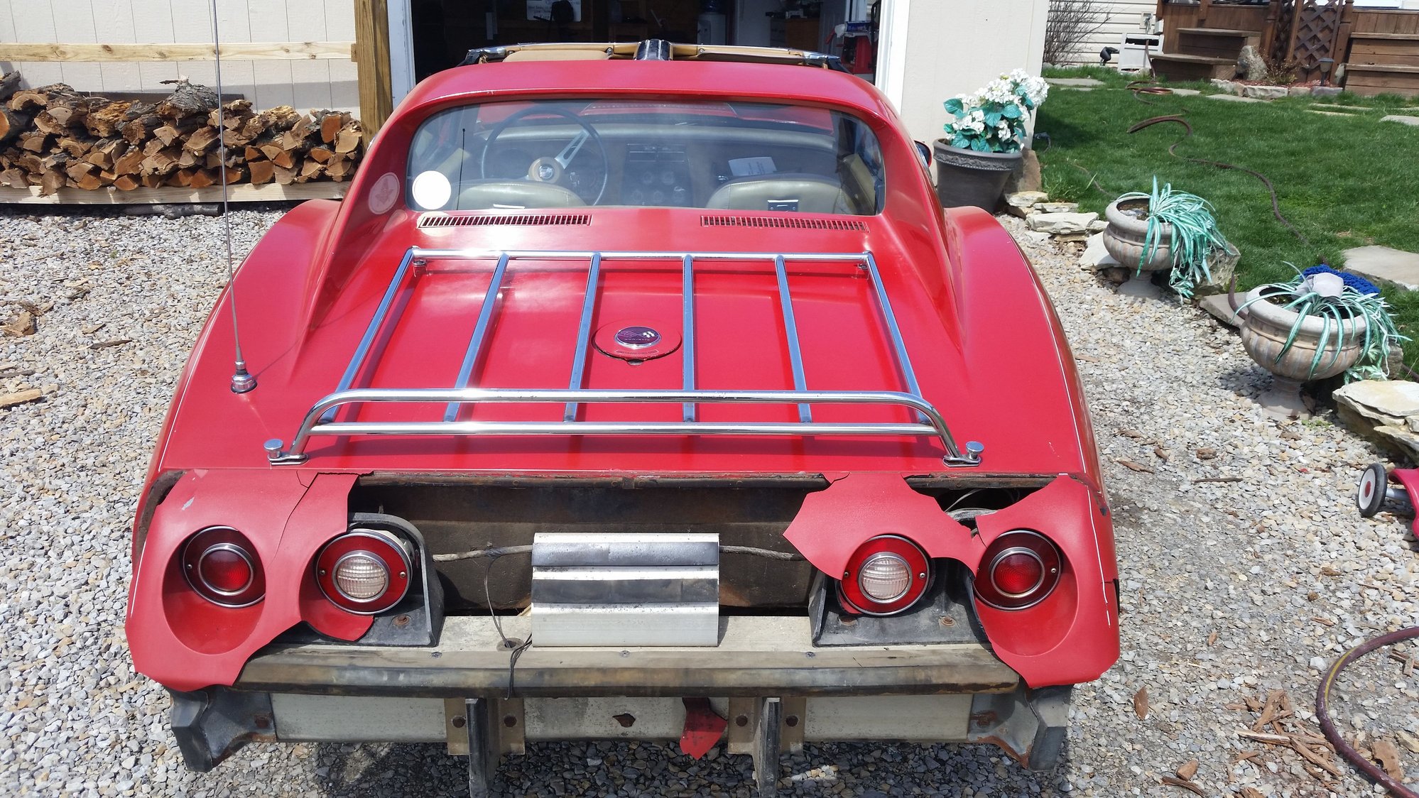

I'm going to order the replacement rear bumper cover as mine is gone. Does the new one come ready to mount with the studs attached? Or isv there a mounting bracket I have to order too? How well did yours line up?
