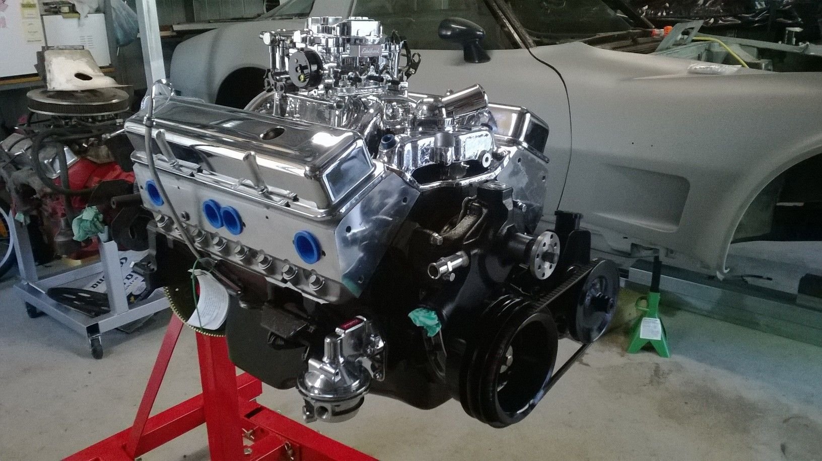

Default BluePrint 383
I'm using a BluePrint Engines 383 in my 79. Haven't run it yet but by all reports they are a pretty strong motor. Reasonably priced too I think. I couldn't have built an engine for what I paid for it (I would have had to pay for labour) Check them out on this forum. There was a recent thread about it.
