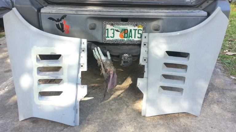

Old May 6, 2015 | 07:17 PM
The13Bats's Avatar
The13Bats
Joined: Mar 2003
Posts: 11,608
Likes: 780
People drive around with their tag showing why scared of posting pix of it?
Yes, when the 69 come back home..."if"
it ever comes back home that tag will get transfered to it...

That is not the subject of this thread.
No kidding..... was just folllowing in with what you and ddawson where talking about so sorry...

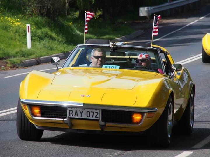

riverracer au's Avatar
riverracer au
Joined: Oct 2010
Posts: 2,276
Likes: 337
From: "ɹǝpunuʍop", Adelaide, South Australia
don't need them down here, but i like to be see on country drives.
din't like the look of adding any other LED's to spoil the looks...
old photo, (only one on my phone), they are much brighter now
i originaly bought a module from a vendor but it blew up after a month,
and they wouldn't honour replacement, because, get this, "cause i live outside the US".
so couple relays, some diodes and a large capacitor later i turned my indicators into DRL's.
switch on when needed, turn off with parks lights come on,
turn indicator on, and they go off, flash/flash/flash, turn indicator off and they come back on about 8sec later.
i use the longlife filliment blubs, the brightest i could find. (led's illegal unless originaly fitted)
painted my reflectors white, (mine were painted black when i got the car).
have been told that they stand out when i'm hanging way back,

bk,
It is not just the park lamps on although it may be on that yellow car. The DRL module works on the bright (turn signal) filament of the normal #1157 bulb or in my case a #2357. It is very bright and the turn signal function is not altered at all. It does turn off when the headlights are on and reverts to just parking lamps.
I like the Australian fellow suffered a module failure several years ago when I originally installed on my 1974 (and I had one on my 1967 many moons ago) and they gave me the "you are outside of the USA" excuse re warranty. I was not happy with that reply and made some veiled threats re product reputation. Both my Corvettes were featured on their web site. I received a replacement module shortly thereafter.
