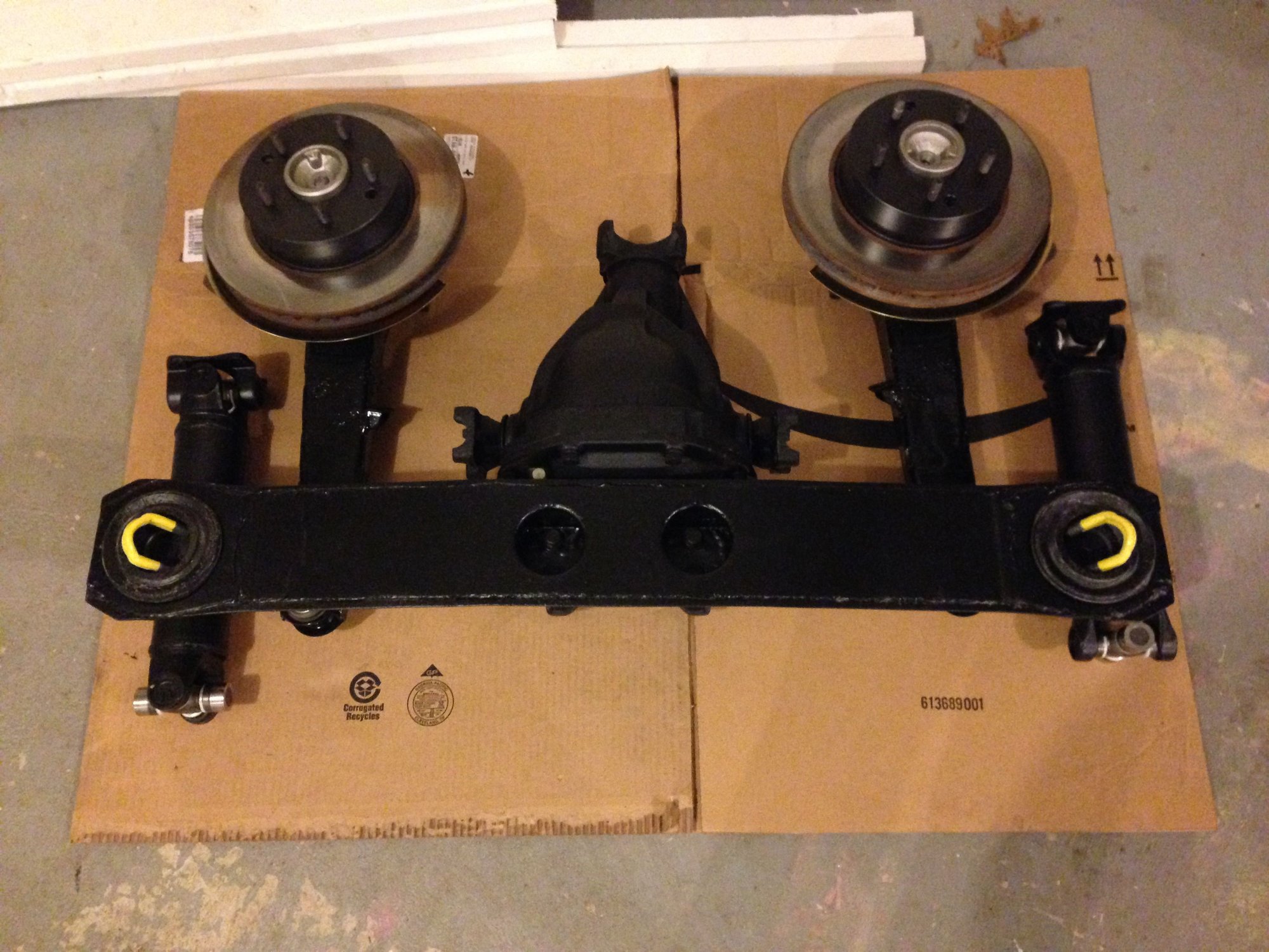

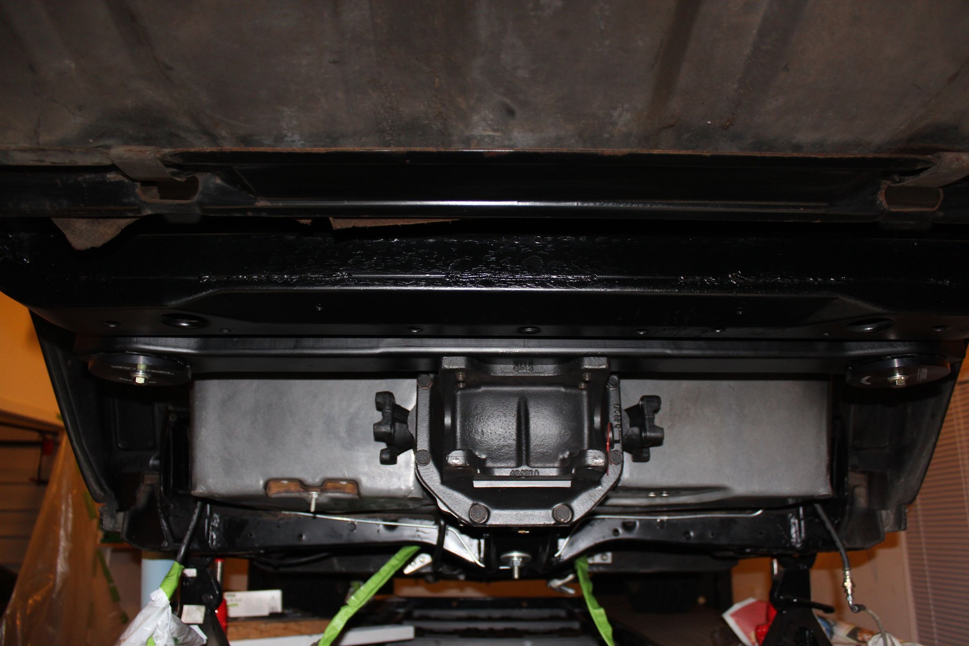

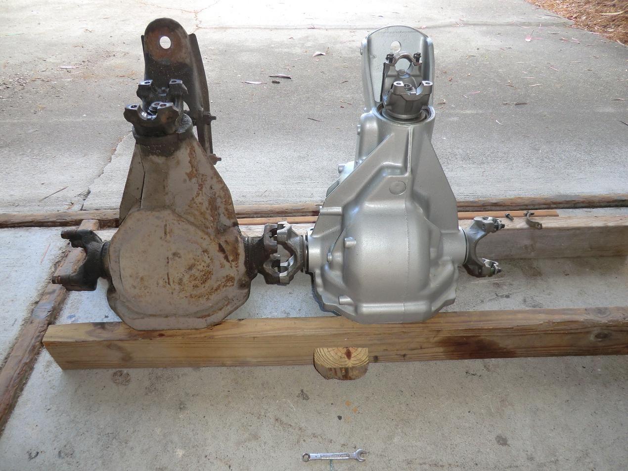

I just recently finished mine up. I swapped out my cast iron Eaton diff and installed a Mike Dyer built Dana aluminum diff. Also installed Global West TAs and struts with a VB&P Smart Strut Bracket. Already had a 300 lb composite spring so just swapped it over. And installed Wilwood D8 calipers and rotors.

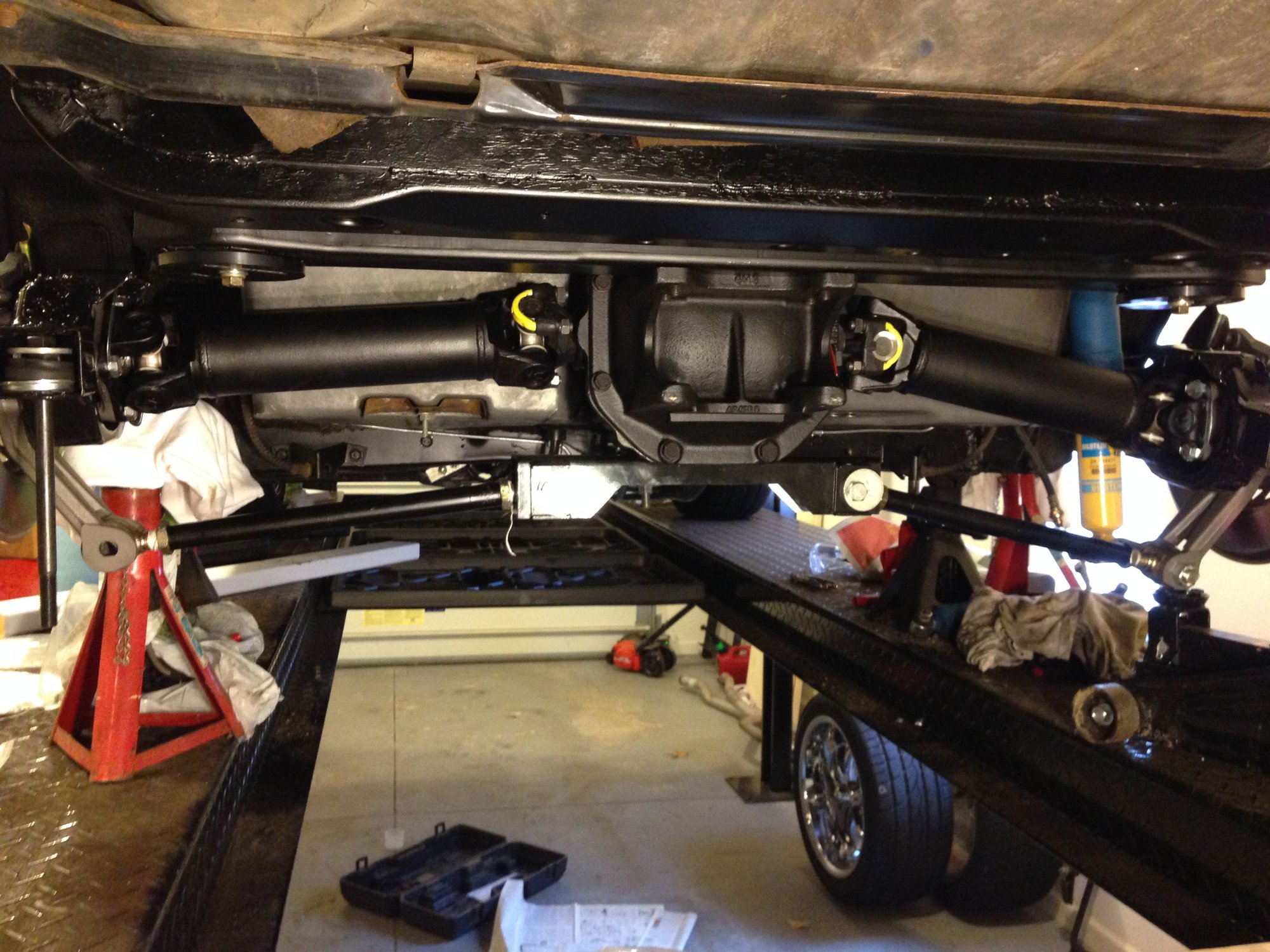

I just realized I don't have a good picture of the finished product, but one that is close. I had the composite spring before I tore the rear suspension out and had it all rebuilt. I had the trailing arms done my Mike Dyer and the local Corvette shop did the differential. Mike's work is amazing.
