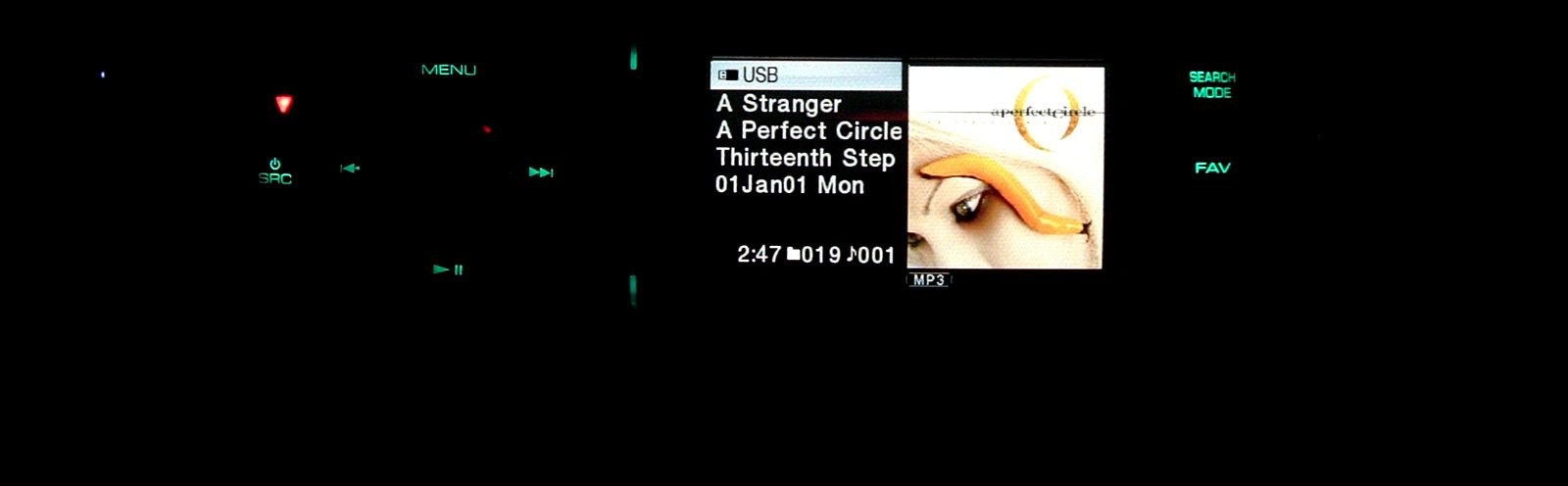

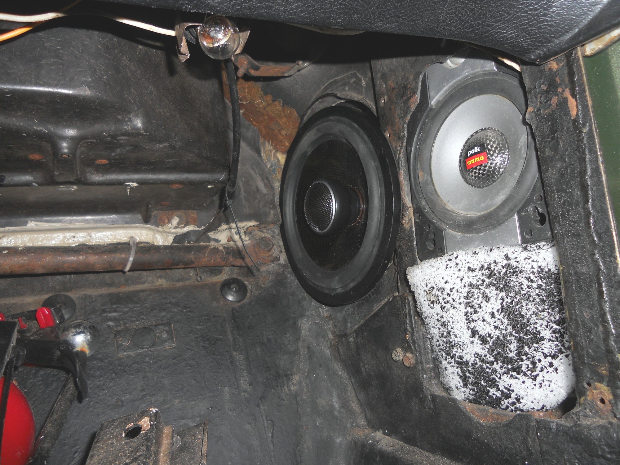

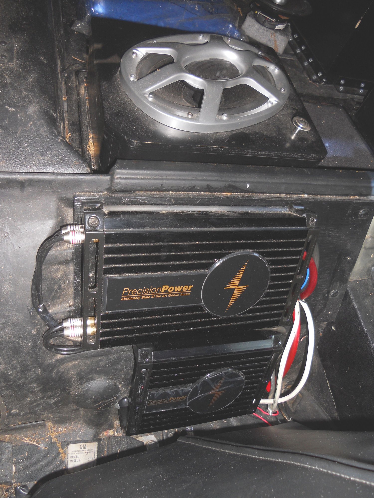

ive got pretty modern. i wanted to go with the pop up one too, but i wasnt about the lose my gauges,
so...(and i apologise for the crappy pictures)
KIV-700
Polk MM651 (and MMC461. i might just keep them seeing as theyre in there already)
Polk MMC690, PPI Phantom 600.2 + 900.4

it wasnt too terrible, but there was work involved.
i drilled out those rear bulkheads to mount the wood to, which is what the amps screw into.
the 6x9s fit inside the original plastic lid pieces, but the rest had to be built from scratch.
the previous owner already opened up the 4x6 openings to fit 4x6s, so no work from my end. the fit is actually so tight that, except for that foam support piece, i dont have them bolted down at all. been that way for years now.
6.5s where a bit of a bitch. i lost the fresh air intakes entirely, and closed them up (the hardest part) so water/debris doesnt get to the speaker. plus new mounting holes had to be drilled, and the plenum lip ground down to allow the speakers to flush mount.
the drivers side speaker needed the hard plastic housing ground down about 1/4" in one spot to clear a frame brace.
i havnt finished the 6.5 install yet, but it looks like i should be able to conceal them entirely behind the original kick panel. i might need to tweak the kick panel a bit, but ill figure that out when i get there.
and the stereo was easy enough. notch out the stock bezel and install.
oh, almost forgot the sub. i lost 1/3 - 1/2 of my rear storage compartment to that. and it goes from the floor to like an inch below the decklid. plus i had to drill out the floor to mount it securely. most dont take that much to secure, but this is a big guy. the sub alone weighs like 30-40lbs, and then add in another 10-15lbs for the box... ya, i need that bolted down securely, and to spread the load over as large of area as possible so i dont rip it out of the floor in a turn.

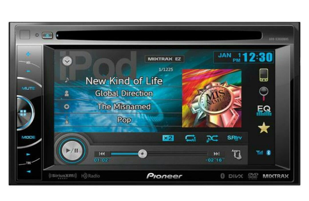

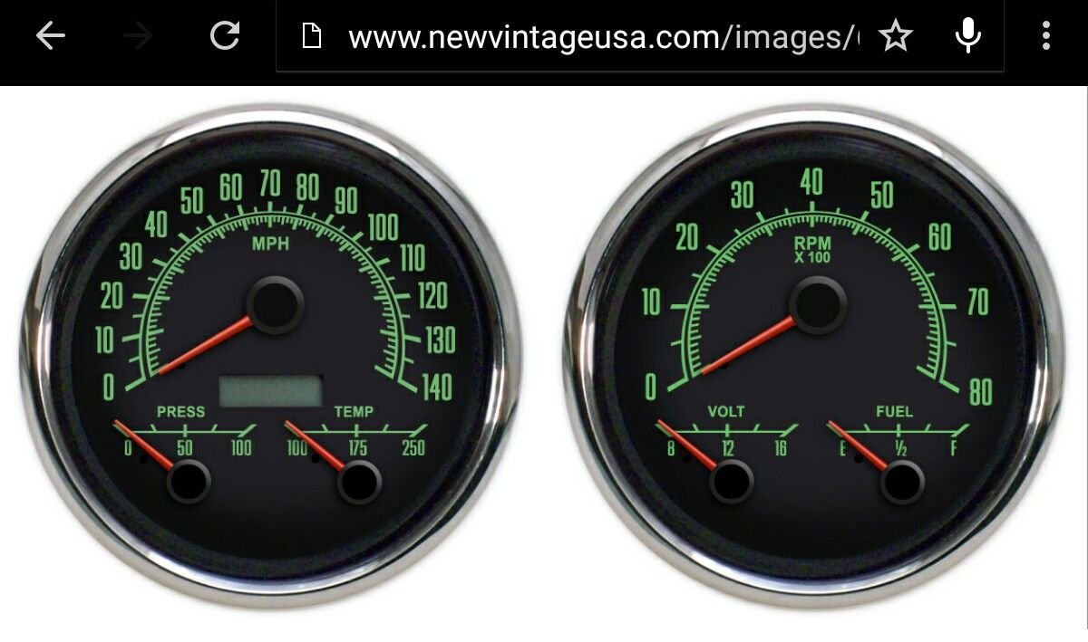

I'm just getting started with my '77, but I'm thinking of removing all the gauges in the center stack by installing some combo gauges in the drivers dash.
That will free up the center dash for a double-din head unit.
Gauges
Head unit
