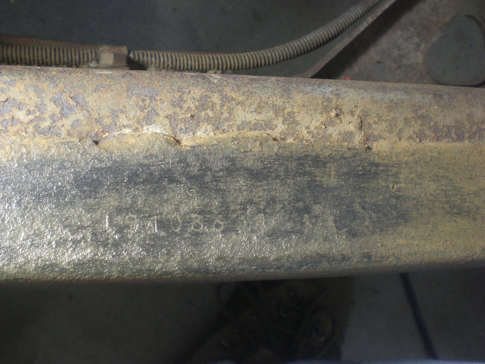

The VINs on my '71 frame are barley readable. Is there anything I can do to enhance their appearance to make them stand out better?

Why? When the body goes back on, no one can see them. You could possibly remove some of the scale, use a grease pencil to highlight the characters, and take some photos of record.

Just wanted better numbers for photo documentation before I work on the frame and possibly do more damage to what's already there...

not much left, I have used a pointed awl, to carefully trace over the letters with some pressure, down on the numbers to scratch out the years of grud buildup.
use a wide putty knife to scrape the area flat and clean.
clean up the best you can, angle your light to achieve best photo's for documentation.

How does blasting effect what's there? I think I shouldn't go too hard or too long on the VIN (as well as the rest of the frame for that matter) but should I avoid the VIN areas altogether when I'm blasting?

blasting will deteriorate small details,of what you have left., I would not do that for the VIN area,
this is mine after cleanup and how I documented it.
Before :

Be extremely careful with the stamps. You can never get them back if you overdo things. My advice is to avoid using anything abrasive on them.
Before :
The upper after pic does look like 9S720054, but the lower before pic looks to be 9S7200534. Why the difference?
