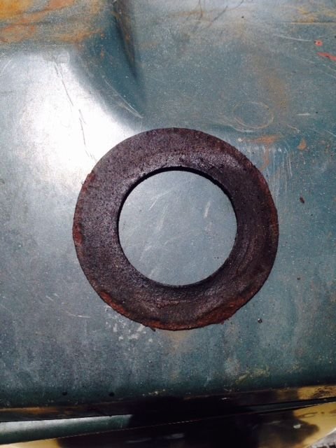

I am currently rebuilding the front suspension and have the parts on the way. One part I just discovered I didn't order is the steering knuckle gasket. Isn't this just a noise isolator? If so, I'm thinking I will be ok reusing the old one.

It's a gasket designed to keep dirt from getting between the spindle and dust shield.
It certainly isn't highly critical, but it should be there. You can reuse the original or make your own out of roofing paper... That's all it is. I want to say that Paragon makes a reproduction if you are so inclined.
