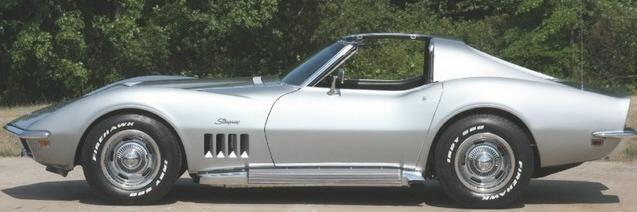

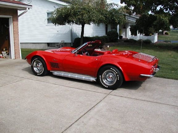

I'd started down the Hooker path before I saw any C3s with these... Depends on the character of car you're after, but I really like this look. IMO this style flows better with the C3 than the factory C3 style...
Not sure who's car this is, but very nice!
