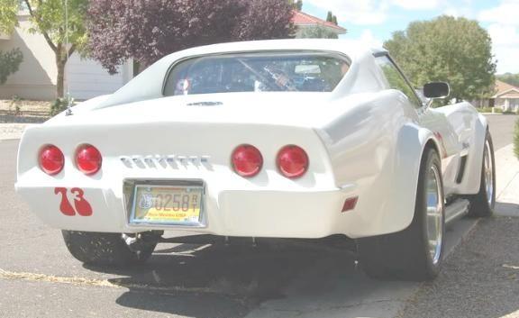

I found this picture the rear view the cat said the tires are 315/35/17 on 11" rims.
But in the front view he says they are race tires the same as 335/35/18 on 12 inch wheels, not sure my flare will cover that...
I found this shot
Rears: 11x17 with 315-35-17's
While the flare is the Ecklers ZL-1 style, man did this look tailor made to fit...

It looks like you current setup would allow for more tire outward without extending past the fender well??
True, but looks can be deceiving on my car as I'm running about 1.8* negative camber in the rear. If the tire were more vertical it would appear to fill the wheel well better, the top of the tire would be closer to the lip.
I'm not sure what the current availability of 315-17 street tires is, I only have race tires. Seems like 18's are the ticket these days.
Bats: the green car is gkull's car. I thought he used to run 335-17's on the rear. The head-on shot of his car doesn't appear to be 335-17 rears.
The white car was another CF member, can't remember his user name.
