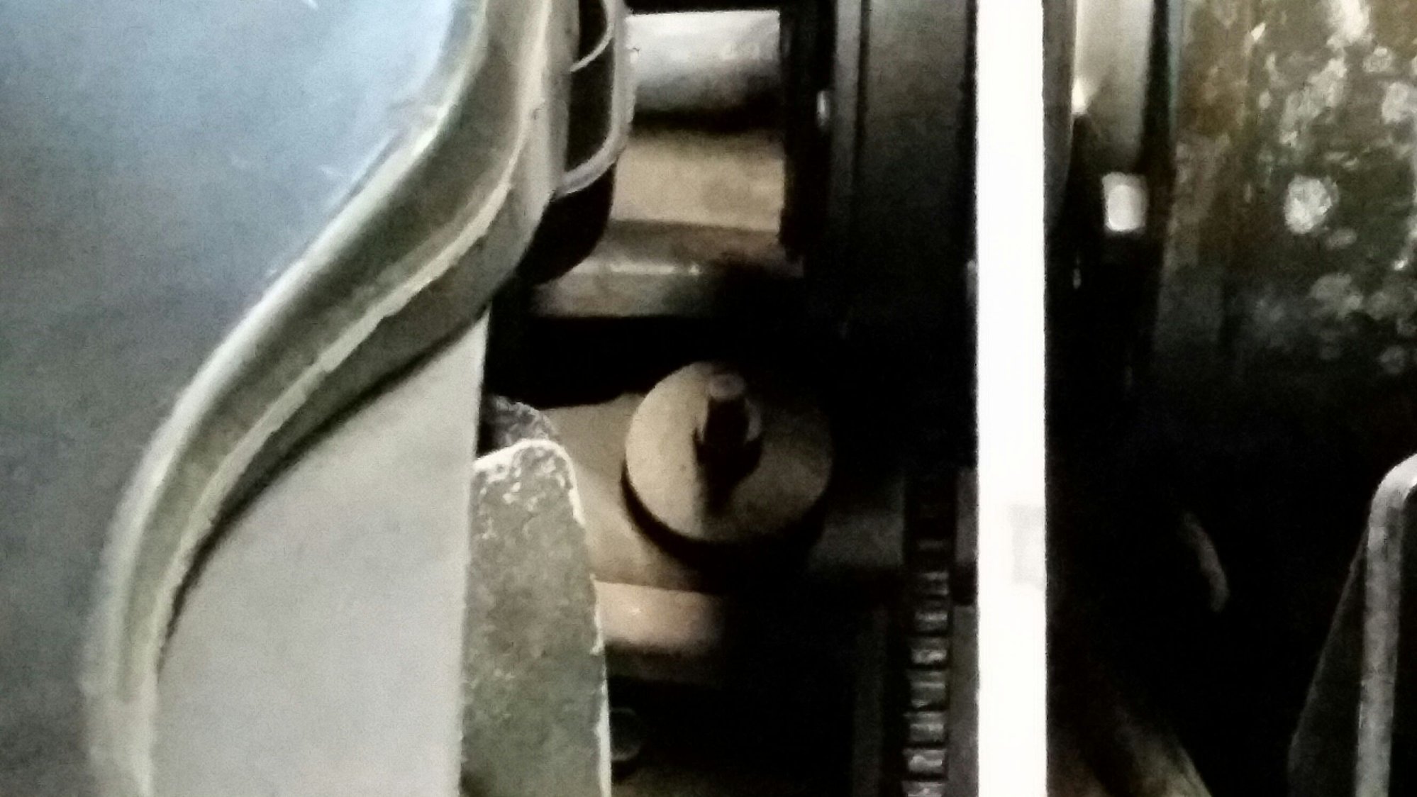

Top pic showa emty hole. can see a bolt underneath, not connectef to anything, bottom pic is from the otherside.. Does anyone know what this is ,, somethging to do with the front suspention ??

The top picture looks like were the shock should be.
Can't tell anything from the 2nd.

Top picture looks like where the shock should be to me also.
The bottom picture is the passenger side. And you can see where the shock is mounted.

The washer/nut/and stud is missing. Going to have to jack it up and see why its not bolted up. Is it broken off or the threads stripped or did it just loosen up to the point where the nut and washer fell off allowing the shock to compress and the shaft come out of the hole.
