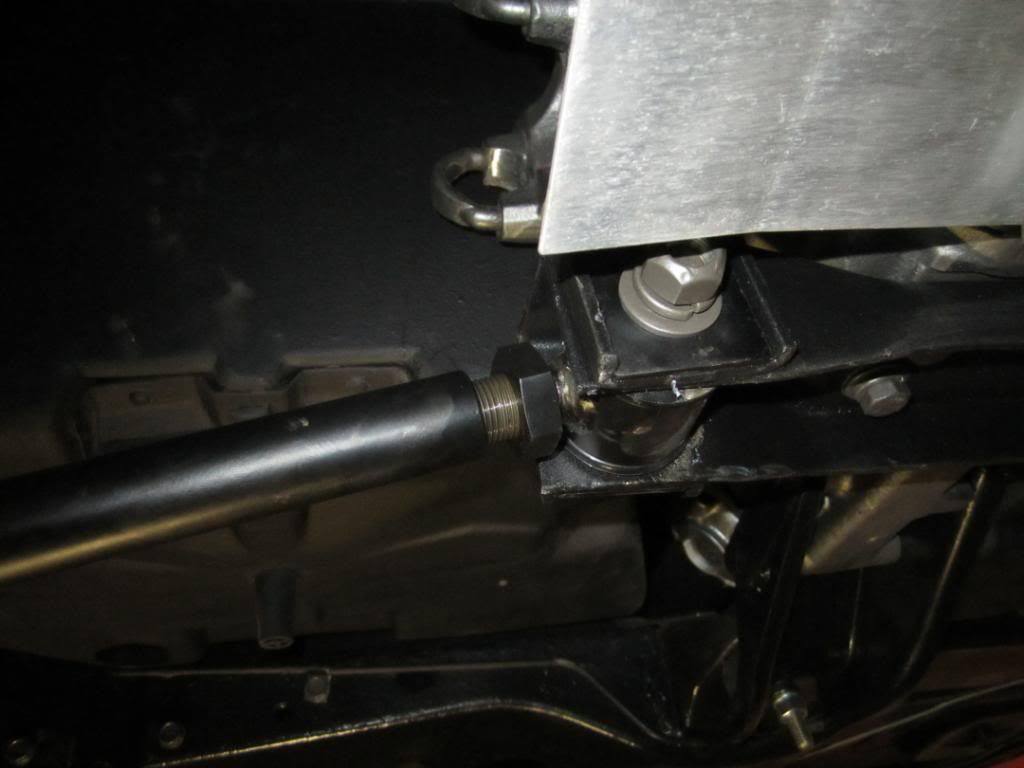

when reassembling the rear suspension do any of you recommend installing the lower strut before the half shaft or vise versa? I put the half shaft on the T/A first, then the upper strut rod into the bracket on the differential and now I am having trouble getting the lower to line up enough to put the lower shock bolt in. doesn't seem to want to line up perfect even with moving the T/A up or down or working it with a dift pin.
I don't want to beat it with a sledge so I am game for a new plan of attack tomorrow morning with any advise from you guys?
FYI- the strut rods are adjustable ones not stock , T/A's are fresh rebuilds from Zips with the lower strut/shock bolta also new from Zips.

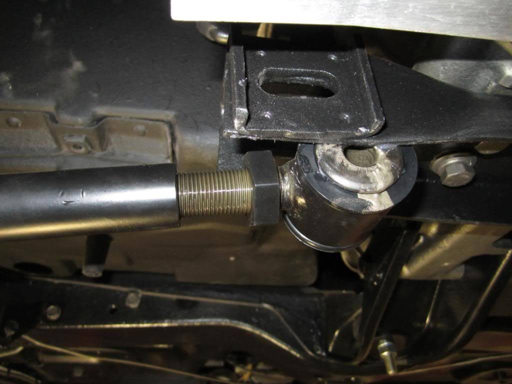

the problem with the strut rod ends not fitting was due to the overall size of the rod end and the machining on the strut rod mount on the trailing arm.
the casting is a new one that Zips uses when the recondition trailing arms, they are machined for stock strut rods ends the do not allow for the larger diameter aftermarket adjustable strut rod ends. the machined shoulder stops the larger end from moving on center. I ended up carefully using the end of a new 4" grinding wheel upside down to cut back the machined shoulder, then deburred & smother the area with a 2" cookie wheel. i also found burrs on the machined surface's where the strut slides into that needed to be eased and the new lower shock mount needed a larger chamfer where the flat is machined to be able to line up and slide in better?
once I did that the strut rod end went right in and lined up perfectly.
