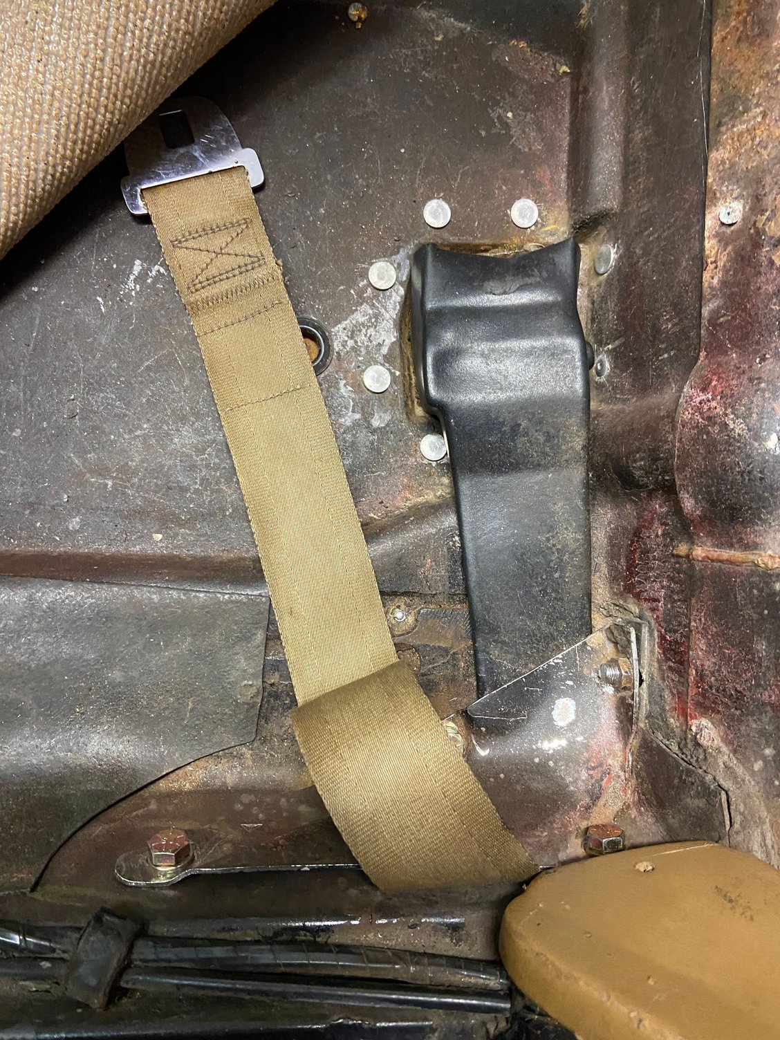

I agree with Rescue Rogers. My dads 67 has a seat belt retractor with very little movement. And since I just put the lap belts in my 68, I can undoubtedly say that, at least my car has no retractor. Yes, I put grade 8 bolts on my lap belt reinforcement plate. Just a little extra assurance. It sits under the carpet, so it’ll never be seen anyway. Mine is a February 68 build date L79 with saddle leather interior, if that matters…
