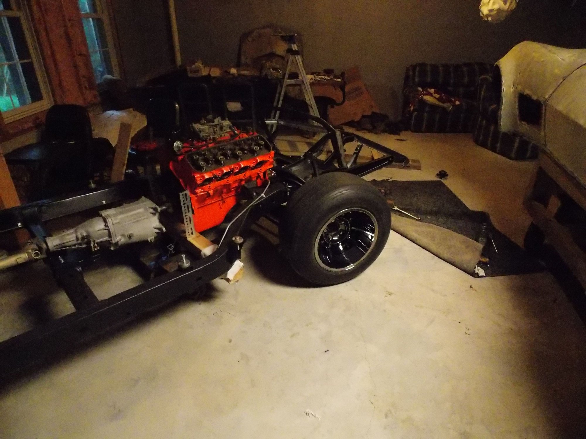

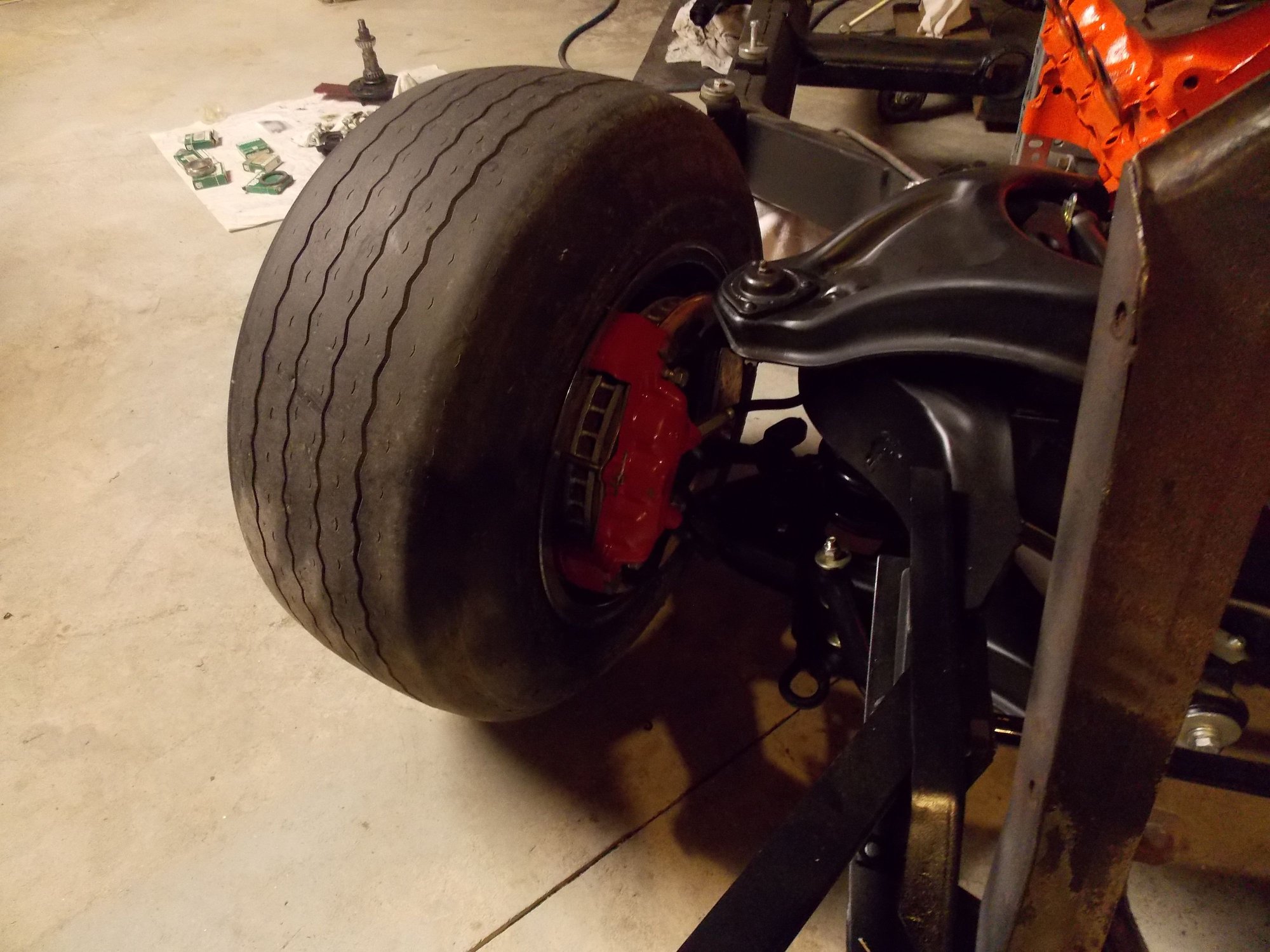

Finally finished brakes and suspension on right front .No on to the rest of the suspension and brakes .

It looks great. What did you do to prep the calibers and what type of paint did you use on them? I would love to detail the front end of my 68 but I want to make sure to use something that will hold up if I do all that work.

I used a kit made by Dupli-Color calipar paint kit.I got it at Adavanced Auto parts for $20.00 Comes with cleaner and plenty of paint .I put a little enamel reducer and sprayed mine but you can use the paint brush also .
Good luck
Wes
