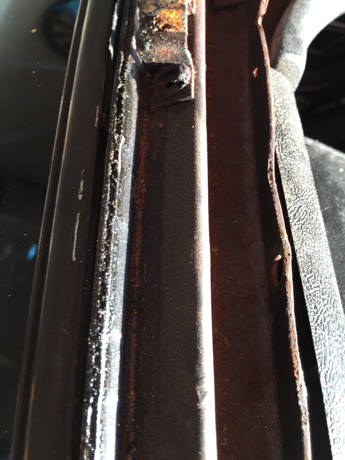

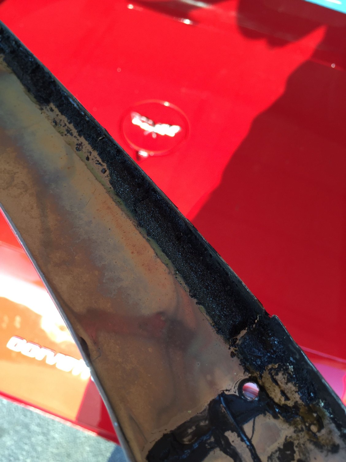

I pulled off the top t-shaped chrome piece from the frame to remove some residue and create a better seal. I noticed under it there was some sort of crumbling foam strip and some black greasy goo (I think that's the technical term).
I want to scrape this stuff off and replace it before putting the chrome piece back on. Yalls thoughts on what I should use? thanks!

GM used a putty type sealer in the windshield header, similar to "DumDum".
I don't believe DumDum's available anymore, but a modern silicone sealant would probably work as well or better.

I used electrical "duct seal" in mine.... only about 4 bucks a pound at an electrical supply store.
