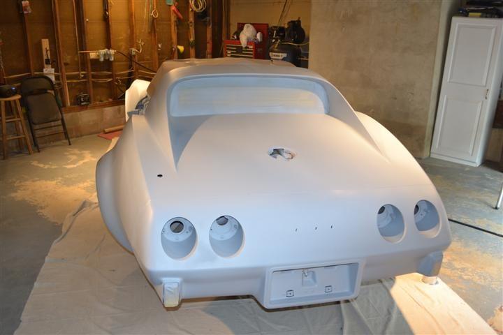

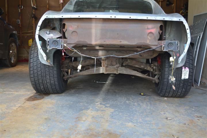

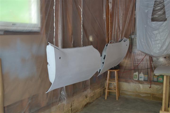

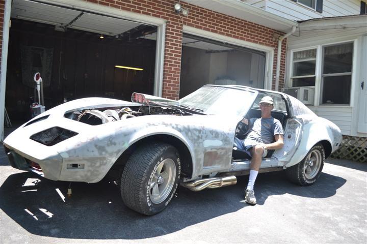

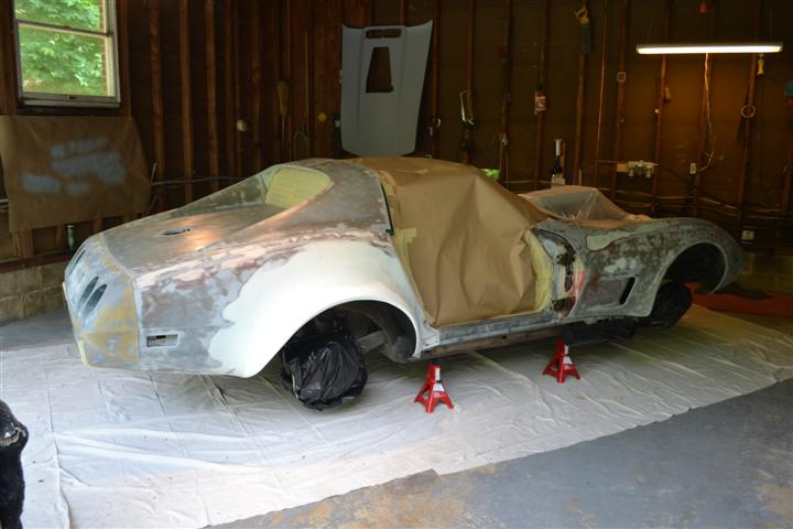

Set up...
improvements....
Blast off...
More meat...
Make it fit...
Mad Max...
The cover up...

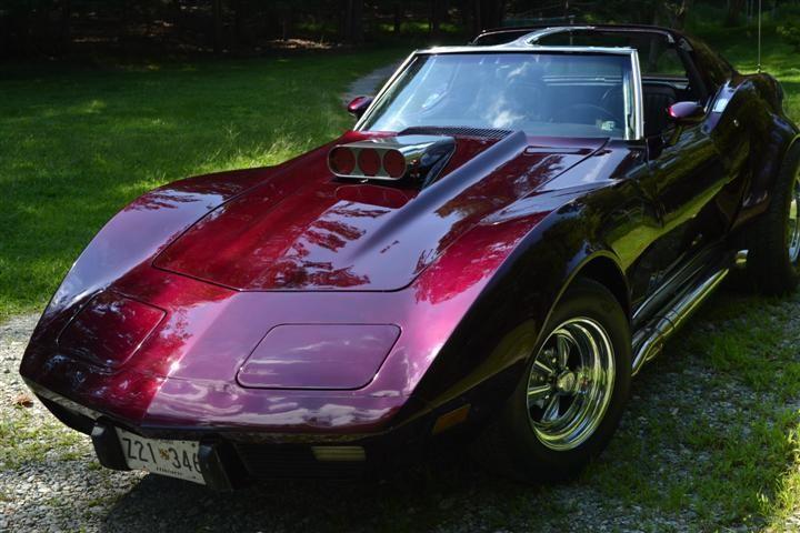

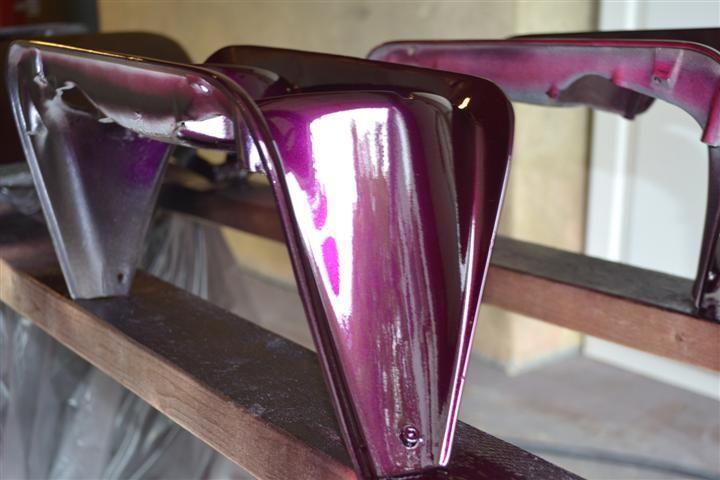

Prime Time...
Sporty...
New Goodies...

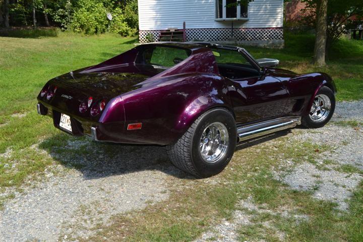

Yeah Baby...uh huh...you know how I like it...
Hang em High...
Candy Wild Cherry...
Old Jul 20, 2015 | 06:24 PM
indianriverbound's Avatar
indianriverbound
Joined: Apr 2014
Posts: 58

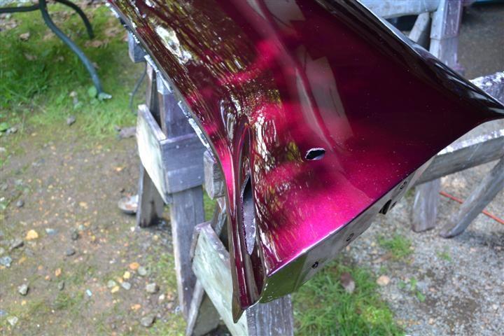

All one color again...
Knock that shine down...
Yeah...I feel buff...bring it back

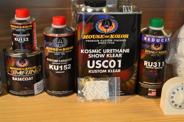

Originally Posted by rvzio
Looks real nice. Getting ready to do my 69 for the first time also. How did the concourse system from Eastwood work out. Any tips for first timers??
R
I went with HOK paint products...the shimrin2 series of kandy...much better selection of color....Go with the Concours Pro Gun kit....full and detail....about $350 but worth every penny. Don't skimp on equipment to save a buck...it will cost you in the long run....good grade sandpaper, durablocks, ect. Also pay the $80 and get HOK digital paint booth. Hard to visualize your car from a paint chip but the booth will let you apply any color paint they have and review it in all shades of light in 3D, that is how I picked the color. Other than that just sand your azz off and pay attention to detail....I have about 100 hours into the prep and will put another 20-30 in the cut and buff....Good luck and post some pics.

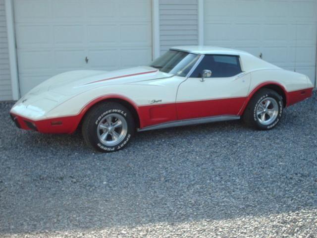

To 76 project in pics...
Old Aug 7, 2015 | 02:02 PM
indianriverbound
Joined: Apr 2014
Posts: 58

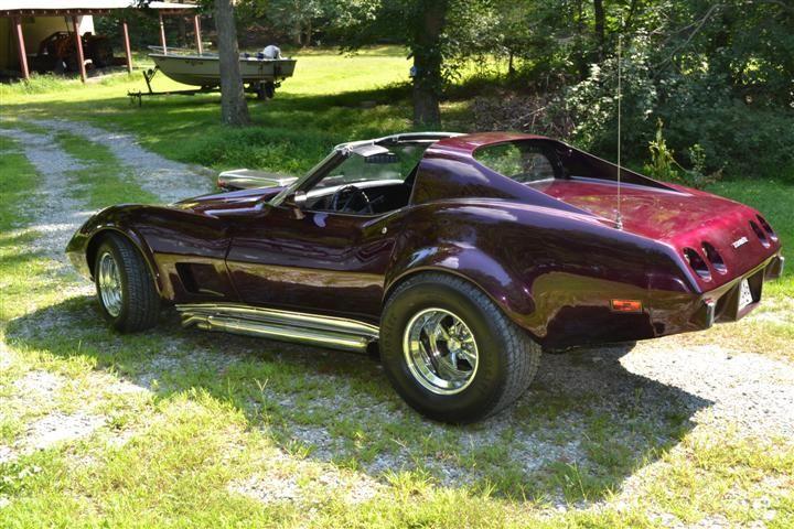

Old Aug 7, 2015 | 02:05 PM
indianriverbound
Joined: Apr 2014
Posts: 58
Not a show job but for a first time paint in the garage I don't think it came out too bad. Still got some buffing to do, some little odds and ends, but finally got it back on the road and it does gather a crowd at the gas station.
