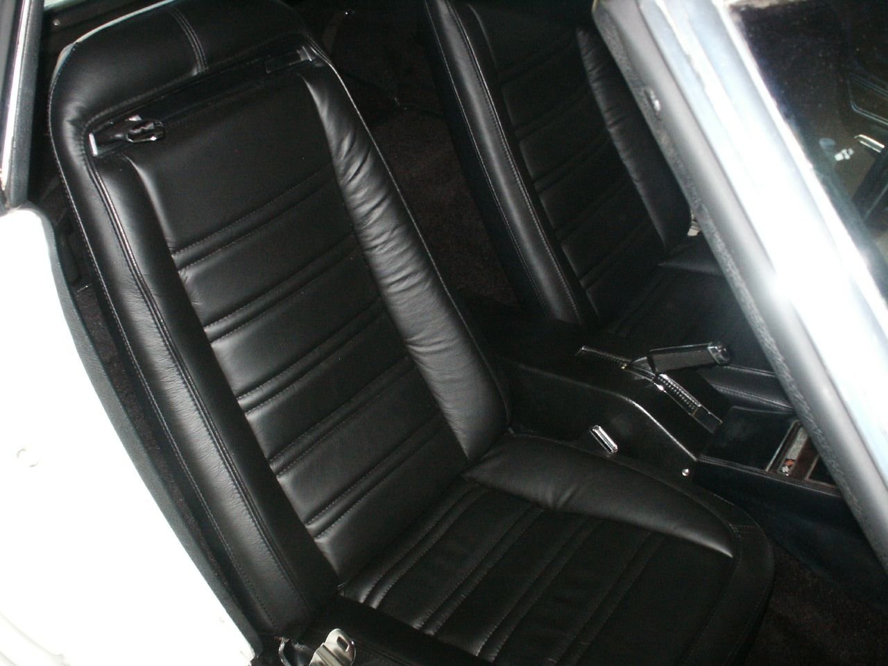

I replaced the seat foam and covers in my 72 and 73. The first seat was pretty difficult. By the 4th seat it was really pretty easy.
Its not that hard to do. Just takes time and patience. Buy a good set of hog ring pliers. The cheap ones seemed to tweak sideways when trying to pull the hog rings together.
The hard part is pulling the covers over the foam. It looks like the leather/vinyl will split and tear, but with constant pushing and pulling it will soon slide into place.
Wilcox has a good online video to watch over and over and over before you do this. But at some point you should get that aha moment and say that it doesnt look too difficult.

I stripped my seats down, had the hinges rechromed, sandblasted and epoxy coated the frame, installed new foam and Al Knoch covers. They turned out great. I would recommend this as a good project.

I bought my seat foams and leather style original seat covers from
Willcox. They both are made my Corvette America. I watched the
video for recovering my 73, took my time and it came out looking
good. CA has videos for the different years models, just pick your
year and follow their instructions. I watched the videos several times
before I began, and had no problems. I also restored my frames while
I had them apart.

Replaced the foam and covers on the 69 not that long ago. Definitely purchase the new foam, covers, baby powder (for helping the covers slide over the foam easier), and the better set of hog tie pliers. Not a difficult process at all, especially with a computer near by to reference videos online. You can do it.
