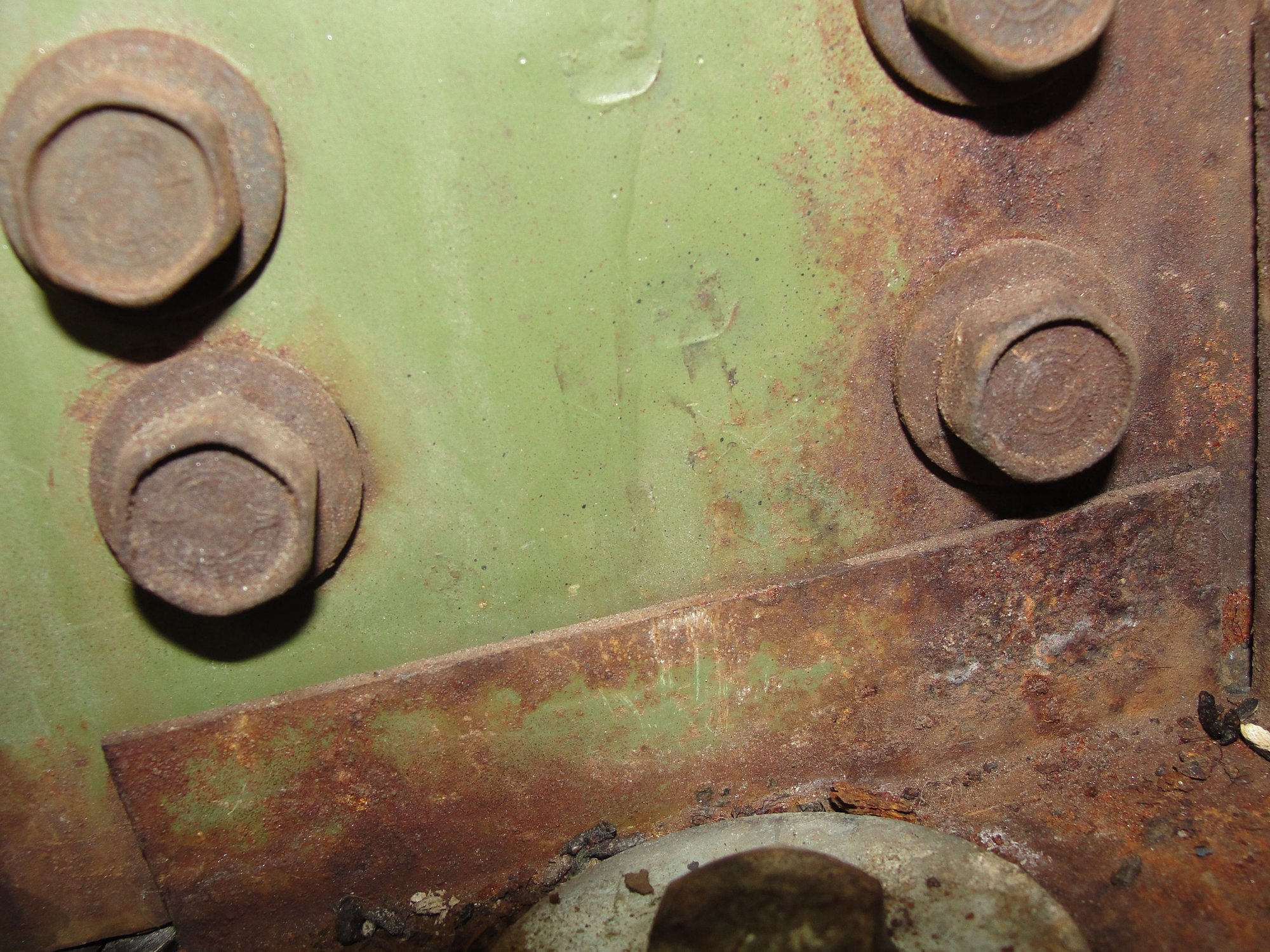

Folks, I would like to solicit input from this esteemed group of experts regarding some of my birdcage on my '73. First time in 2 years really going beyond the easy 'remove a kick panel' step - and first time to have a decent cell phone to take a picture. Redoing the carpet/vinyl dye/seat re-covers this week/end, so it's mostly disassembled... leading to a good time to dig for rust!

drivers side, after lightly brushing some loose bits off - hard to reach that inside corner.
Same, drivers side - different angle.

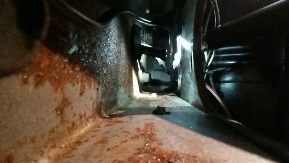

Looking 'up' from the bottom of the kick panel, inside the cage. Looks like just surface rust.

that looks like surface scale, looks to be in average condition, I would not
have a concern with those areas. I have seen much worse.

Default how did you take that last picture?
this guy? are you looking up from inside the car with the camera?

Carriljc - correct, laying down in the driver's foot-well, camera snug inside the birdcage, looking up.

Your in great shape, Mine was Much worse. I had to fab new #2 pockets, install new rocker channels and fab a windshield lower corner. For yours I would pull the bolts, clean it up and paint with one of the rust encapsulation paints, good to go

I think the amount of rust behind the kick panels is minimal and nothing to be concerned about. A good indicator of windshield frame rust is the presence of rust flakes that fall into the kick panel pockets and accumulate around the body mounts shown in your pictures. A few flakes is not a big deal, but if the body mount bolts are covered with rust flakes, that is indicative of significant windshield frame rust.
