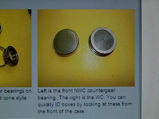

If going the t5 route, try and find a world class t5 over the non wc.
Did two T5 swaps in my 68 and 77 with late 80's camaro and firebird T5's. So far so good, no problems in 7 years. This is how you tell the nwc and the wc apart:
Mods are shorter driveshaft, rear mount and exhaust mount and shifter location if that matters. Not to big a deal, and well worth it. Good luck.
