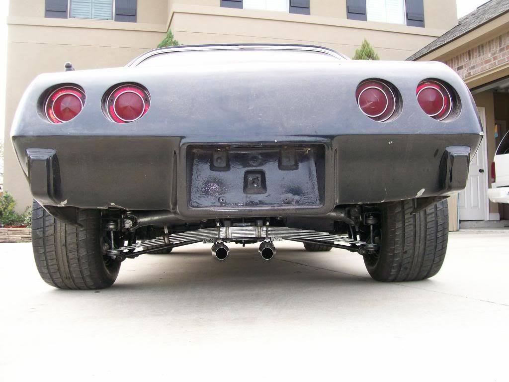

Sounds good! But.......I'll trade "my Bubba" for "your Bubba" any day...........here's why........LOL.....................
1968 model...........................

Yes, that is a real Bubba back fascia. Wonder why they want to get rid of the back up lights? Did Bubba put the steel bumper plate behind the fiberglass or just add the back panel?
