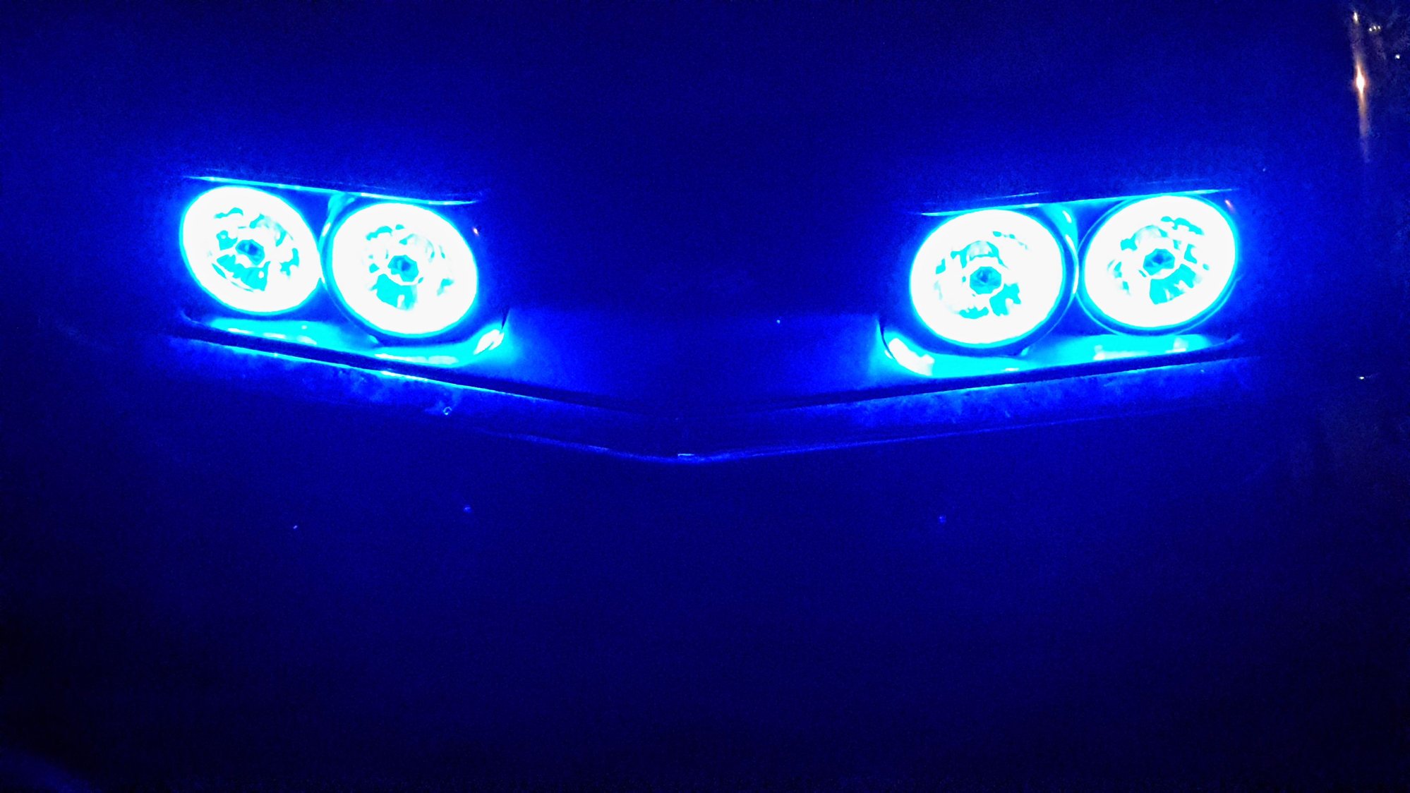

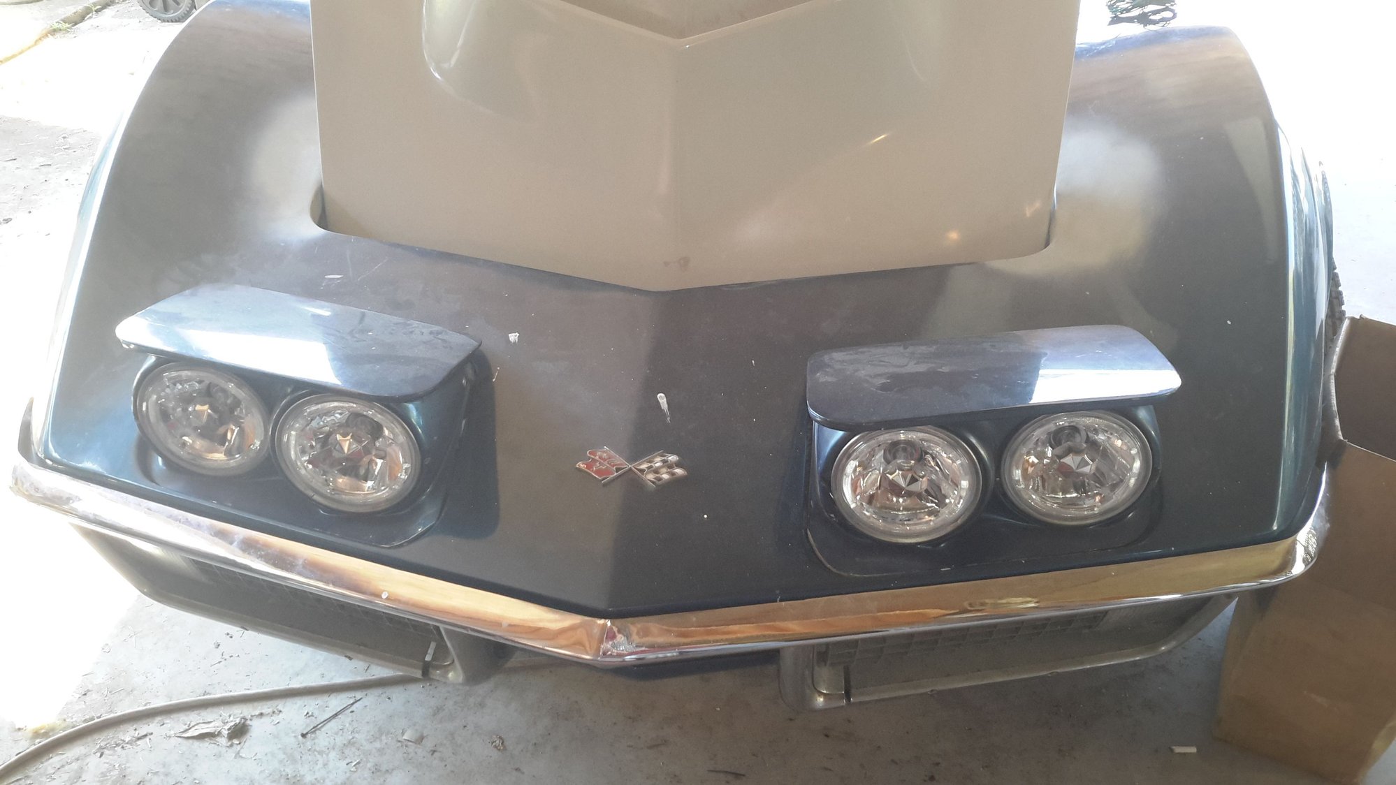

Installed some blue halo lights. I had to cut on the metal behind the lights near the plugin to make them fit. But Im happy with them.
Ordered new springs and bushings for the pop up headlights. Still need to get a vacuum tank.

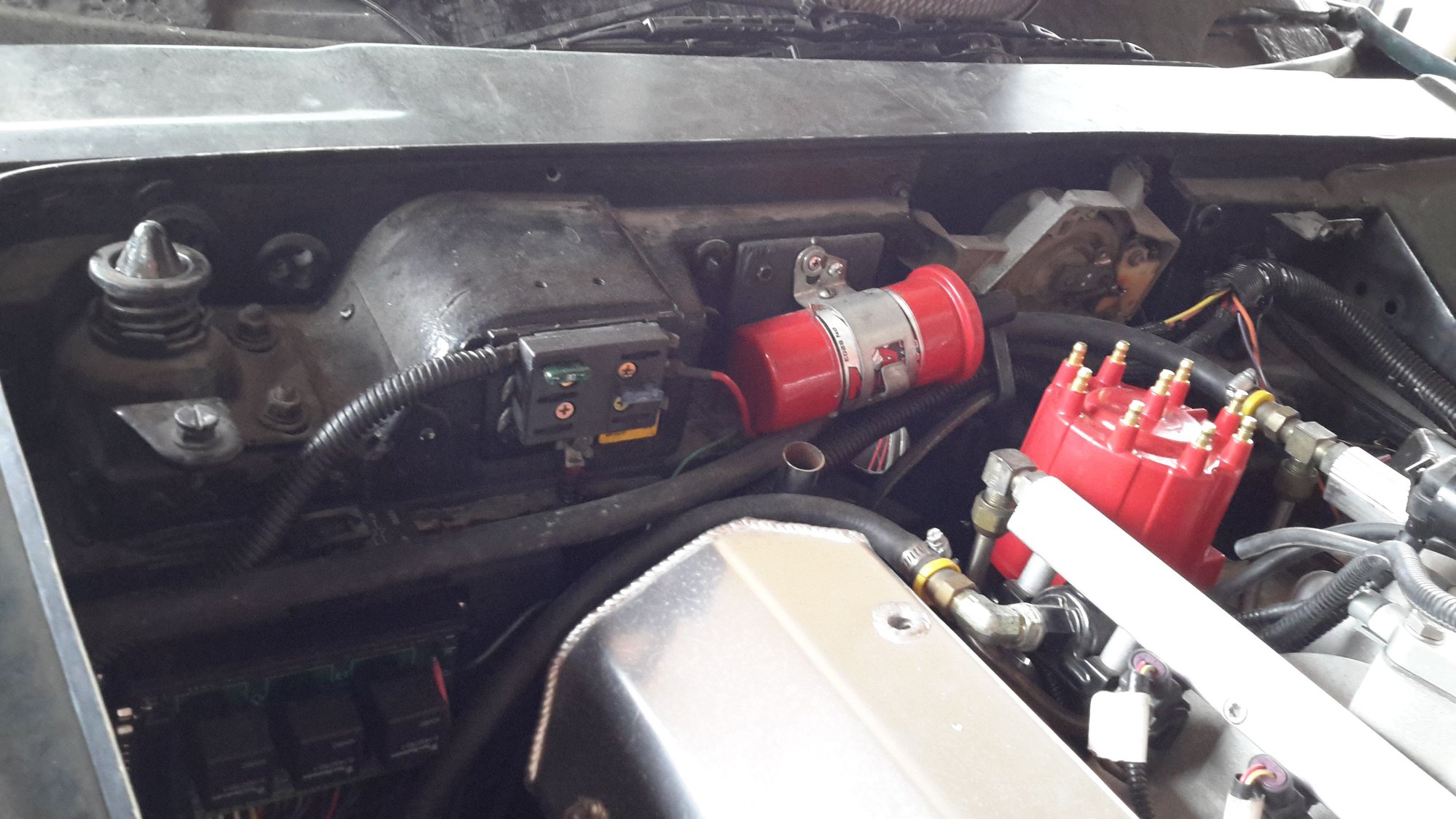

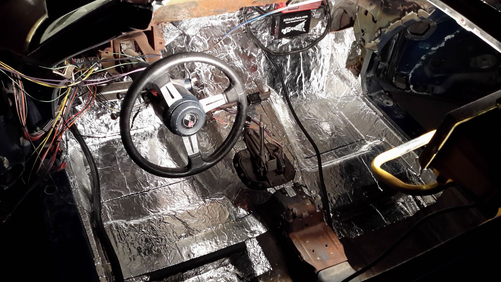

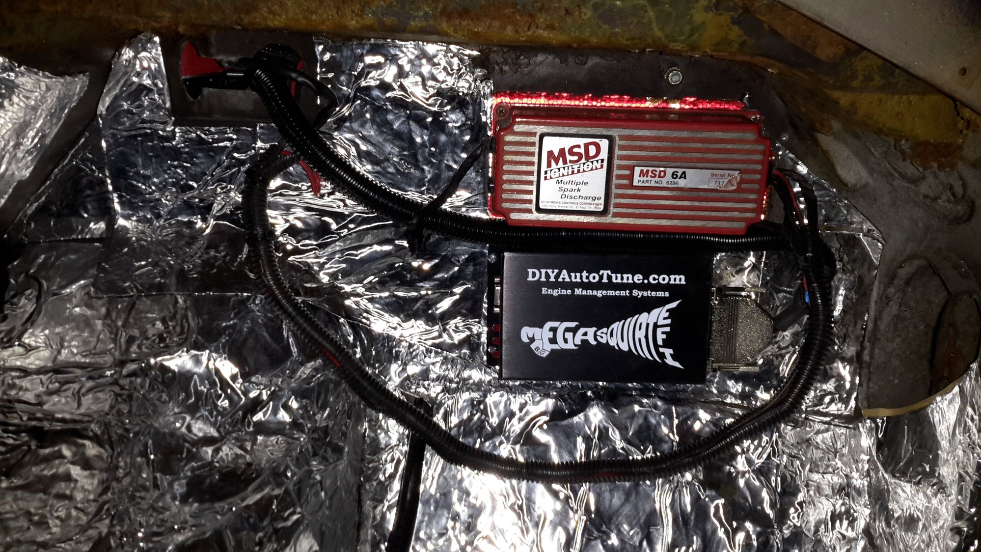

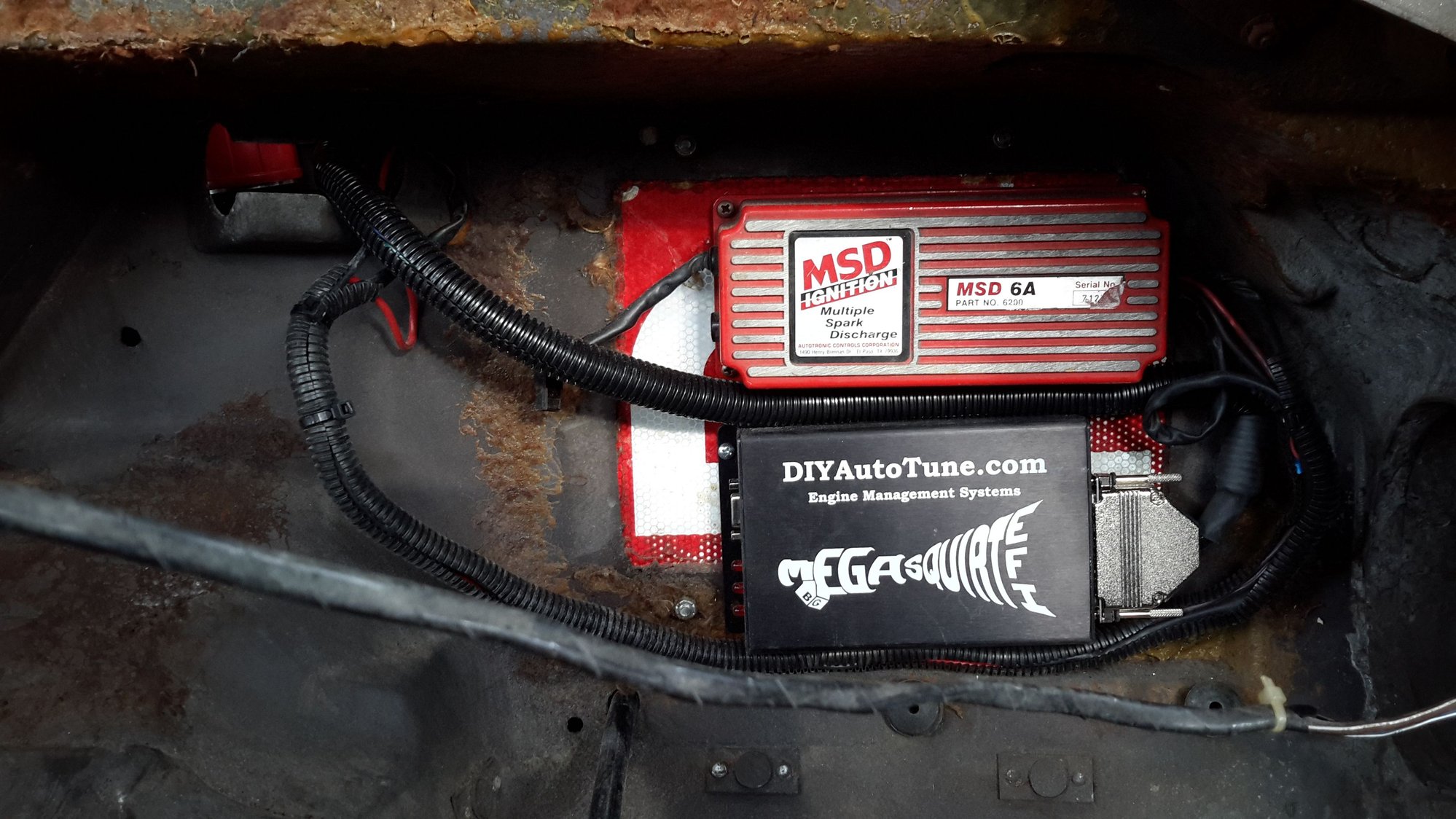

Recently installed the MSD and started with the dynamat. 10 sheets wasnt enuff. Im going to order another 100 bux worth tonight.
Also got my newly built Megasquirt setup and relay board installed.
Decided to take it back down and put some behind it.
I put an extra fuse box here. Oh, I forgot to mention the painless wiring kit.

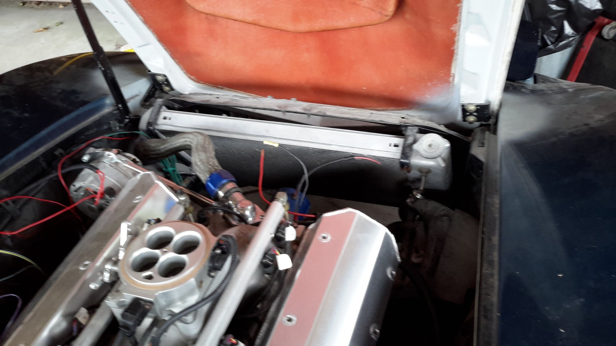

Hood clearance was a challenge. I want a fairly stock L88 look from an exterior glance. Ive got a 73up long hood instead of the wiper door assembly. I think Id rather the wiper door but I dont think Im up for back tracking at this point. Anyways, the drop base L88 air cleaner lid is hitting in at least 3 spots. Throttle linkage and IAC sensor for sure. So, modifying that is a must.

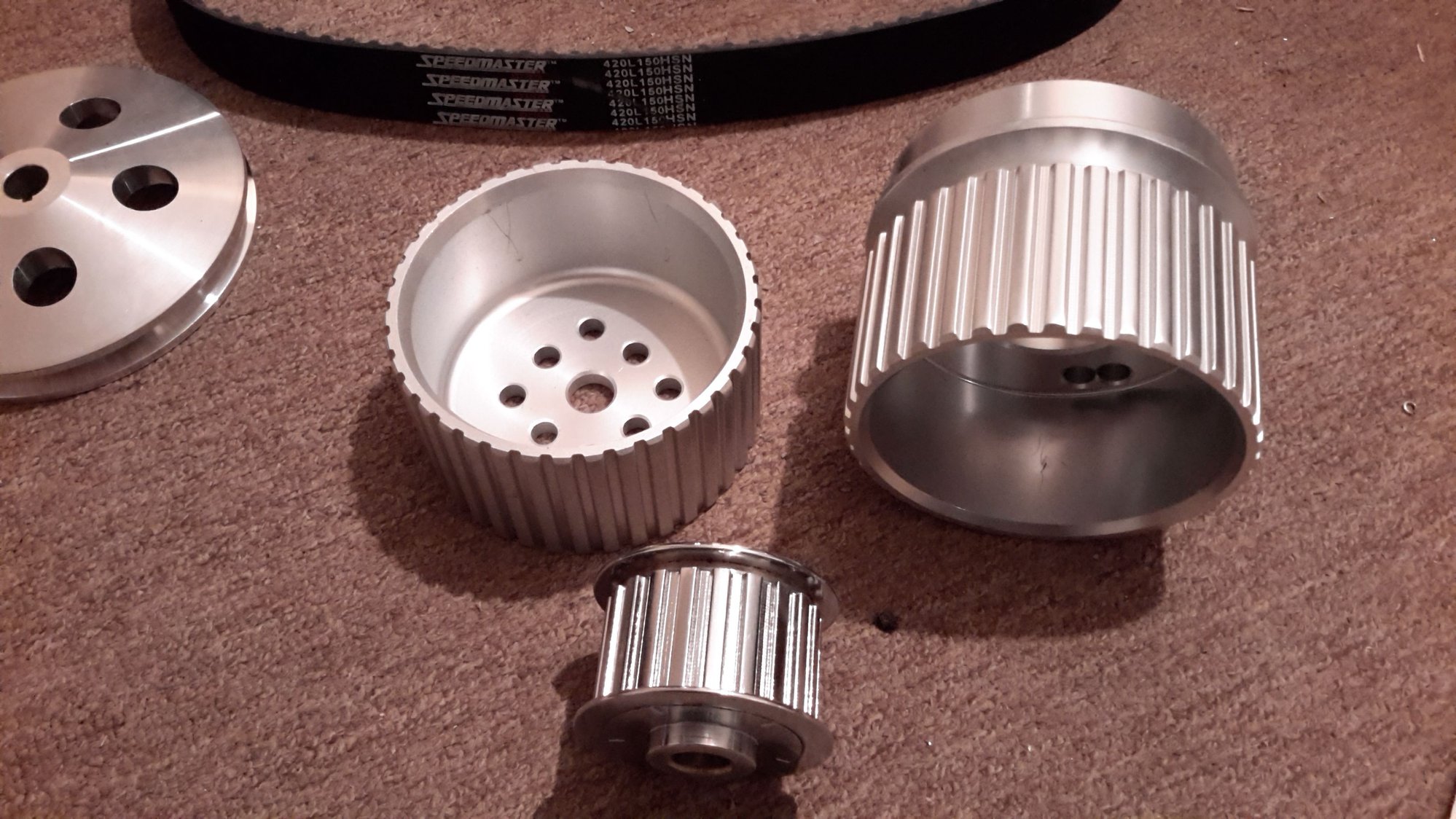

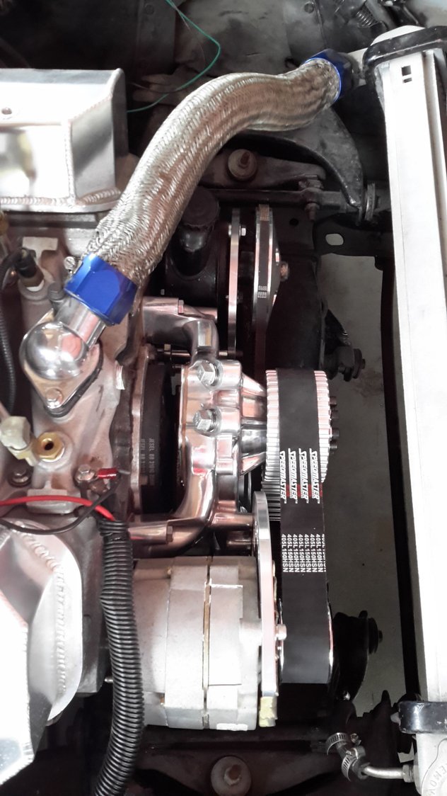

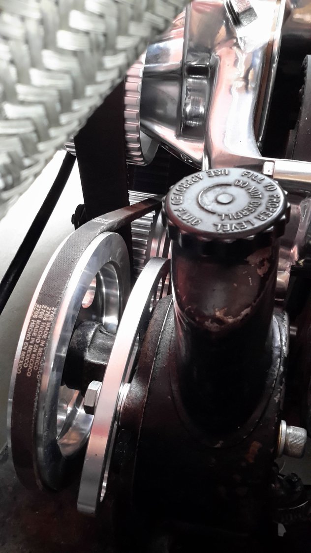

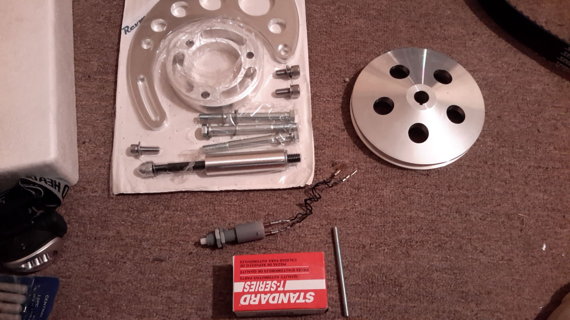

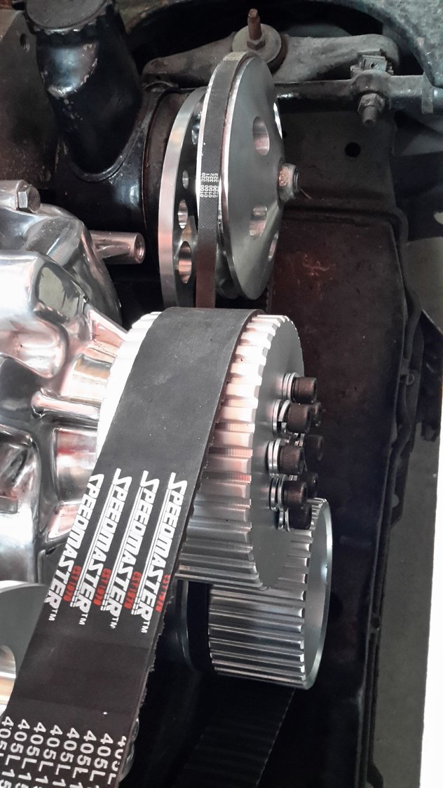

Gilmer belt drive.
Alternator bracket and new power steering pulley.

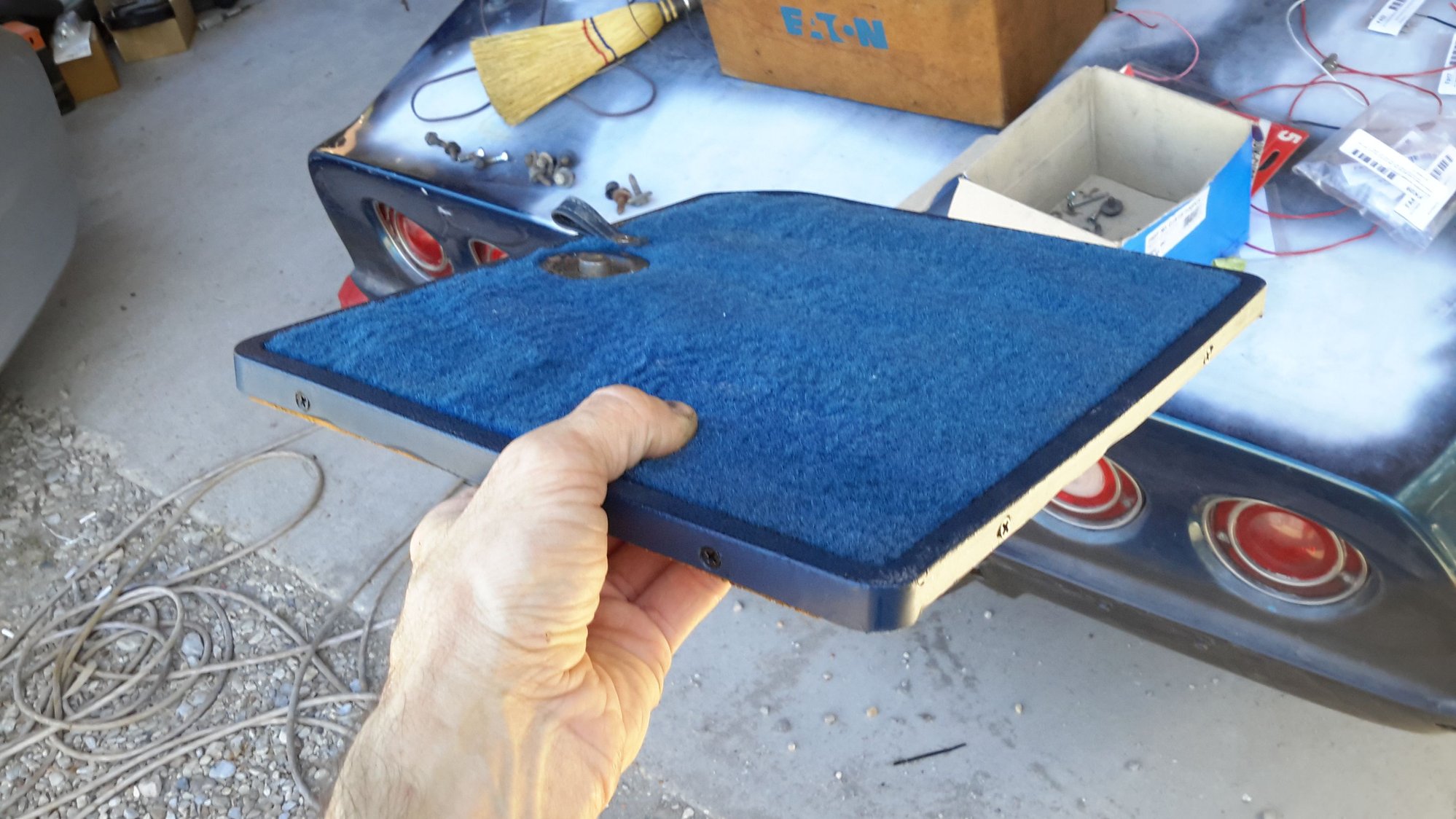

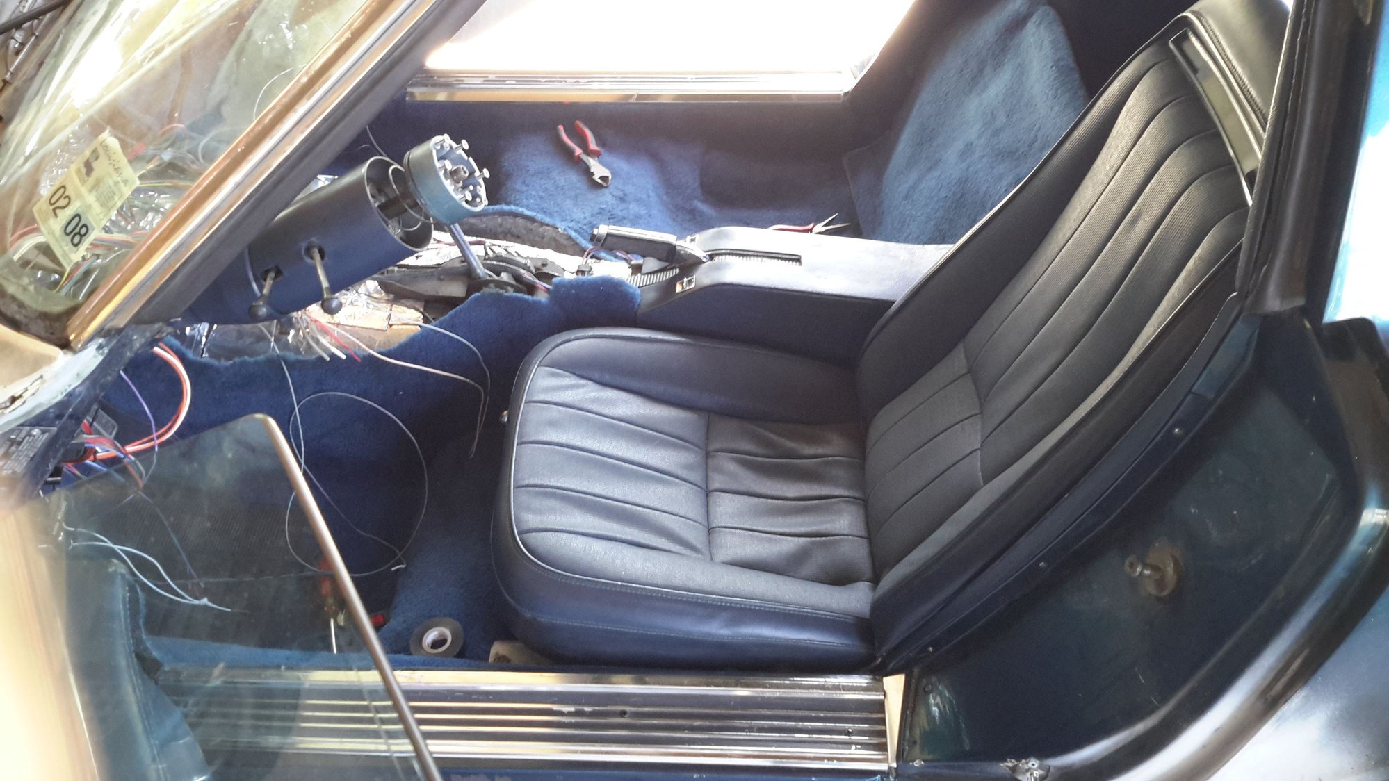

Dynamat finished, carpet is in, waiting on interior screw kit. The ones I could find were rough.
Switched to a mechanical long water pump.

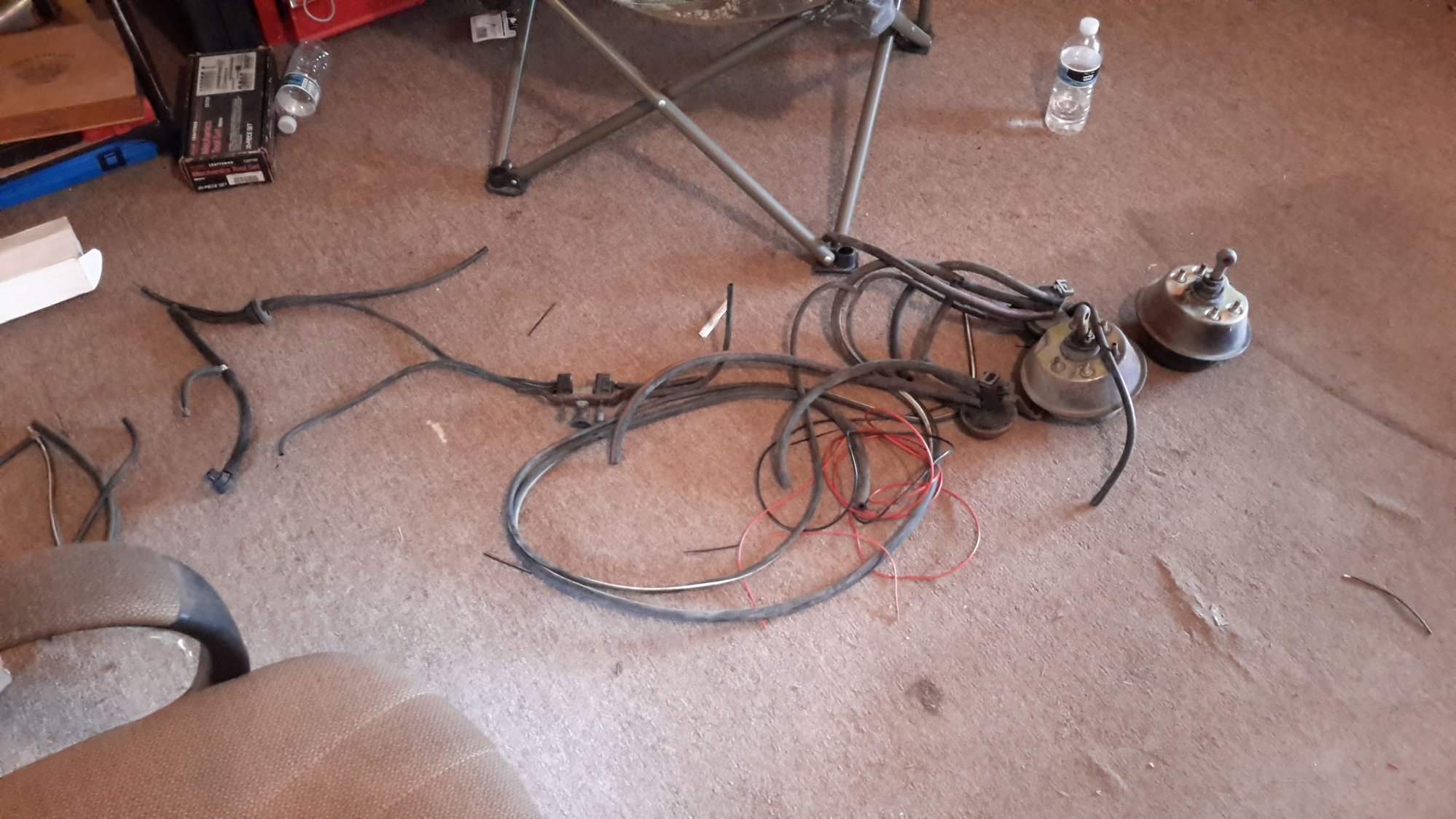

Finished the headlights, installed the vacuum actuators and lines.

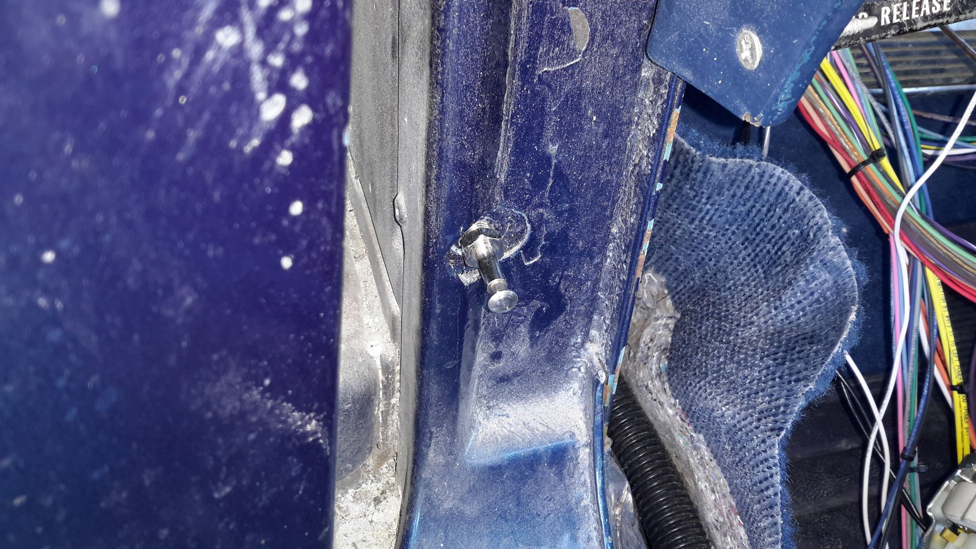

Finished courtesy light switches.

Finally, the hood closes!

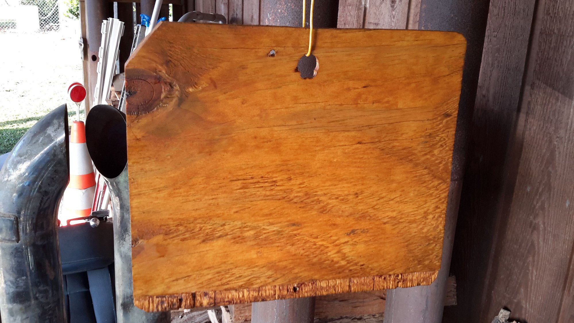

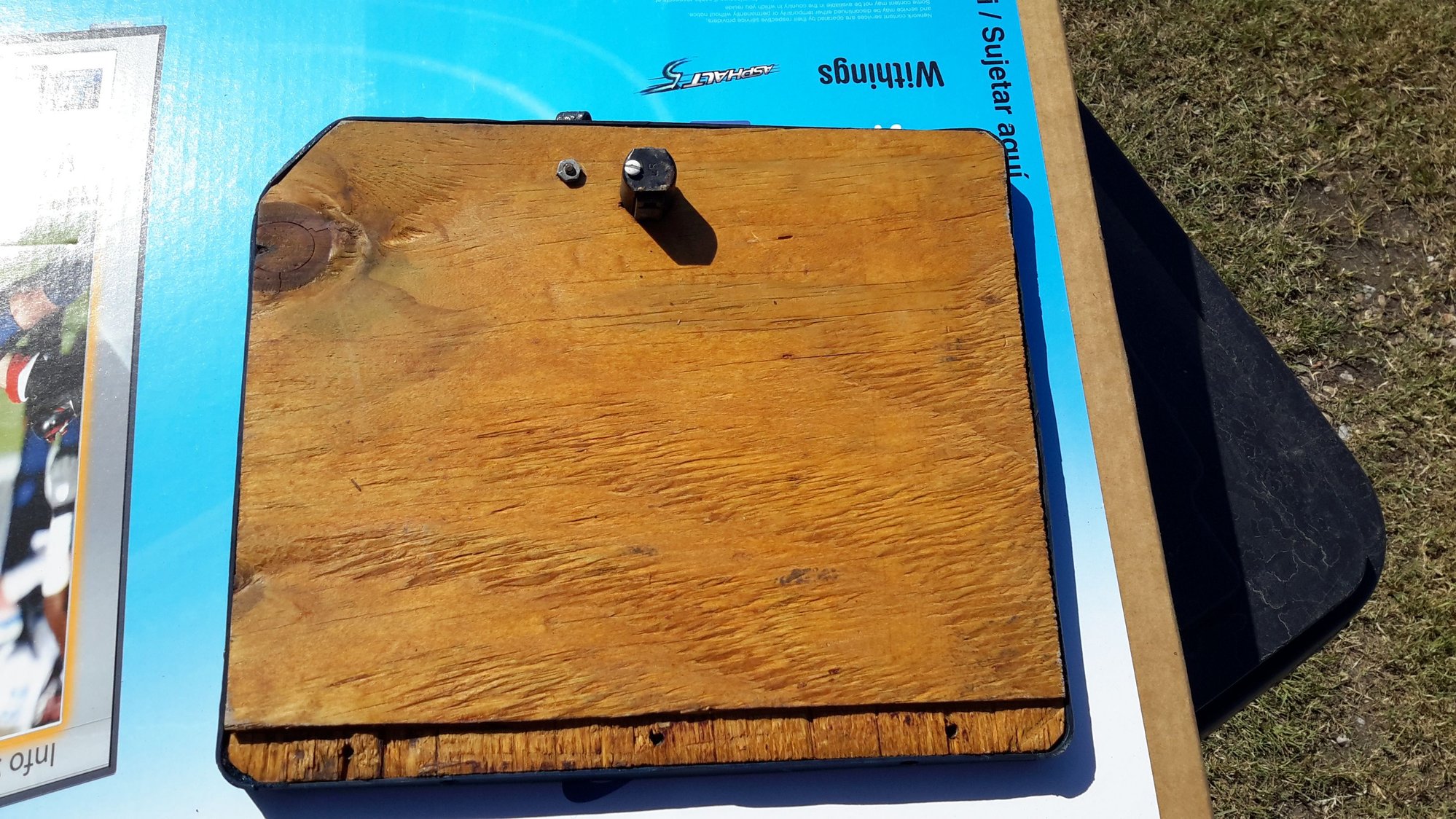

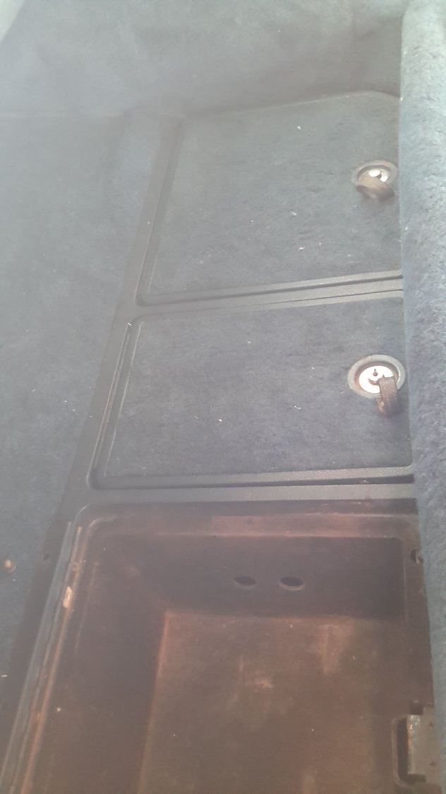

Im working on the interior. Starting from the back. The lid for the passenger side box was falling apart so I replaced the wood.

I also dislike those annoying blue xenon bulbs you are referring to. These are halo lights. The blue rings around the headlights turn on and off separately. I only plan to have them on while parked for show. The headlights them self are not blue, but a pleasure white/yellow color. ☺

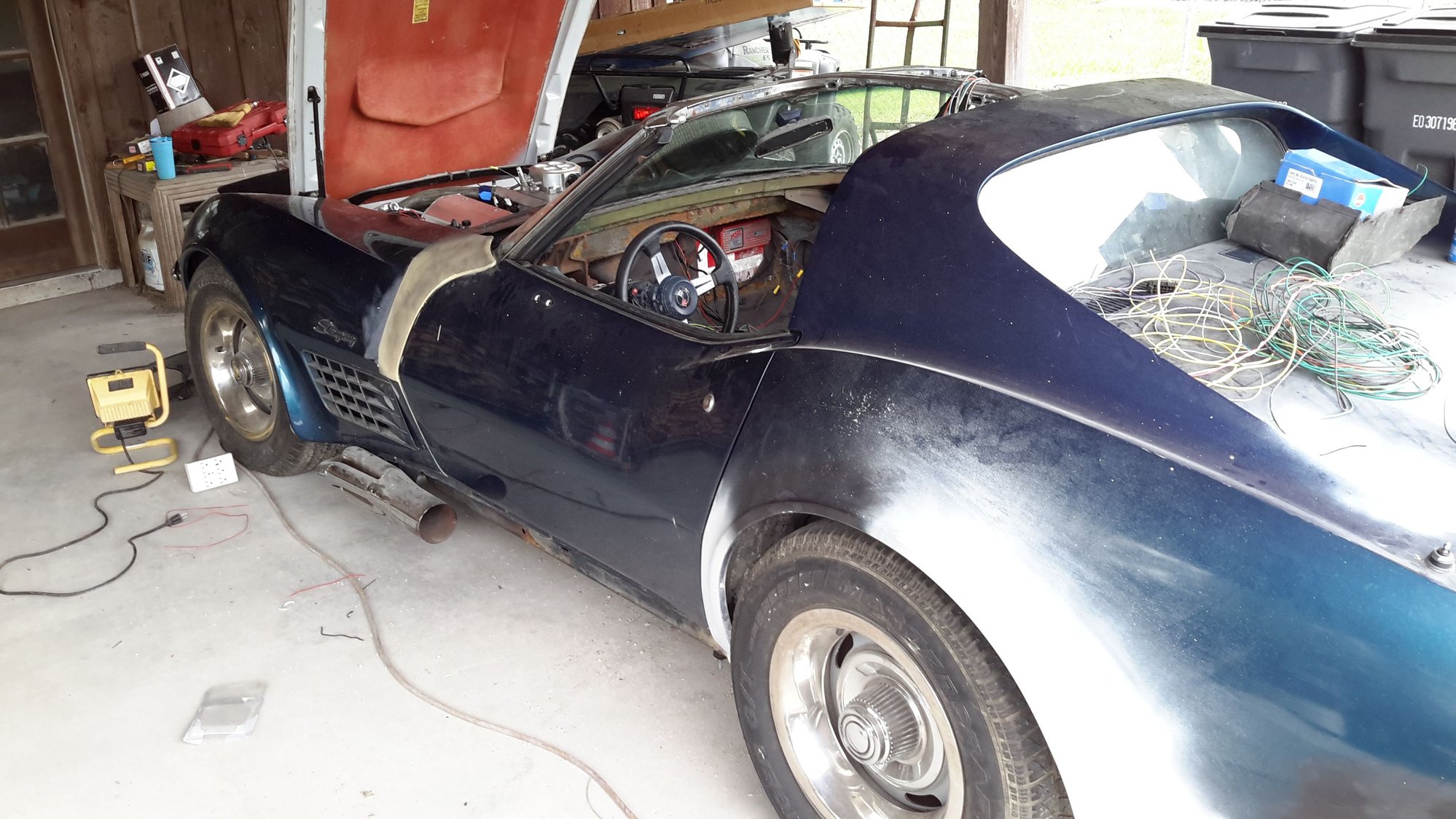

Ran out of black spray paint. But plan to hit this.

Mocked up the brackets and pulleys. This is gonna work.

Question: Does the Gilmer belt system make a lot of noise when running? Like a supercharger belt sound. Have you actually run it yet?
