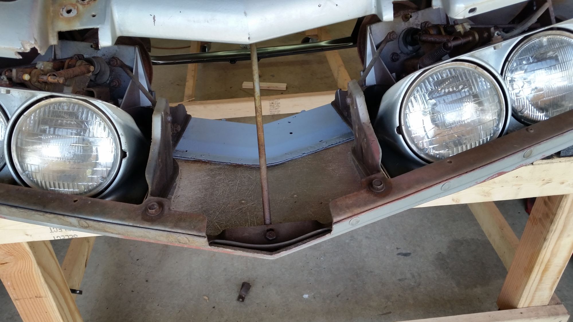

I think the 1st pic is RVZIO's '69 grill.........
This is Sigforty's '70 grill..........................
They both have a single support rod that attaches to the underside....(the "horsecollar" brace was removed for cleaning/re-painting in each pic

Yup, That's my clip upside down and it is a Nov.68 build date for my early 69!
