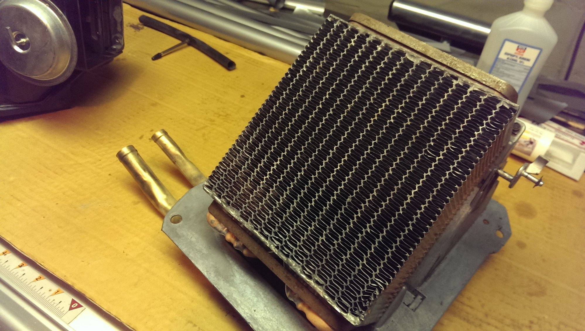

I just received a replacement heater core from Paragon Reproductions yesterday - part number 5770.
It seemed like a good idea to test the core first before going through all the work of re-assembling the interior.
I used a 700 x 25c bicycle inner tube cut to a nice length to slip over each tube. Secured with a tie wrap on each.
The first attempt to pressurize the tube (I was aiming for 15psi) caused the unsupported tube to explode at 10psi.
So, repeat procedure on a new tube, fill a basin with water and pressure test the core at ~ 10psi.
The joint where the larger (3/4" I think) tube joined the core showed a lot of bubbles indicating a leak.
I just wanted to share this with you all - it's a lot of work to remove and replace a heater core in these cars. Best to test it before you put it all back together.

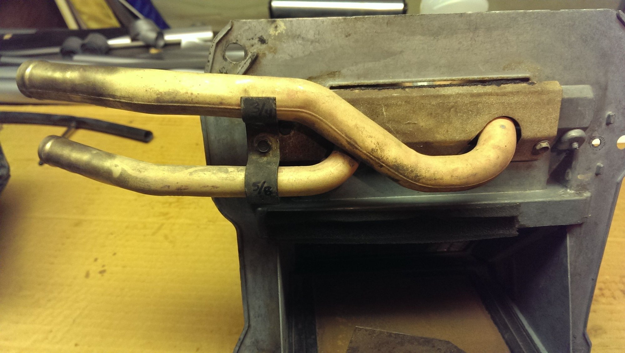

Update - I took the heater core to Greenwood Radiator and discussed with the owner my options:
1. Return the core and try again - would still have fitment problems with the tubes and cradle not lining up requiring some bending to make it fit.
2. Build a new core from components he can order. ~$200
3. Attach my end cap with tubes to the new core, and solve the problem with fit, and hopefully the leak. $60
I went with option 3 and here is the new core attached to my old tubes. He also pressure tested the core at 20psi for an hour with no leakage noted.
The core now fits in the housing great - and I don't have to stress the solder joints assembling it all.
I hope this information helps.
