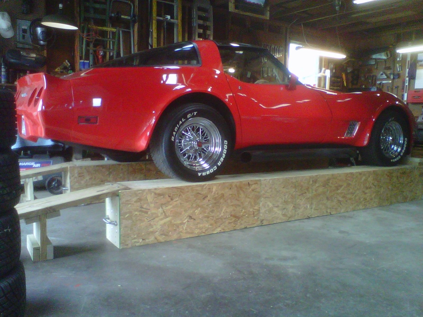

Built these:
http://corvettec3.ca/ramps.htm
Also have a set of plastic ones. Old rubber floor mats under inclined end keeps them from sliding.

Allen I would like to build a set of ramps like you built but I only have two car garage with no room to store them. I saw them on another post some tome back and thought they were a great idea. I have no room down the side of the garage to store them.

Very nice.

I used all pressure treated for the ramps and internal support. Where the OSB is on the sides, I think that, if you used marine grade or treated plywood for the sides, you could probably store them outside with maybe a tarp over them, as long as you had some something under them to keep the bottoms from direct ground contact. I've used them in the driveway as well, to pressure wash and clean the underneath. Since I have gotten older, I get motion sick if I am on a creeper even a short amount of time (go figure, learned after I bought a nice one I had been putting off for a long time) so these work great for me. YMMV
