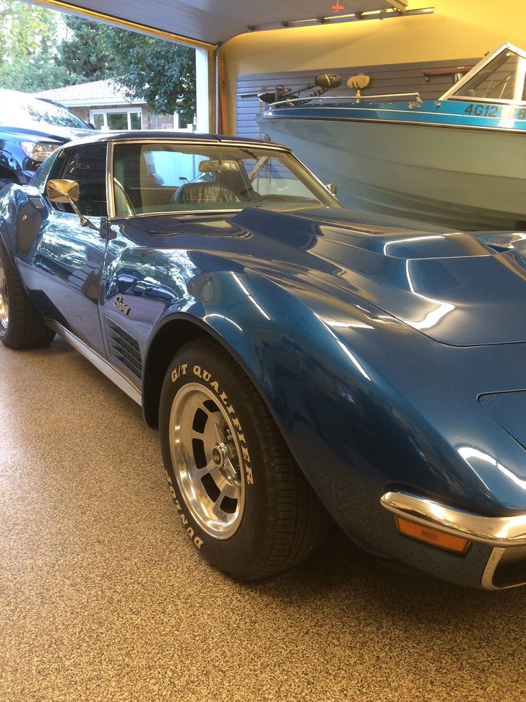

My floor is just like Rcdizy's, same color same amount of fleck.
Love the floor, stands up well, cleans easy.
One issue with the fleck. With that much fleck if you drop even a 1/4" nut or washer, cotter key etc, it is really hard to find.
Had mine professionally done and would do it that way again. far less time to get it done and have everything, tools etc out of the garage.
