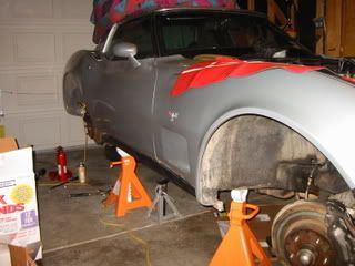

http://s437.photobucket.com/user/ton....jpg.html?o=21
I don't know what you mean by a puck for a C3, but go for the good floor jack like people mention and also go for BIG heavy jackstands. Mine are ~23 inches high on the lowest setting. Transmission can be easily pulled with these stands so it's possible to do just about anything you need to at that height.
Notice the little gray "heavy duty" jackstand normally sold at auto stores, it's by the rear orange jackstand.

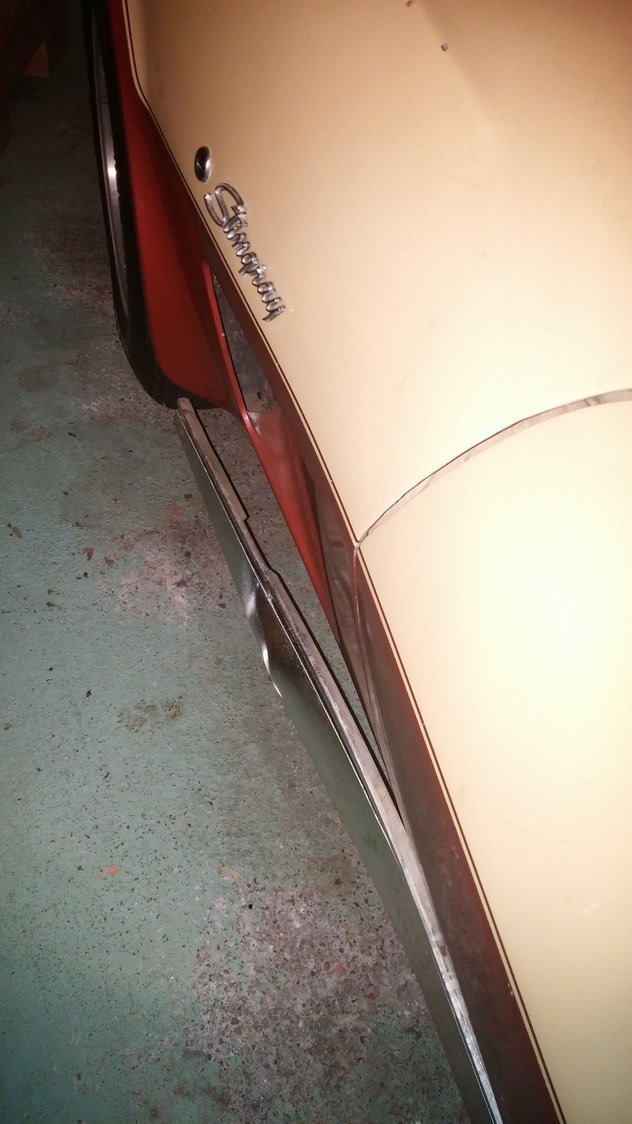

Originally Posted by Isaac Im
...Just the trim thankfully
My '76 came with the right side lower trim dented when I bought it. Not sure what the previous owner did but it looked like it was caused by improper jacking.
At one point when my car was at the shop and up on the lift, I took the opportunity to remove the trim off the car and with the help of a heavy hammer, a couple of big screwdrivers and a chisel, I was able to reshape it well enough that it is hard to tell anything ever happened to it.
I did find a used undamaged one on eBay and I paid around $100 for it. But, since it needs to be polished and the original looks ok, I have not been motivated enough to have that taken care of as of yet.
I think that with a little patience (and the aforementioned tools), you may be able to reshape yours to an acceptable condition.
Just my .02.
Glad you're alright. Nothing teaches us better than a good scare.
Here's a pic of my car the day I got it. Notice the folded bottom trim piece right behind the front wheel.
And here it is after I straightened it.
Not the prettiest, but a LOT better.

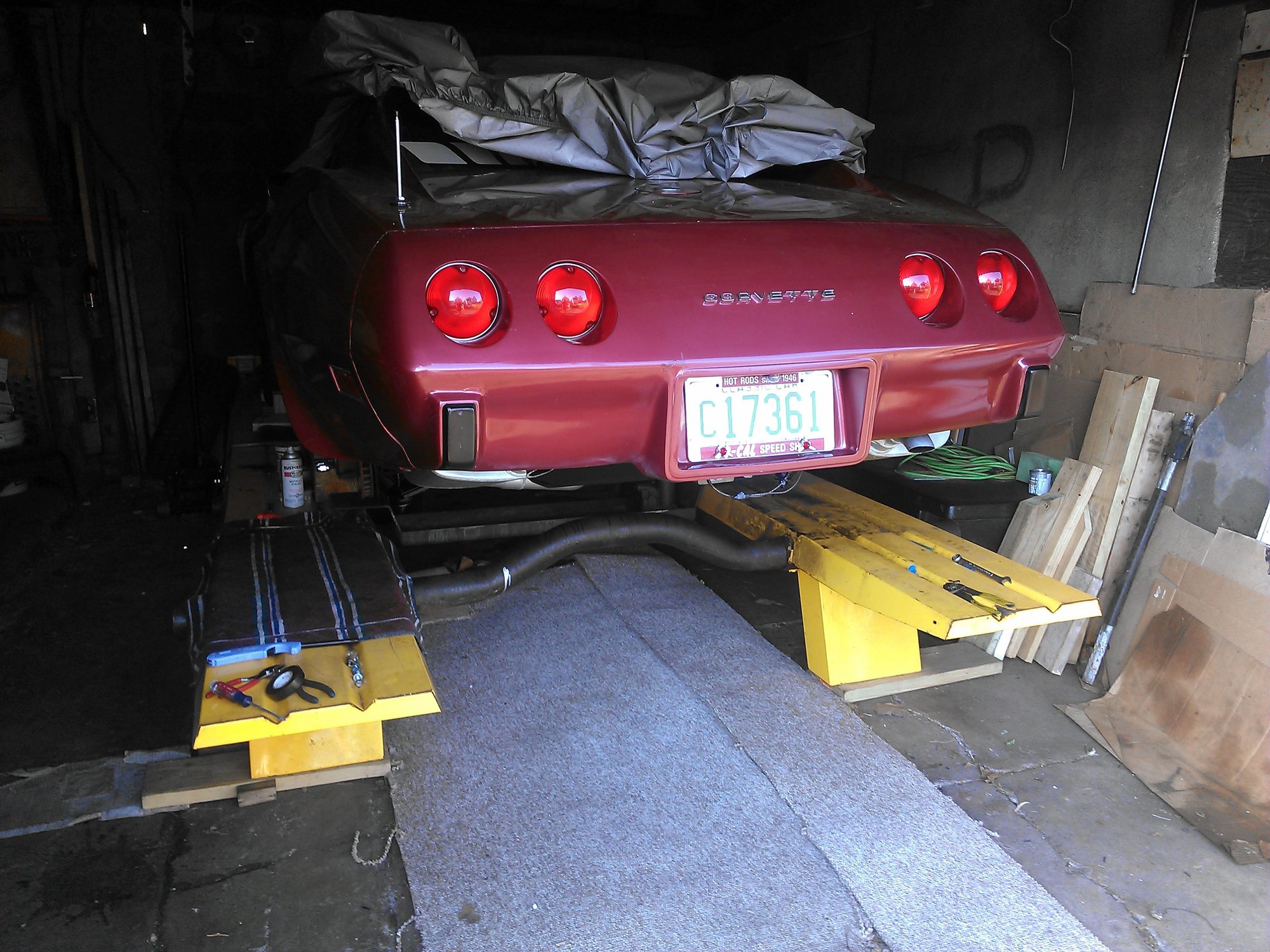

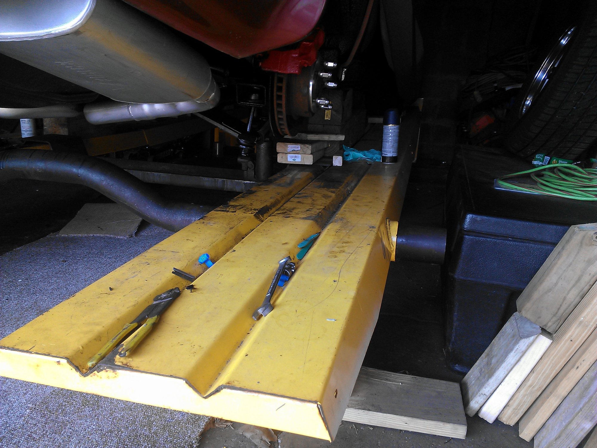

These friggin cars are the worst to jack up........there is a member on here selling a Kwik Lift............safest piece in he world to hold that car in place when you work on it,I had mine for 5 yrs..........NO problems...I want to live a few more years in this ^&)*#@ world,not expire under a car!
Sorry...garage ain't pretty....just work in it!
