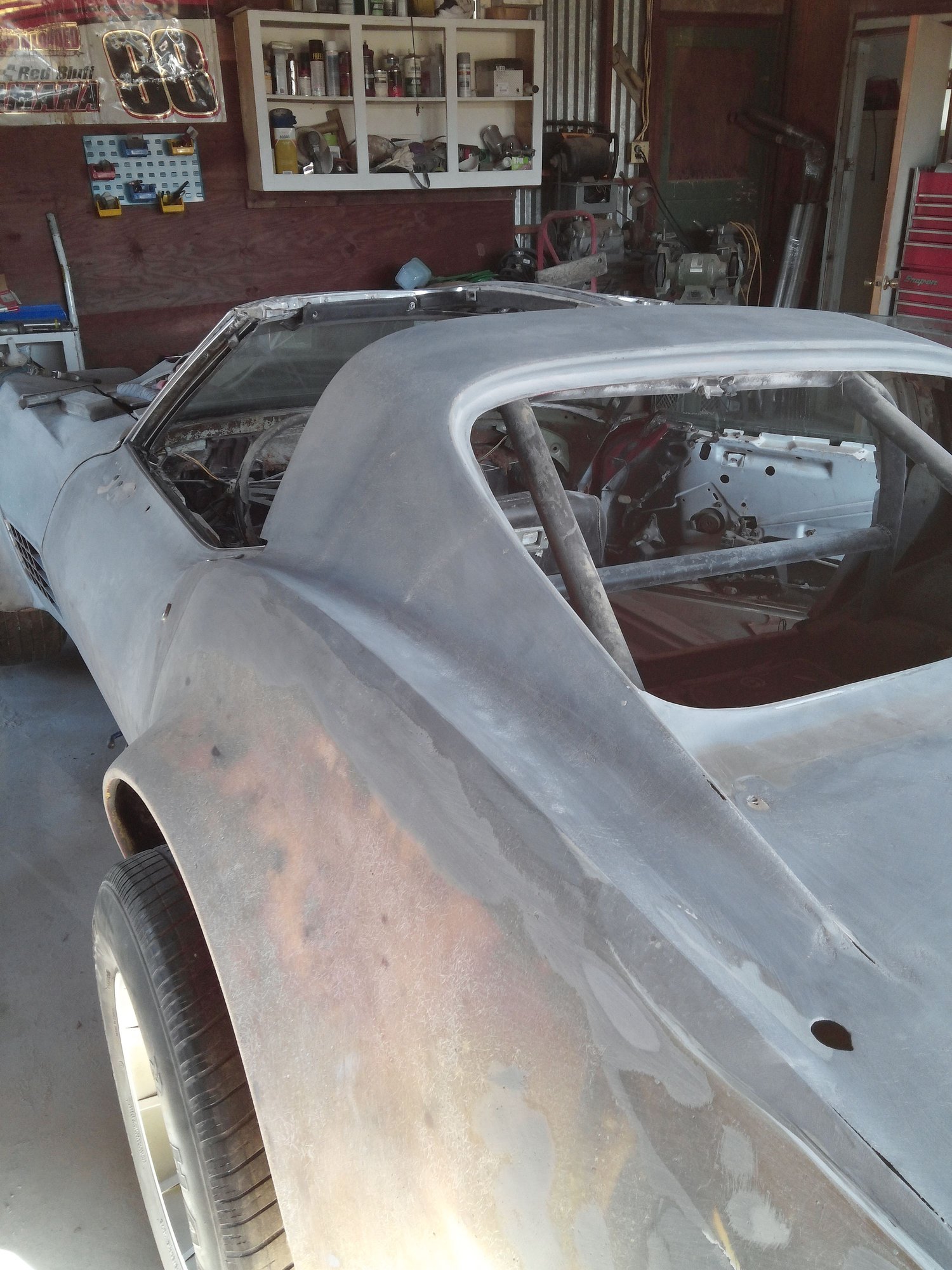

I have a 4" flare with a 2" spacer and 10" wheels .Outside measurement is 77 1/4 " when sitting on the ground wheel is just under fender

I don`t know where they originally came from (this car was in storage for 29yrs) but these are huge and look like they would cover a 12" easily, the L-88 flare on my sig pic #1 below came from a John Greenwood body mold and will easily cover a 10"

Those flares are not blended well. I want to make sure it looks like one piece fender. Not sure if the l88 will work for that
