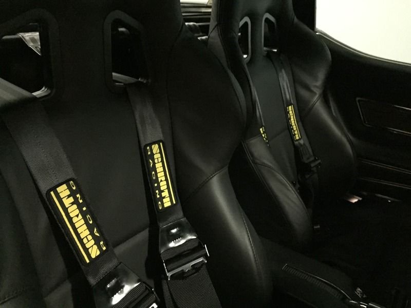

I apparently never took very good photos of my seats, installed. I am 6'0 and fit in the car fine with no helmet. Once I add my helmet it is really close to the t-top liner but I do still fit. I recently found that my helmet cracked the liner so it very well may be coming out before next season.
It could just be the angle of the photos but mine do appear to be slightly lower.
