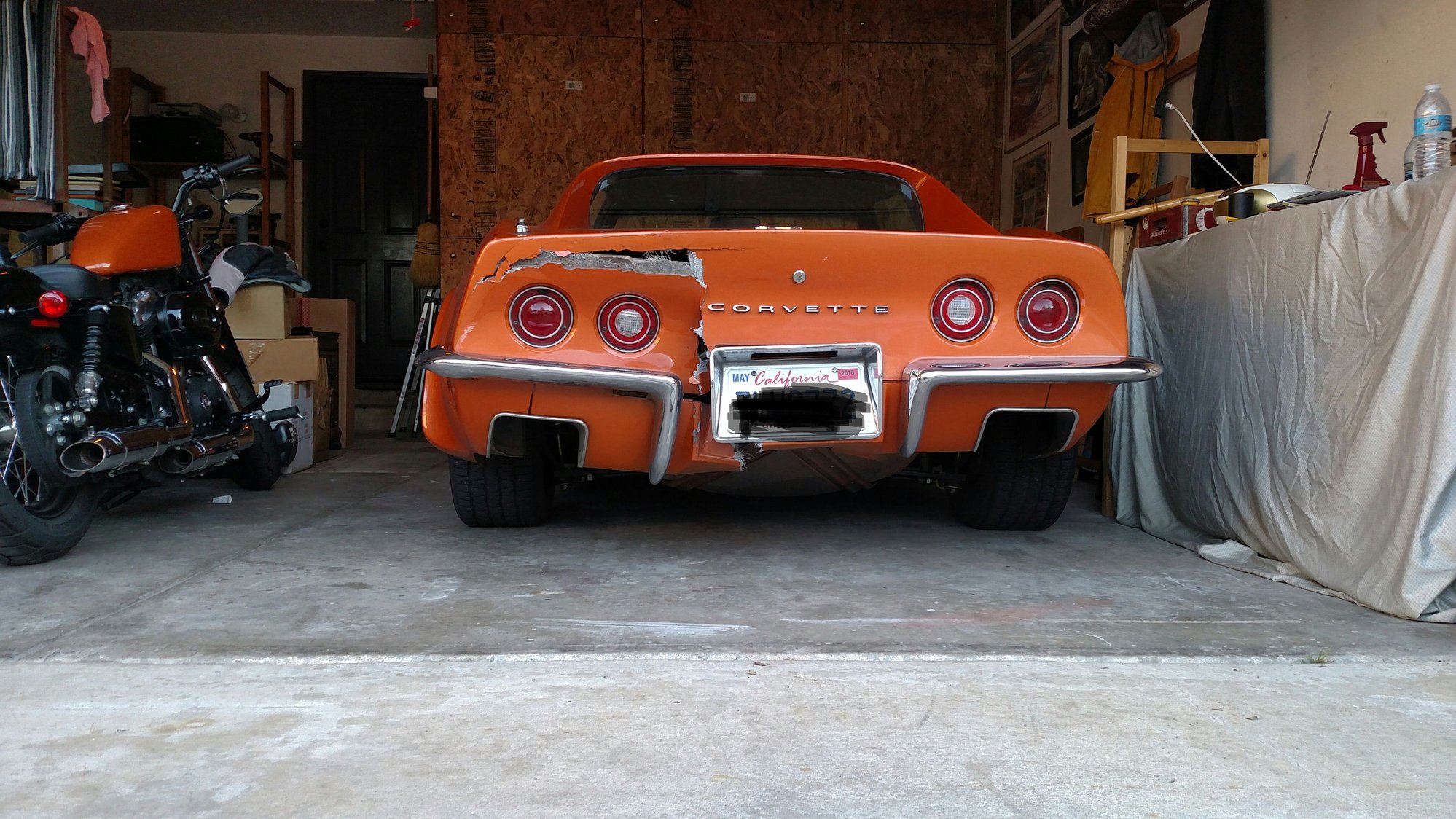

Well it finally happened, my first accident. I was stopped at a stop sign waiting for some traffic to move and I got hit from behind by a young lady on her phone. No one was hurt and I was able to limp home but despite only a bent front plate on her car my baby didn't fare so well.
I was up in LA this weekend and stopped by J&D Corvettes. Anyone here have experience with them? They had a 69 in there that was also rear ended. The repair looked awesome but the guy chose to have the whole car resprayed and I'm not sure that's in my budget right now. Not to mention it's just under two hours away from where I live. I do like that they know Vettes and I got to see their work firsthand. I brought pics to J&D and the guy basically told me it'd be a close color match and they would blend it but no way it's gonna be a 100% since it's not a true factory color. It was resprayed Ontario Orange with a pearl coat sometime before I bought it.
I'm bummed, pissed this happened. It wasn't a desirable car, just a base model. But now it's a base model that's been hit. One that's going to be two colors. It's gonna be in a shop for a couple months. I hate the idea of having to pay to have the whole car done again later when the back part is gonna be paid for by the insurance now anyway. I love the Ontario Orange but I've always wanted a blue car. Sigh...... Can anyone here suggest a body shop in SOCAL? USAA's shops won't touch my car and I get to pick where the car gets sent. I need some options.

Whose insurance is being used? Hopefully it's the girl's. If so, insist on the entire car being resprayed. Go to a chiropractor and start documenting your whiplash symptoms. Tell the adjuster you will need to get your lawyer involved if they don't work with you on the repairs. All you want is your baby returned to her pre-accident condition. Be prepared to fight to get it that way.
On the other hand, if your insurance company is handling it there are more things to consider. When I had my 98 coupe, somebody kicked up a tire tread on the freeway and it hit me hard enough to crack and chip the paint on my bumper and hood. I had to foot some of the bill to get the whole front end re-sprayed, rather than just blending the area affected.

Be sure there is a clause in the estimate for hidden damage, you are going to have some.
Rearmost crossmember bent.
Left rear splash shield
Front of spare tire tub hitting differential
LR fender to rear deck bounding seam
Rear deck to tub bonding seam
LR quarter to lock pillar panel bond
Tail light wiring harness
Exhaust panel to LR fender bonding strip (small but expensive)
Tail light to deck bonding strip
Open the gas lid and see if the tank is shifted
Mike
