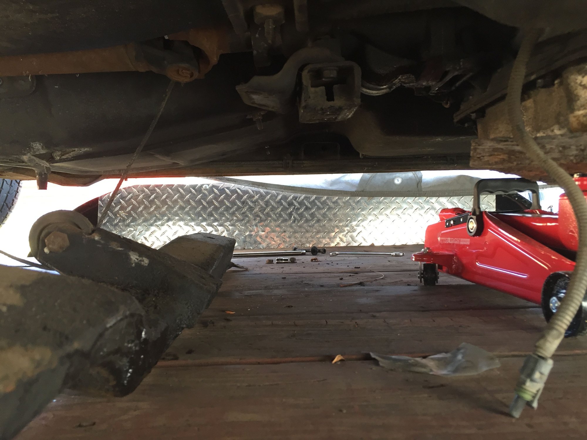

Ok I have to turn around my crossmember since it was installed backwards and isn't letting the trans connect to the engine properly. I disconnected the two bolts on both sides yet I can't get it out. I lifted the trans up on a jack since I'm doing this on the floor. The trans is not connected to the crossmember but I'm having a hard time getting the crossmember out. Does anyone have any suggestions to help me out?

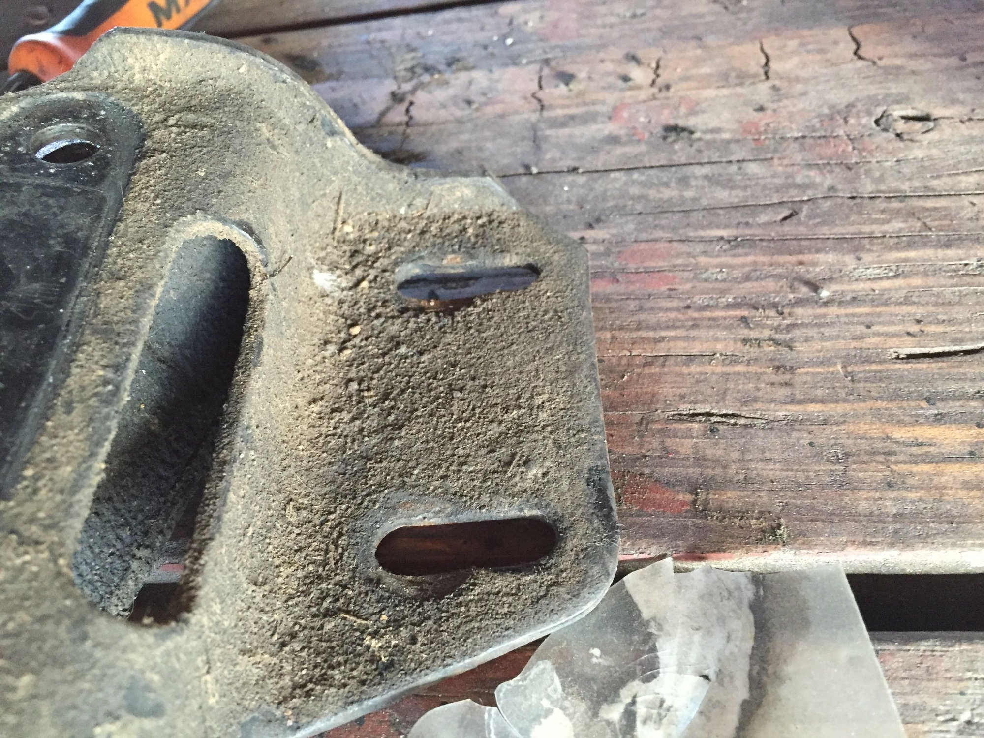

Ok since my transmission isn't hooking up to the engine I finally got the cross member down and you can clearly see the mount is backwards. Once I turn it around do I have to turn my crossmember around too or is it facing the correct way already?

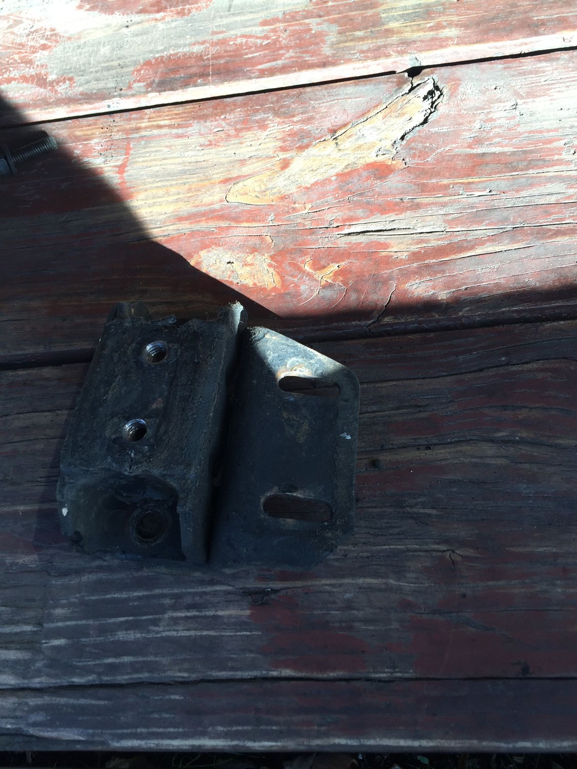

Ok. So how does the trans mount go? My stupid manual doesn't even show the set up

Which way does the mount go?

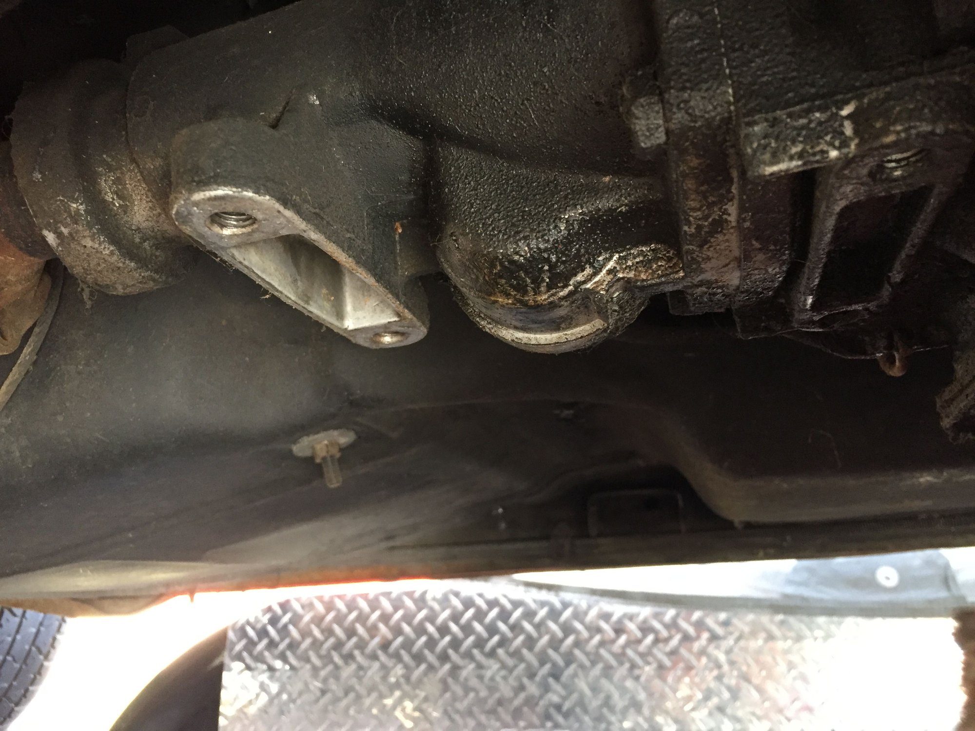

On the second picture isn't my mount bracket suppose to connect from the left to right in the first picture?

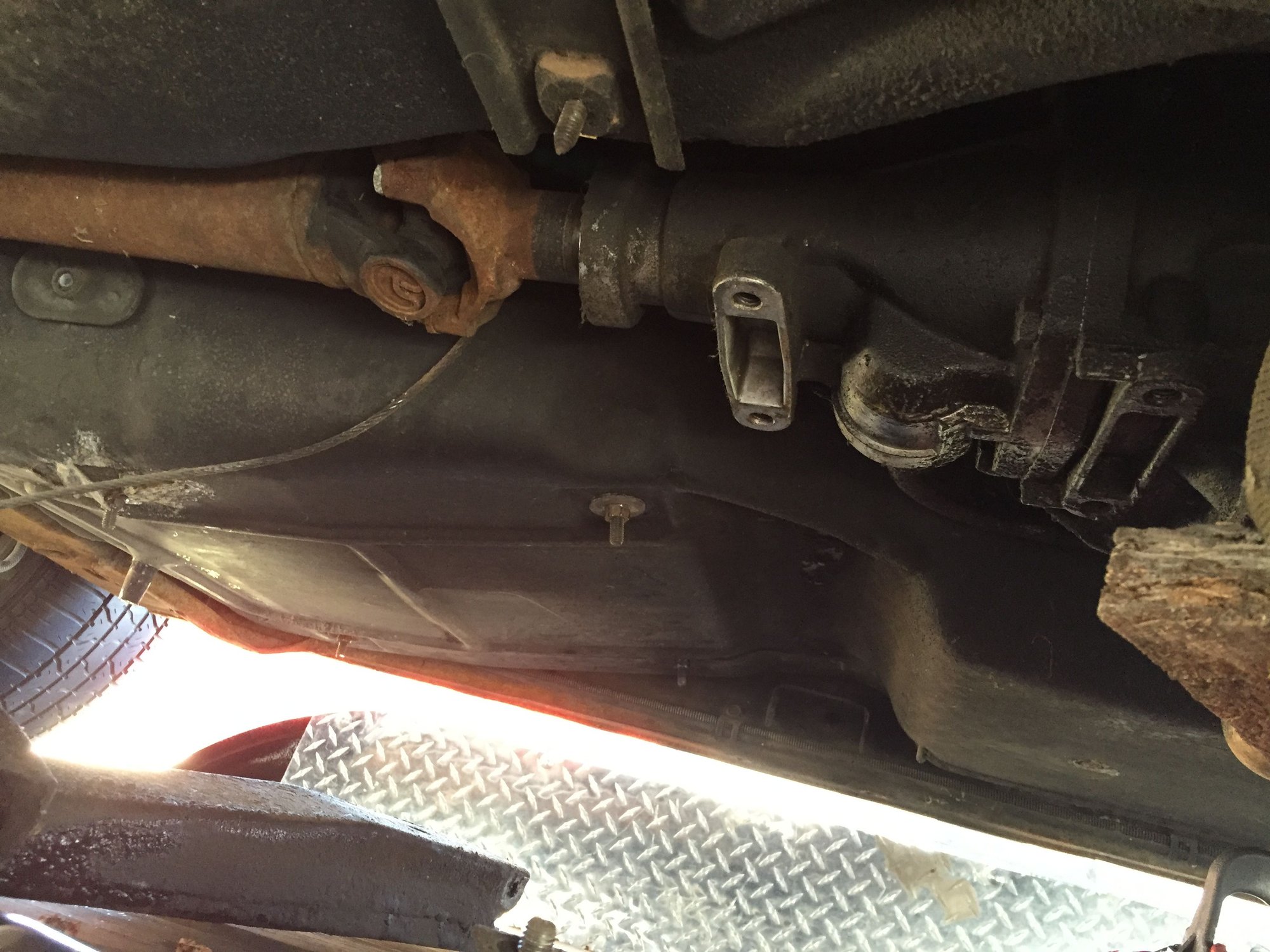

Ok makes sense but how do you later it on the crossmember? Is it bracket mount then crossmember or mount bracket then crossmember? I have a 82 with the original 700r4. What connects to the holes right behind the oil pan? Cause the mount connects to the holes near the drive shaft.
