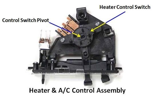

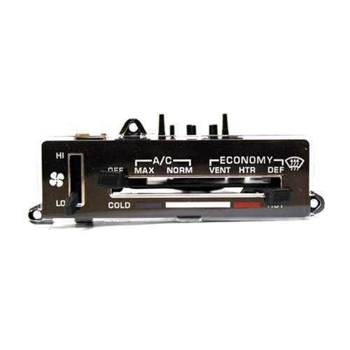

Dewitt, with the car running, check for the sound of a vacuum leak in the vicinity of the Heater & A/C Control Assembly on the center console.
photo courtesy Paragon Corvette Reproductions
https://www.paragoncorvette.com/p-36...-assembly.aspx
The Heater Control Switch has a plastic Pivot that holds it together and if that pin breaks (mine did in about 24 months when new) you will get a vacuum leak and the controls will not respond to input.
https://www.paragoncorvette.com/p-35...ol-switch.aspx
If that is the case, just access it through the passenger side of the console by removing the cardboard trim panel and replace the pin, or the Heater Control Switch and you should be back in business.
Good luck, and let us know what you discover... GUSTO
