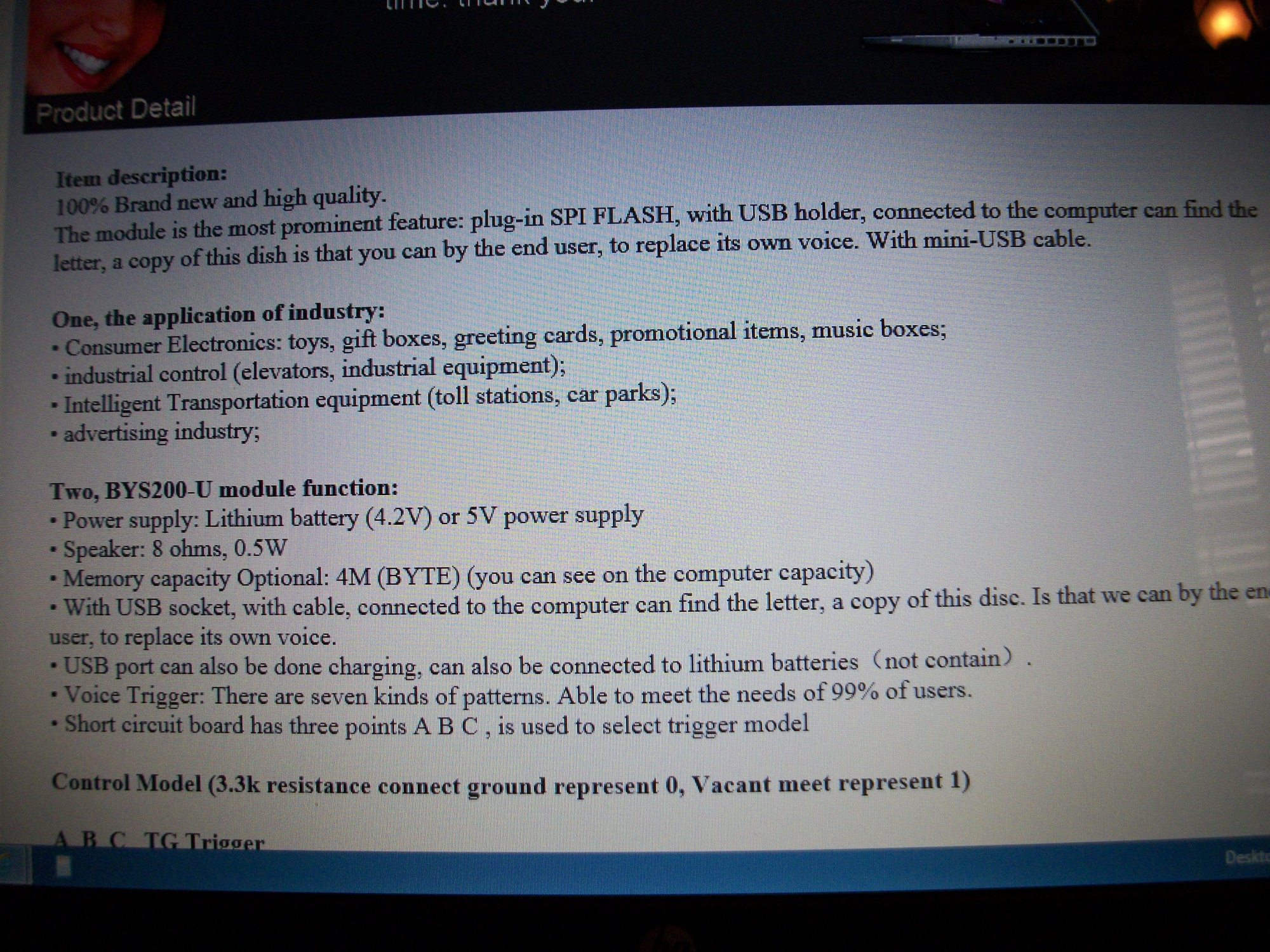

Here you go...
just add an amplifier and outdoor type speaker- USB to load your choice of music-4M memory...Only $10.50
http://www.ebay.com/itm/Y-USB-MP3-Module-for-greeting-card-gift-box-soundboard-music-cards-musical-sound/262197794017?_trksid=p2047675.c100005.m1851&_trkparms=aid%3D222007%26algo%3DSIC.MBE%26ao%3D1%26asc%3D34493%26meid%3D98ea4d2adfde4347a2d2940437b66be1%26pid%3D100005%26rk%3D1%26rkt%3D6%26sd%3D271915191423

I think the module on EBay operates on 5 volts DC......you definitely need to "drop" the voltage into the module itself.

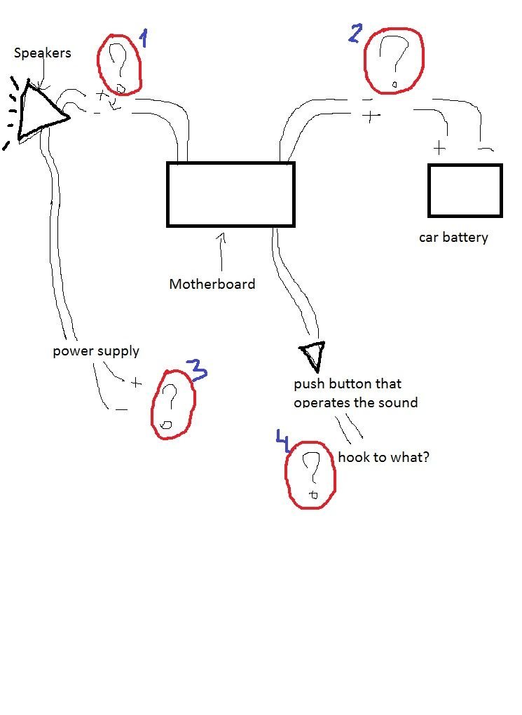

Old Feb 2, 2016 | 03:32 PM
siol's Avatar
siol
Joined: Sep 2015
Posts: 150
Ok guys, I made a diagram cartoon on the problems I need to solve in order to accomplish what I want to do. Can anyone help me in understanding what I need to do, what pieces I need and where to hook it forpoints 1,2,3,4 so that this idea works?
Thank you a lot

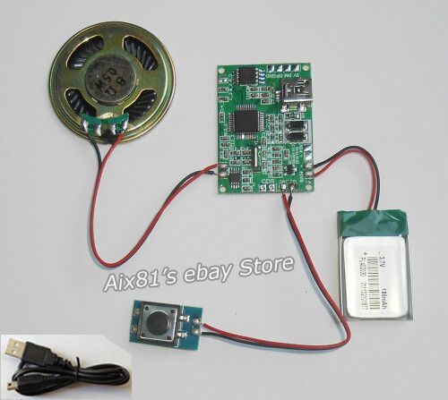

Old Feb 2, 2016 | 03:56 PM
doorgunner's Avatar
doorgunner
2026 Loser of the Year
Posts: 36,600
Likes: 7,046
From: New Or-leens Loo-z-anna
Here's a pic of the soundboard kit. Members can copy the pic and add their ideas.........

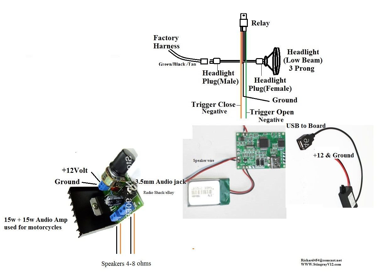

Old Feb 2, 2016 | 08:16 PM
Richard454's Avatar
Richard454
Joined: May 2003
Posts: 8,877
Likes: 3,556
From: Fernandina Beach FL
Here you go-
I use the harness for my electric headlight conversion- when you turn on the headlights -sends out a signal- turn off the headlights sends a signal. Simply plugs inline w/ your low beam headlight- no cutting or switches required.
Audio amp- can be found on eBay-basically used for motorcycles.

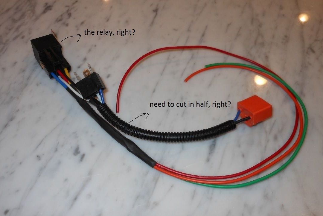

Old Feb 2, 2016 | 10:37 PM
siol's Avatar
siol
Joined: Sep 2015
Posts: 150
Ok, I understood a lot now. But I still have operational doubts.
I got the 15w+15w audio amp.
Also I got the 3.5mm Audio jack
I attach the picture to confirm what I think I understood.
Now I need to know:
How exactly I hook up the relay? I get the basic idea but I need to know specifically which cables go where?
I understand from the female side a little. Is the blue cable the ground?
Where I attach the ground to?
I see the female side and male side have three cables total. How I hook them to the relay?
I don't understand the wiring from the male side, cant see it from the picture.
then, the USB to board...I have to somehow plug to the battery cables, rigth? then to the USB jack in the motherboard?
regarding the 15w+15w amp audio:
what cables to into the +12V ground jacks? and again, where I attach the ground to?
Sorry, I had no clue about electronics till know, but I can learn and I do it fast.
Thank you
Siol.
