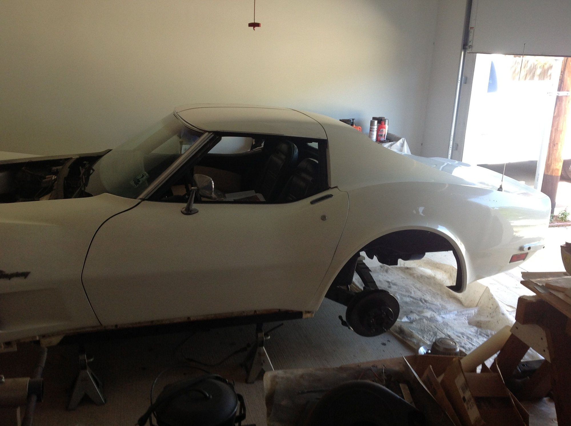

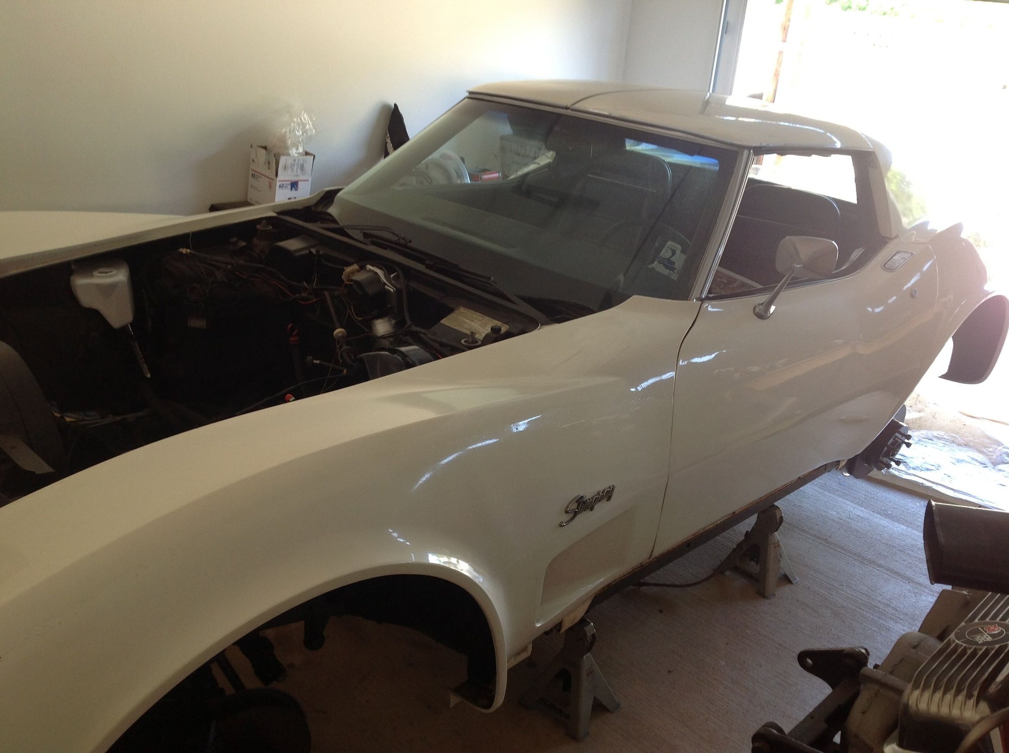

I had my 73 on 4 stands for about 2 1/2 years while I worked on it.
Did keep doors closed while jacking up.

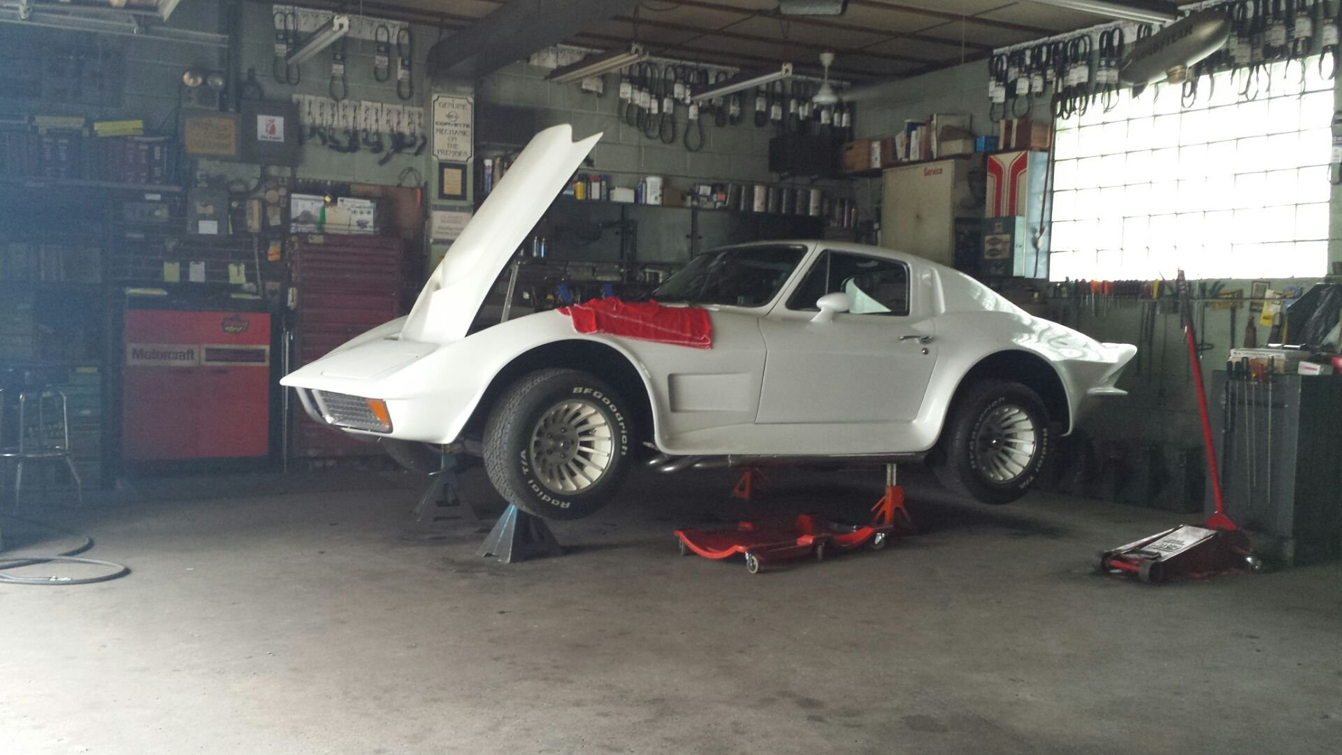

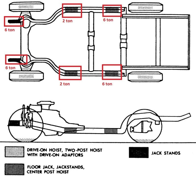

Here is how I have mine on jackstands.....I use (4) 6 tons and (2) 2 ton stands.
Brian

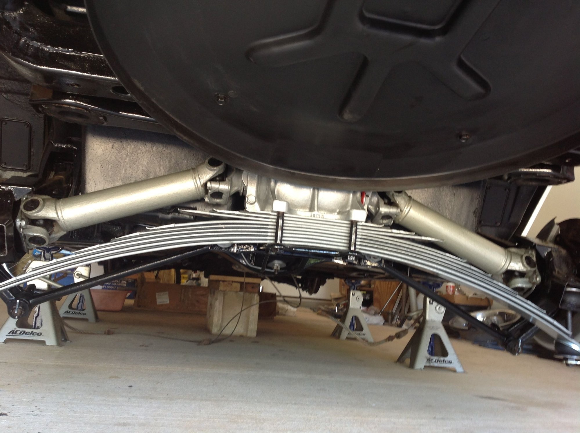

I used jackstands when I did the suspension- once it was on 4 wheels - made some stands out of 2 x 4s
DSCN4811 by Richard Hayes, on Flickr
DSCN4814 by Richard Hayes, on Flickr

I shamelessly plagiarized the lift-stacks designed by Richard454. I feel much safer being underneath my '70 big block with these lifts than any number of stands and jacks. There is no "wobble" movement what so ever. Thank you Richard, I owe you a cold long neck and plate full of brisket next time your in the hood.

NOPE- I can't take credit for it- just a messenger. I saw it on the web and just made a few modifications on it.
GLAD it worked for you!!!

There are 6 points to support a Corvette, the front of the frame, behind the front wheels, in front of the rear wheels. Our local corvette guru told me for a extended period of repair use the frame front and in front of the rear wheels as it supports the engine weight better. If you are leaving the wheels on I would use the wood block method, or buy cheap car ramps.

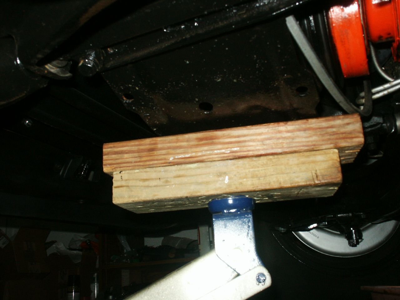

I used the front cross member, but you need to place a 2x4 or 2x6 to span
across the weak metal in the middle of the member
. I placed the jack
on the rear spring block on the rear.
Just remember that you can't place the jack where it puts pressure on the
center of the front cross member
Front:
Rear:
Donnie
