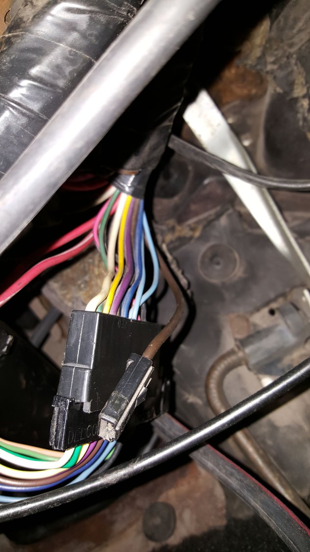

Was working on putting in a new tilt column today. Putting everything back I noted that there was a brown wire that was not connected. There is an end on it for a spade. It comes from the same harness as the harmonica connector does. I am not sure that it was connected before.

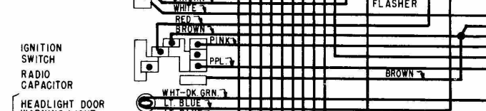

Looking at the wiring diagram, it could be for the radio capacitor? Don't know why this is not there on my car if this is true. Of course the PO did some strange things, so this is possible.
Anyone have thoughts?

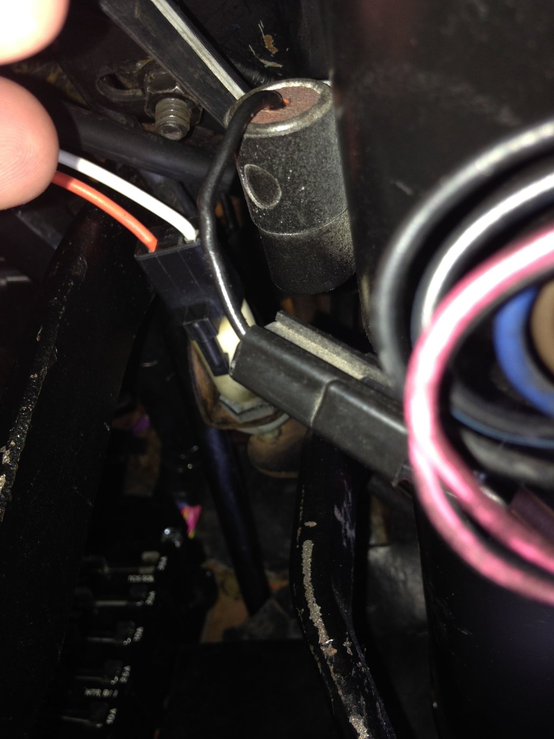

Yep, it's the radio capacitor on the steering column.

+1

Thank you for the replies. Not that I doubted you, but I can independently confirm that everything works after putting it all back (besides the missing capacitor for now).
