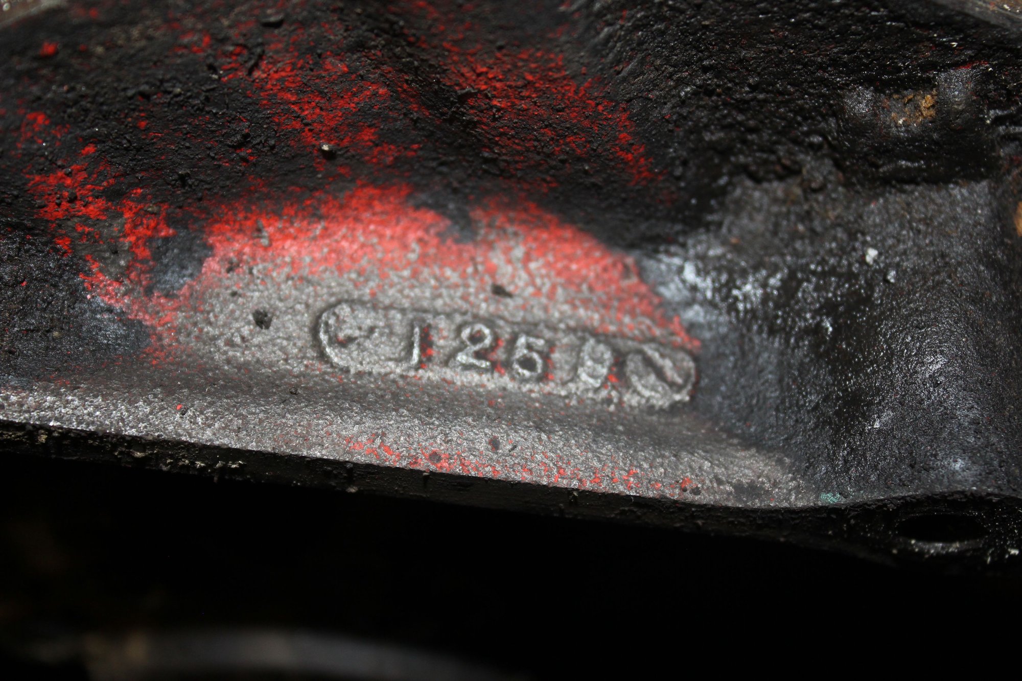

Hey everyone. I picked up a SB and cleaned it up a bit but can't figure out what the PAD stampings mean. I'm thinking the the 9B means February of 1969 but the casting is September of 1969. The broach marks look original so this is really throwing me off. This is presented as a 1969 CE 302
Any ideas?

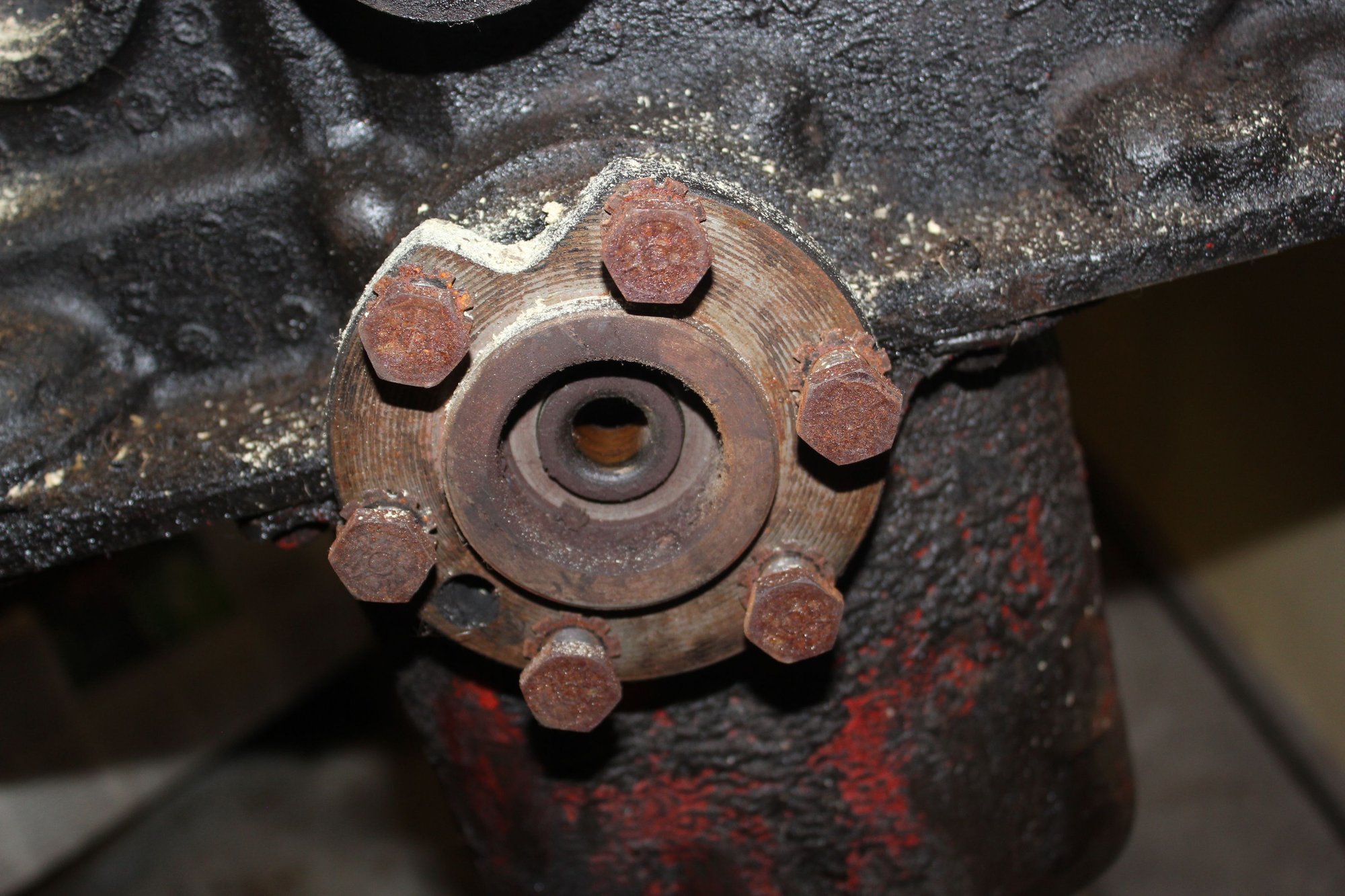

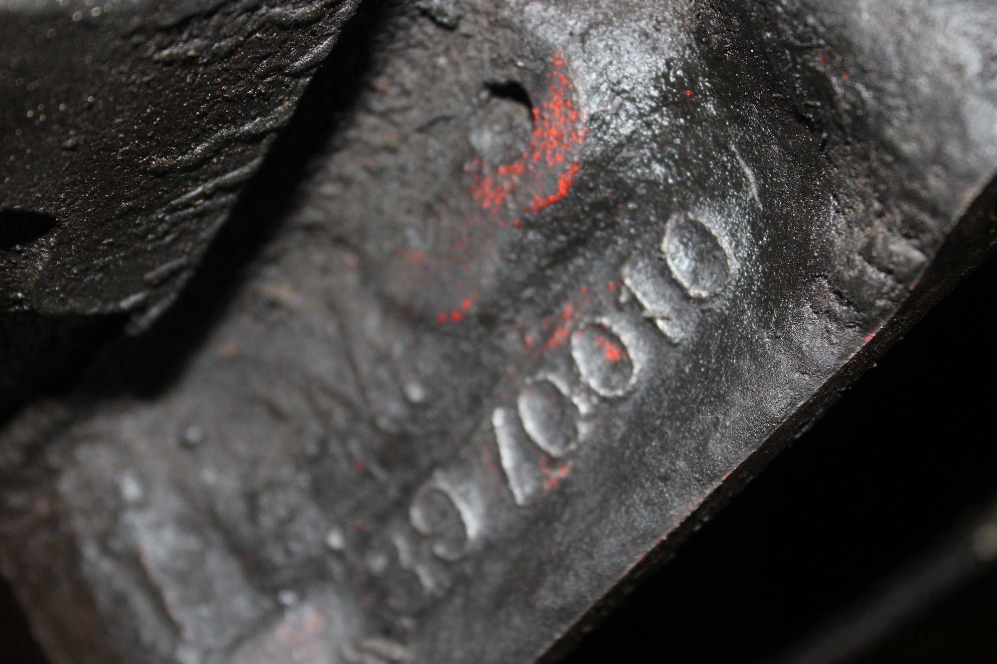

Here is the block cast date and crank flange that should indicate a 302 forging.

What is the casting number on the left rear of block?

The format that you have pictured is more typical of a factory replacement for the time period.

I was told this is a replacement motor that was removed from a 1969 Z28 Camaro. A posting in a Camaro forum says that the 0010 block was used for 350's only so that's another thing I'm questioning. All indications with pistons, crank, solid lifters, 4 bolt mains indicate this is a 302 but recoding it would be nice.

that is the correct casting number used for the 350 (69-79) and for the 302 in 69. One noticeable difference is rod length. As far as the stamped suffix code in the front, that is a common format for a factory replacement engine.

Thanks for your info. The pad is not as important as the internal hardware that all matches the 302.

correct, but without the "DZ" suffix code its more difficult to prove. I am sure there are way to decipher the CE code that you have. You are also on the right track by documenting all of the other date and shift codes on the block. Good luck.

more info.
http://chevellestuff.net/qd/engine_stamp_numbers.htm
There is another type of stamping found on some blocks. This is the "CE" code. You might see something like this "CE056789" on the front pad of the block deck on the passenger side. The "CE" stands for "Chevrolet Engine" but is sometimes referred to as "Counter Engine", "Counter Exchange" and "Crate Engine" was used on blocks that were warranty replacement engines. If a customer had problems with his original engine, while it was under warranty, it was replaced with an engine that was stamped "CE" with a 6-digit number following it which serialized that particular engine. It's important to note that the "CE" designation for replacement Chevrolet engines did not start until 1968 so any year designation in the engine number would be for 1968 and later. The CE block stamp year is the year the block was stamped and not for what year of car the block was destined for since a generic block for fitted engine could be used as a warranty replacement for any number of years' engines, applications, and for cars produced from any assembly plant.
It's been reported that beginning in 1970, if more engines were needed at a given plant in a year than the range of sequence numbers allotted, the plant would re-use the numbers using the letter "A" after the "CE" and year designation. For example, Tonawanda was assigned the sequence range of 50,000 to 79,999 so if more engines were required the numbering would start over again at 50,000 but the "CE" prefix would become "CExA" where 'x' is the year such as CE0A50000.
It is believed this method of identifying replacement engines stopped after the 1975 model year. This is supported by a notation in a 1976 dated Chevrolet parts book, "The engine plants are to stamp the serial pad of all current model service engines with the source, production date, and same type designation as stamped on a comparable production engine."
