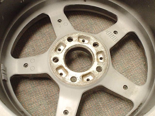

Bolt on wheel spacers/adapters would be the best option, but if you do not have room for the studs and lug nuts to fit in the mounting surface of the wheel then a 1/2" hub centric spacer and longer studs will be fine.
Wheel with space for adapters (notice the recesses in between the lug holes):
As a side note, I too think a large tire stuffed on a small wheel looks silly. It looks like it doesn't fit, because it doesn't...
