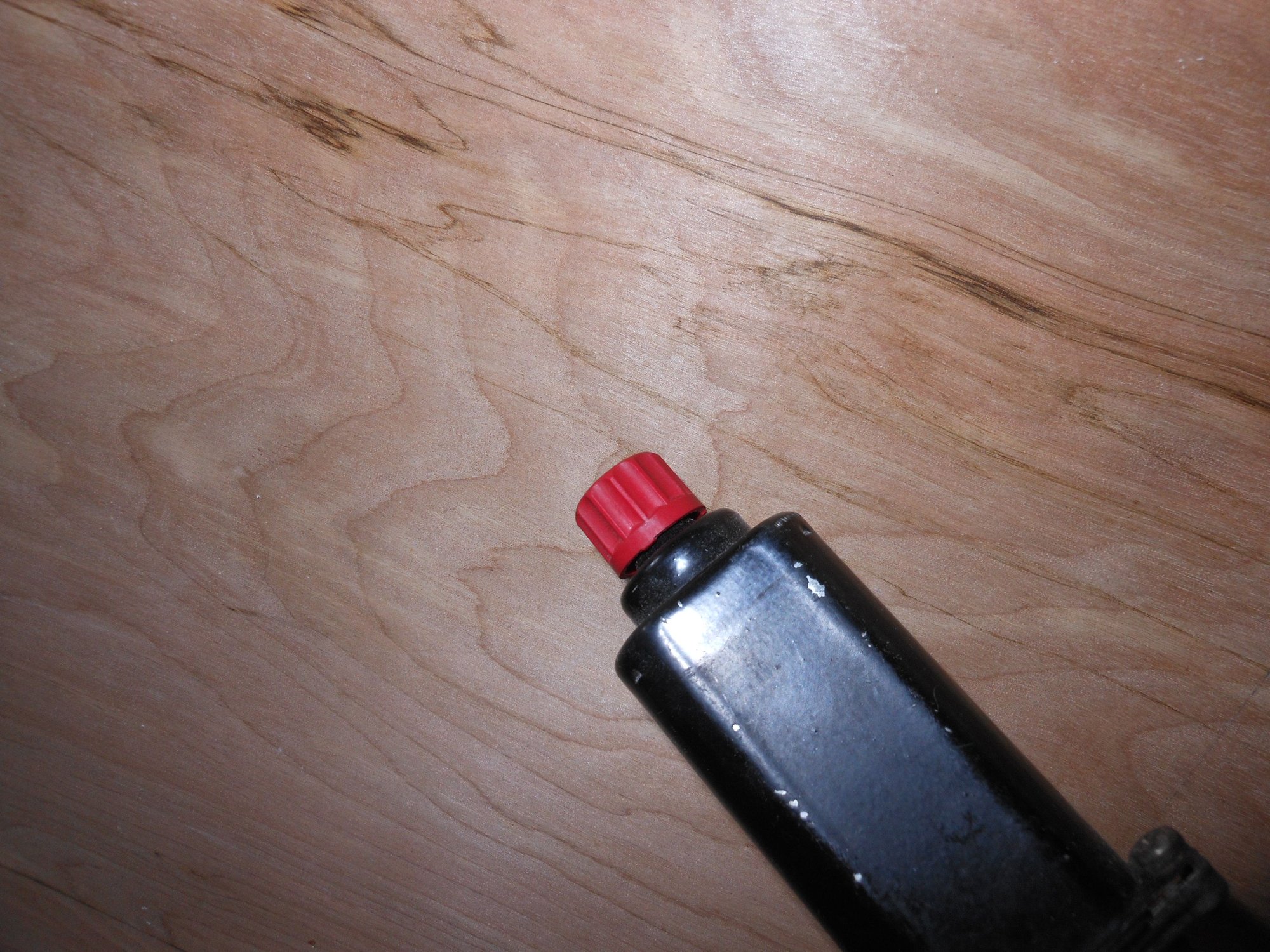

Here's how- $15 bucks on eBay....
So send me $100 and I'll ship you one...Seriously shoot me an email-if you have any questions richard454 at comcast dot net
I don't know how "He" does the wiring- and if he sold you older motors - they have a common ground between the electronics and the case- this won't work.
http://www.ebay.com/itm/New-for-12-5...pVwCZh&vxp=mtr
I used a PWM on my license plate/reverse lights-to slow the motor down-

The springs won't change a thing- there's been several conversations regarding what the springs actually do- and sort of came to a consensus that they are there for safety.
As far as what's in the picture- those look like newer motors- but the old ones are dimensionally the same....and the red cap is removed- as the old ones used white cap-to turn the motor in the event of a failure.
You can check continuity between the metal case and the ground wire- the motor that will work w/ the PWM will show open.
And the wiring- don't know what's in the box- as I wired mine up using standard DPST Bosch type relay w/ some diodes-which just controls the trigger wires....
Richard
