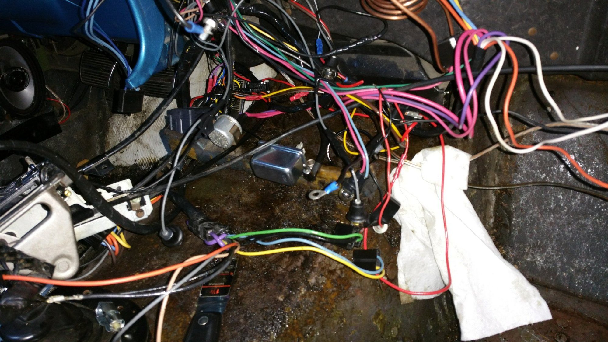

Well after taking the center dash apart, the gauge panel out, both side panels.
I can not find he flasher unit. Did find the wiper relay but nothing next to it.
In the pictures it looks like purple and violet wires?? Sure can tell Budda owned this car before.

Well that's it for tonight. Still haven't found the plug. Has to be there because I had signals just not great signals.
Found my '68 schematic. It shows the turn signal flasher where you all say it is. But doesn't show the four way flasher in the fuse box.
Very confusing

Maybe bubba put in the wrong fuse box. Pull the emergency flasher and see what it is. Hard to know what previous owners do

Well you were all right. Bubba moved the signal flasher to the passenger side by the side vent. Took awhile tracing the purple wire but all worked out great.
THANKS to all and thanks for the great picture. It all helped
