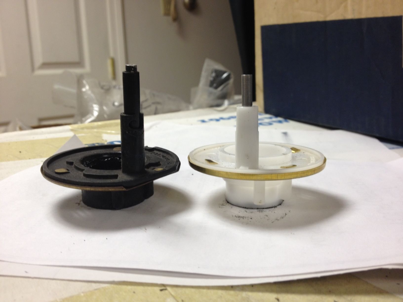

I found the problem. The canceling cam that everyone sells as the one for 68 non-telescopic isn't right. See the attached picture. Also see http://www.parts123.com/corvettecent...50g&ukey=14959
So, did the 68L have something unique and there is no aftermarket replacement for it? The black one I have has a 1" long aluminum rod, a spring, and a 1" long plastic sleeve that goes over everything, and interlocks with the back side of the cam. Curious.

Whoops, here's the picture.
