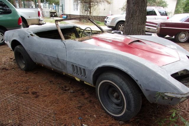

Hello!
My name is Brian and this is my first post to the forum after reading for a long time. I wanted a chrome bumpered C3 since I was 17 and just after turning 40 my wife finally let me put a little cash down on a serious project car!
I wish I could have bought a car in better condition but I had to start somewhere. In my garage sits a 1968 Convertible. I have a great frame with a birdcage with zero rust and a very good body with a clean title. I do have the suspension and differential...basically a rolling chassis. I have assorted other pieces but that is about it To start my project I replaced the gas tank, and sanded and painted the frame and engine bay.
My questions start here: I found a 1984 coupe for basically nothing and picked it up for parts. It has the stock engine (which has been stroked to a 383) and the infamous 4+3 transmission (It just has to be a manual for me). I know I will use the engine and trans but I am thinking of what else I can take from this donor car. I am missing one c3 brake caliper so I am thinking about taking the C4 brake calipers and rotors and maybe the seats. Would any other parts be useful to grab off the 1984?
I also would appreciate any advise for getting this car on the road. My goal at this point is to get it driving before too many years pass so I would love to learn from experience and consider any suggestions to make this an easier path!
I know I have tacked a major project here. I am decently comfortable with my hands and I have my wife's inlaws next door (he has been rebuilding cars longer than I have been alive and he as a lift...which is nice) so I am cautiously optimistic. Even if this turns into a nightmare I will see it though.
This is my dream car.
Thank you for your time

Pics as requested:

What state are you in?
Do you have the door handles and chrome bumpers. The door opening mechanism is unque to 68s and some parts are hard to come by. Do you have the convertible framework? Any interior? You might want to find a rotten 68 or 69 and strip it for the interior, wiper door assembly, etc...... make a list of everything thats missing and start a price list. A donor care might be cheaper. $2000-$3000 for a donor. Minimum of that for the interior alone if you try to find newer parts or original 68
Theres some used parts venders here that can help with the missing parts and trim as well. I would start with them.

Originally Posted by Brian Mathews
Pics as requested:
Welcome......and thanks for being willing to save a '68 from the parts bin!
Edit: Advice? Rebuild ONE area at a time so you don't get overwhelmed!
Contact George
https://www.corvetteforum.com/forums...un-merged.html
Sorry for the delay in answering as I was out of town all weekend. I am location in Georiga. I do have the outer door push button with key , and the door grab, but I missing all the door interior trim pieces including door opener.
Here is a list of the main parts I DO have outside of the rolling chassis:
Convertible frame
Lower left and right dash
Speedo and center gauge clusters with all gauges
Radiator and shroud
Headlight assemblies
Front and Rear chrome
Wiring harness
A pair of rotten seat frames
heater controls and trim
Door panels (no trim)
Windshield trim (outer and inner)
Everything else is miscellaneous pieces and lots of small parts I haven't identified yet!

Thats good. Atleast you have a majority of the big expensive stuff. Call george, he probably has the door panels and inner handles. The inside mechanism can be bought new. I had to as mine was broken. Regular.parts vendor and it works fine. I took apart my door lock assemblies and had them rekeyed to match my ignition. That made me happy
