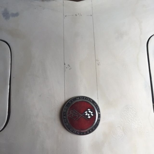

Here are the measurements from my 73. Hope this helps. Placed the rule at the very end of the nose opening along the center ridge at the top. And from the tip of the bottom nose area to the emblem also along the center ridge. Regards,
Jim

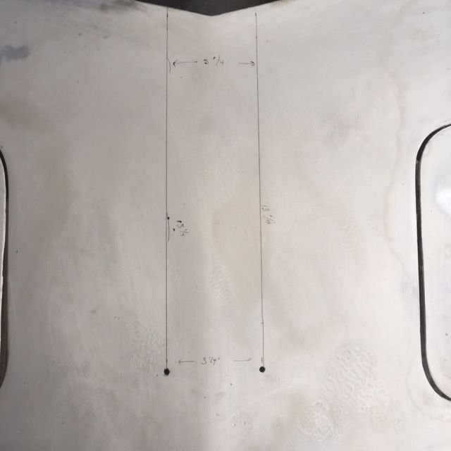

badge studs are 3 1/4 " on center all measurements are from center of hole's
Both side are 13 1/4" down from top Hood opening see pictures
