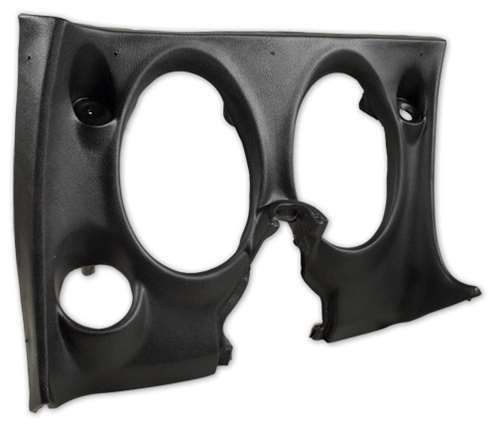

Okay so many cool things were 68 only, not in a purist way but just in a will it fit way,
The 68 left dash,
If I remove the 69 dash will this bolt right in,
I understand the obvious like the ignition is in different location, just curious will they interchange fit-wise?
Thanks,

Yep-
This one when into a 77...and that just happens to be a BMW Push/start-button!!!

All 68-77 left and right side lower dash panels, are basically the same. As you know, the 68 has the ignition switch in the dash, and there is a slight difference in the lower inner corners, where the dash meets the console on some of the later ones. Also, 74-77 left hand panels for air conditioned cars, have a small rectangular vent to the right of the column, that's not there on 68-73 dashes, or 74-77 non air ones.
I'm not 100% sure, but there could be a very slight difference in the 68's, where the steering column meets the dash. 68's use a completely different column, with a multi piece column cover on it, which may have required the dash to be slightly different, where the column meets the column?

The diameter opening is smaller on the 68 than the 69 for the steering column.
