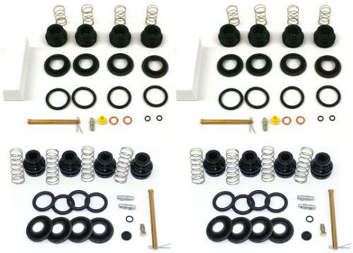

Anyone know who has the best deal on for the complete caliper rebuilt kit for the 75'? I have the stainless steel sleeve calipers and I want to separate them, replace all the seals as well as pistons.
I want to stay with the lip seals and what I'm finding online is more of the "o ring" conversions.

This is the complete o ring kit, but I'm looking for the lip seal kit.
BrcmpblThanks for the reply, but that's not the complete kit, it doesn't include the pistons and seals between the caliper halves.
Andy TuttleNot the complete kit, I consider that a seal kit, but thanks for the reply. Also thanks for the mention of your rebuilt thread, I'll take a look.

Brcmpbl Thanks again for the reply. I know you can purchase the guide pins, seals, pistons, clips etc separately but it ends up being a higher price. I was hoping to get a complete kit as shown in the imagine.
I did manage to find one kit but I've never heard of the vendor before, I was hoping members on this forum could share there experience, but maybe everyone's converting to the seal kits.
