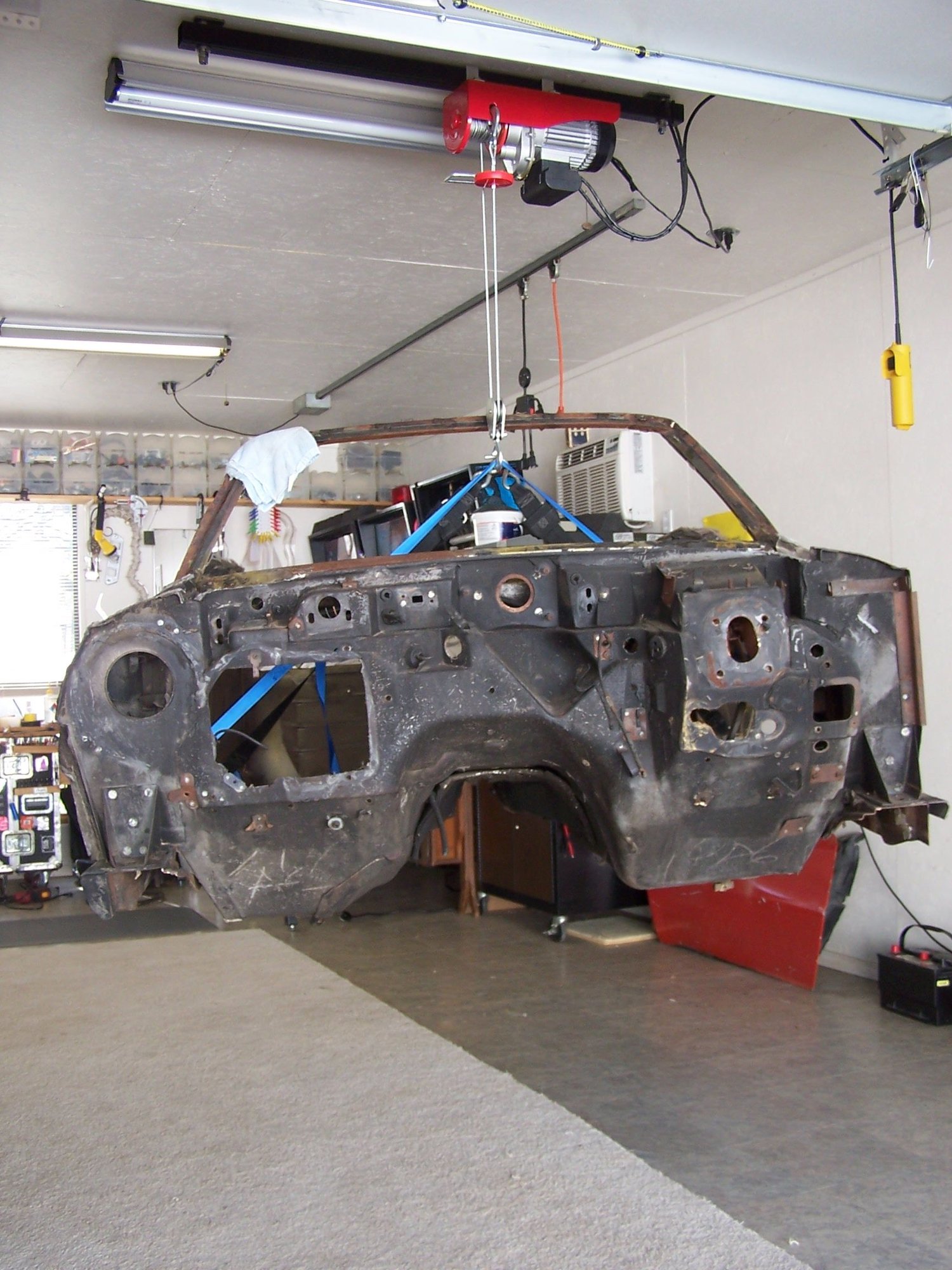

here is picture of 69 with factory A/C. for your reference.
difficult task with motor in place.
make a list of the parts you will need, including new heater controls.

Originally Posted by 69Vett
Nice pic. Note the AC chalk mark on the toe kick letting the worker know this one was to be cut for factory air.
...make a list of the parts you will need, including new heater controls...
The AIM has the parts list and the original GM part numbers.
