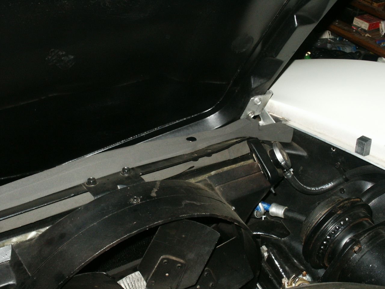

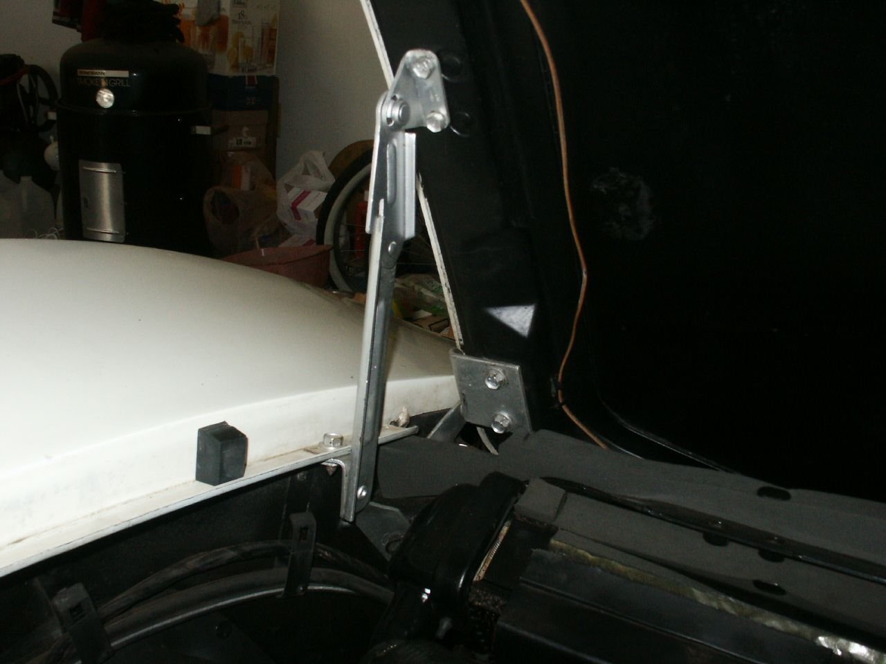

This is where the front one is on my 73. As stated above, you just
place them where they are needed.
Donnie

Tooch1,
I don't remember if they were on there originally or not. It's been too long a time.
(as it sat for 20 years)
I just needed them to correct the hood after I finished restoration.
My hood was below the fenders and the blocks corrected it perfectly.
Donnie
