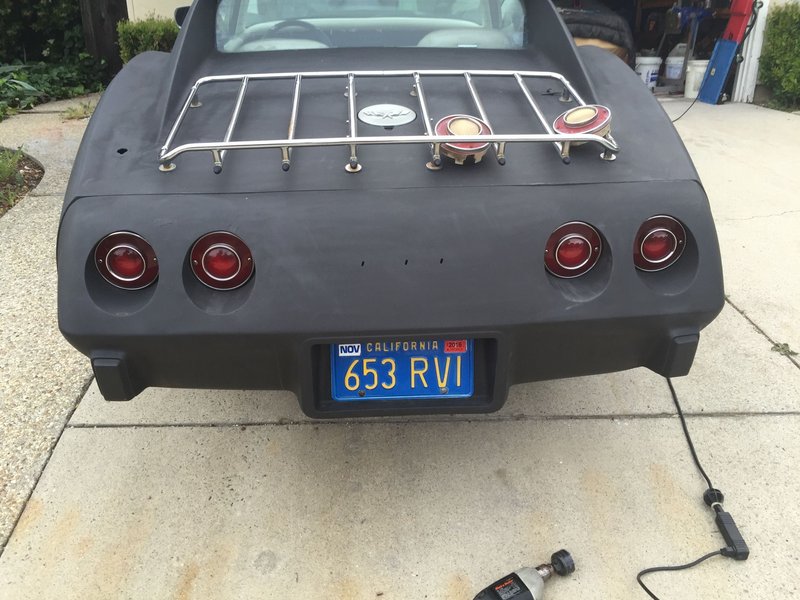

I have a 1978 Pace Car. I would like to replace the rear inner tail light back up lenses with two outer tail light lenses to match the present outer tail light lenses on the car, giving me four tail lights. How difficult is this to do? I realize I will have to replace the light bulbs with 1157's and change the bulb sockets out. Is it then just a matter of splicing in the three wires to the three wires going to the outer tail lights? I'm not an electrical engineer so any help would be appreciated. Thanks.

Pretty much. The bubble tail light conversion kits do the same thing. My advice would be not to cut your existing back up light pig tails. Tape them to the existing harness out of the way. This gives you the option of returning to stock in the future.

I had to cut a bigger hole in the fiberglass tail light reinforcement so the back of the lenses could go through it, then I spliced in the new sockets and zip tied the reverse lights to something so they didn't hang down.
Do both right tail light lenses now flash when the right turn signal is activated and same for the left?
Old Oct 7, 2016 | 04:11 PM
rgwoehr's Avatar
rgwoehr
Joined: Aug 2015
Posts: 876
Likes: 694
From: Columbus, IN
Yeah they do

That's exactly how we did it before.. we taped the old b/u lamp connectors to the loom, then jumper spliced from the right lamp to the new lamp and then the left lamp to the new left lamp.. Both will flash and show stop when completed.. It's pretty easy to do as long as you get the correct tail lamp connectors. If you don't have them, I probably have some good used ones in the shop and if I don't I'm sure I can get you new.
