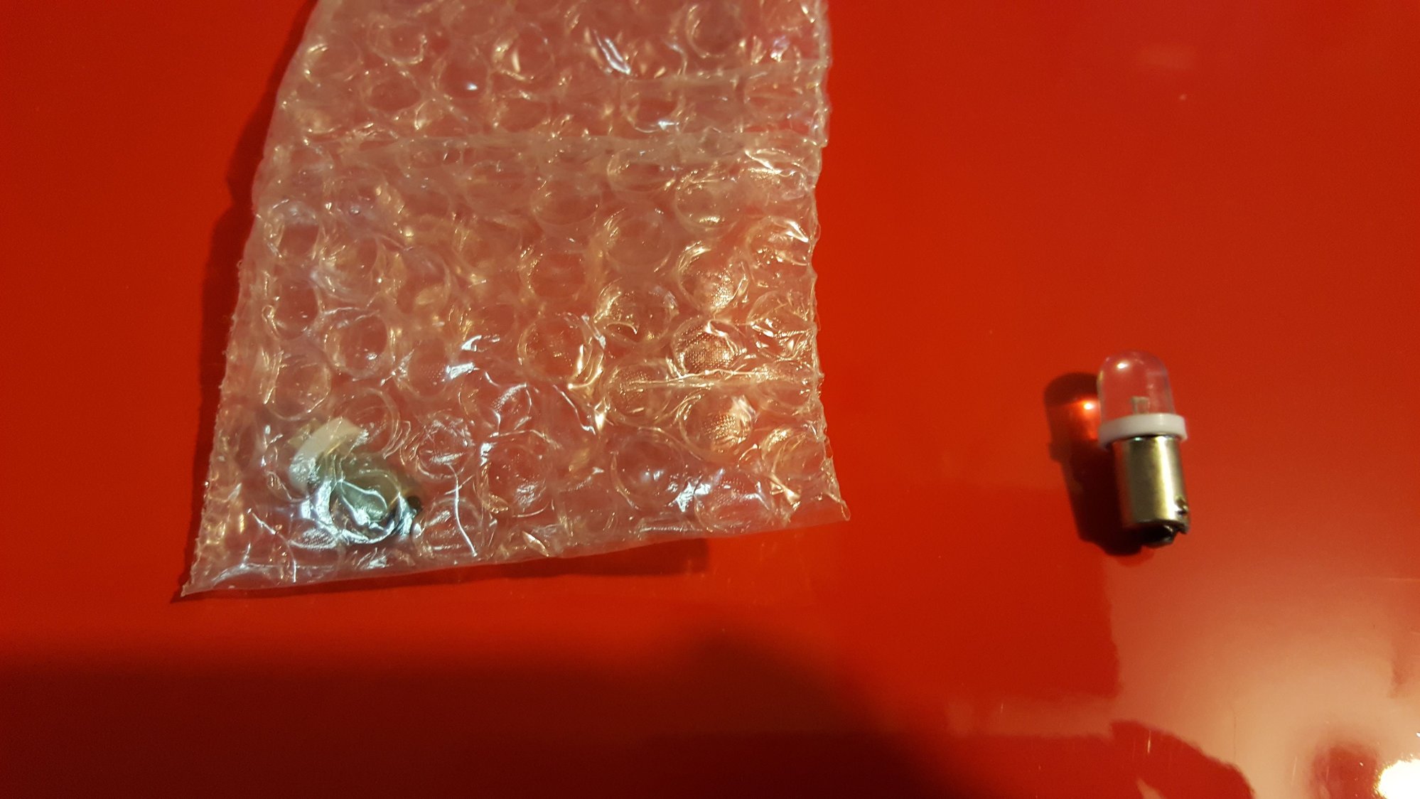

i bought some from superbright led . com
https://www.superbrightleds.com/more...ofit-car/2077/
Perfect replacement for the stock bulbs and the greenish hue they put out. The cool white is brighter but a smooth white with no green like stock. 100 times better that the factory bulbs. Well worth the aggravation of installing them.

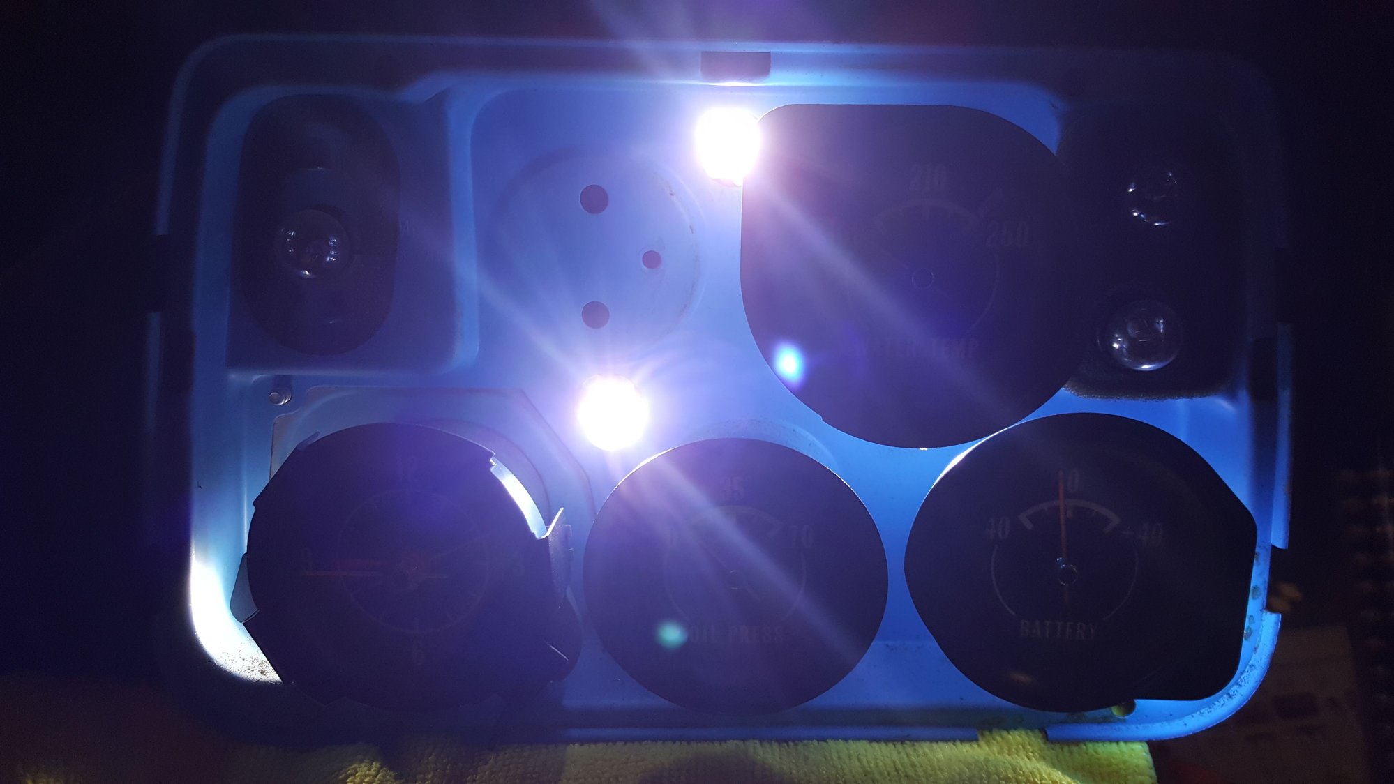

Quick update - I went with the LED bulbs. See attached pictures.

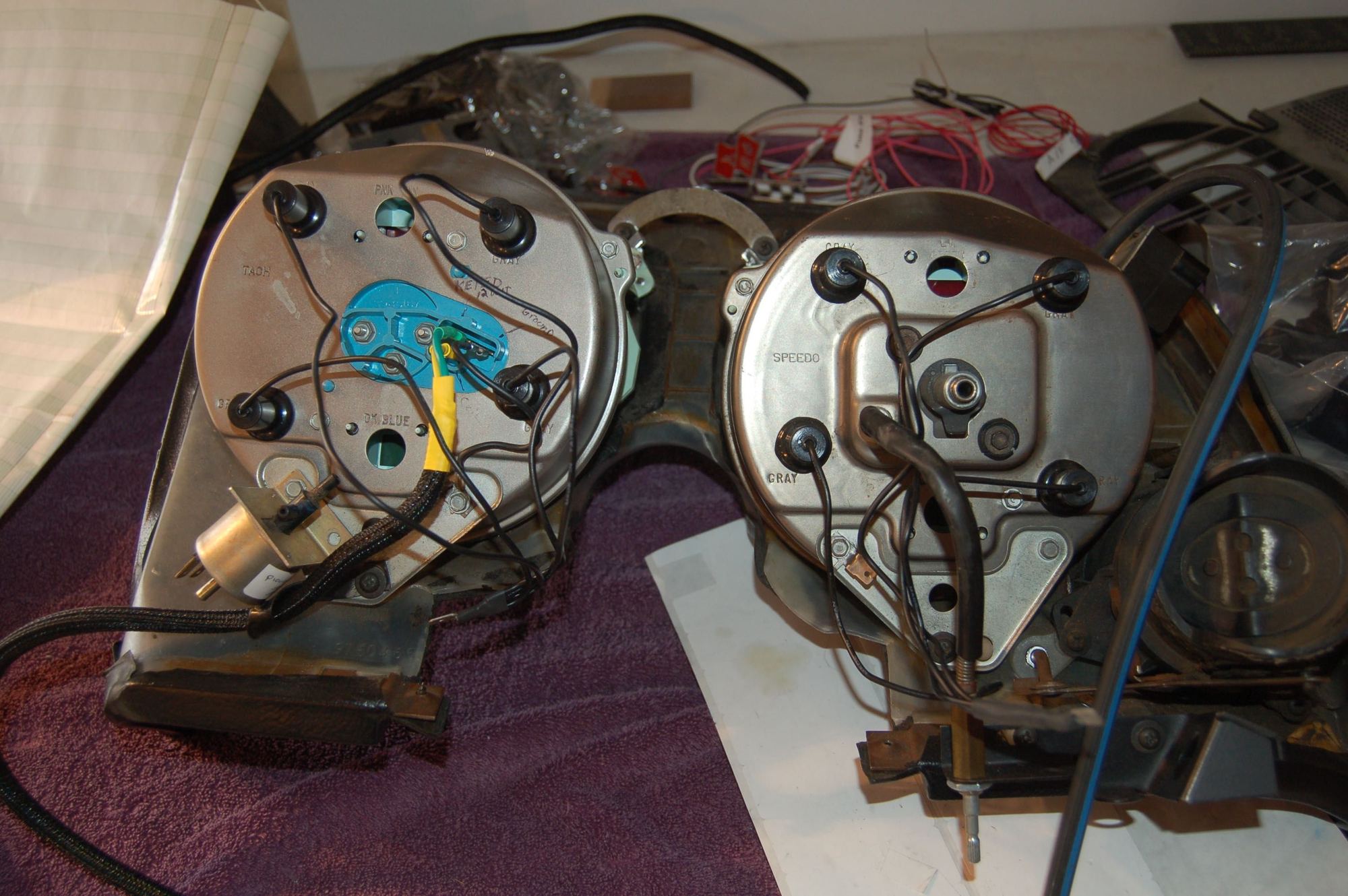

Just FYI there was another post on more or less the same lines just the other day and here's what I contributed.
Replaced all my cluster/speedo/tach bulb sockets with this guy
https://www.summitracing.com/parts/pco-5443pt
I also replaced all the incandescents with LED's and tied the source wires all together . Lower current draw. Finally I put a connector on them so I could hook them together with a source in the harness after installing the instruments. Any source would do. That way I could have all the bulbs in place when reinstalling the cluster.
Incidentally, my original sockets kept falling apart. Had lots of bulbs at the bottom of the assembly.
