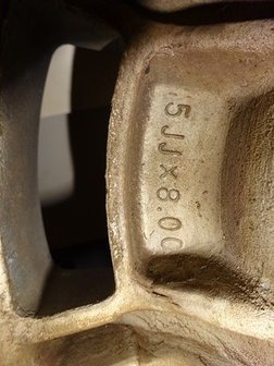

My understanding is that the 255/60-15 tire size was offered starting in the 1978 model year, either as an option or standard equipment. Can someone tell me if the wheel size changed, backspace or offset? Or was it the same wheel used on pre-'78 cars?

The standard wheel used on all 69-82 Corvettes, was the 15x8 AZ coded rally wheel. The aluminum wheel became an option in 1976, and it too was a 15x8. The back spacing is also the same on both wheels.
The P255/60R15 tire became an option in 1978, and was available with either the standard steel rally wheels, or the optional aluminum wheels.

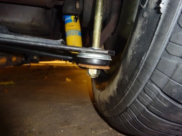

Thanks all. I ask because I just installed a 255/60 on my spare wheel and tried it on the front and back (of my '77) to test for clearance. I didn't notice any issue with fender clearance. The only tight area I noted in the front was at the tire to frame with the wheel fully cut, could about fit a fingertip between, and in the rear I could again get about a finger tip between the spring and the tire. I'm thinking the tire change is a go next season.
